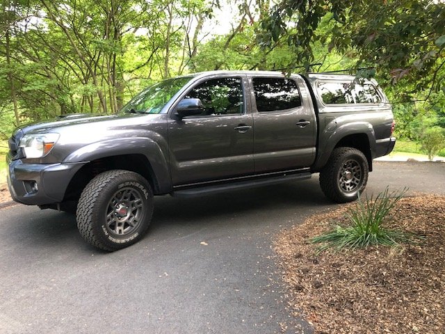

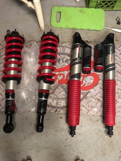

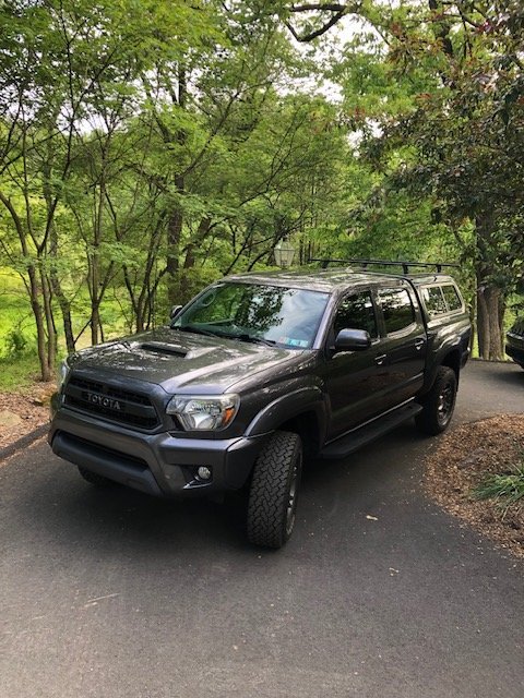

    A week in on the pro Fox set up and I'm loving everything about the new way the truck rides. I got a brand new OEM leaf pack for cheap off of a member 2 years ago and put in an AAL when I installed it due to having a Leer shell on about half the year. Sitting fairly level, but I'll be taking the shell off next week after a camping trip so we'll see if that changes at all. Not expecting much difference.
