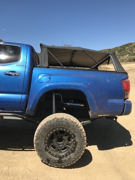

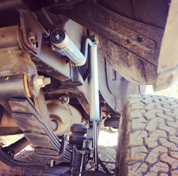

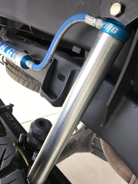

    I went with kings for these reasons.
    - they document and list every part of their shock so it's easy to find parts. Since most shops sell kings it's easy to go in and get something ordered
    -revalvable
    -different droop applications for different shock bodies.
    -matches my truck
    Example.
    I'm running king 2.5 resis in front with tc uca
    But in the rear I did 2.0 smoothie shocks because they give me 12 inches of droop. (Dakars, shackle flip and bamf shock relocation)
    Im sure fox and icons have similar customizable options but
    Heard about icons leaking (sure they're fixed now)
    And I just like saying "king" over fox lol
    So my only advice since I'm a relative newb myself is build for the future. These Tacoma's are expensive and I've already gone through 2 suspensions and 2-3 different bed racks because the direction of my truck keeps changing. #brokelife
