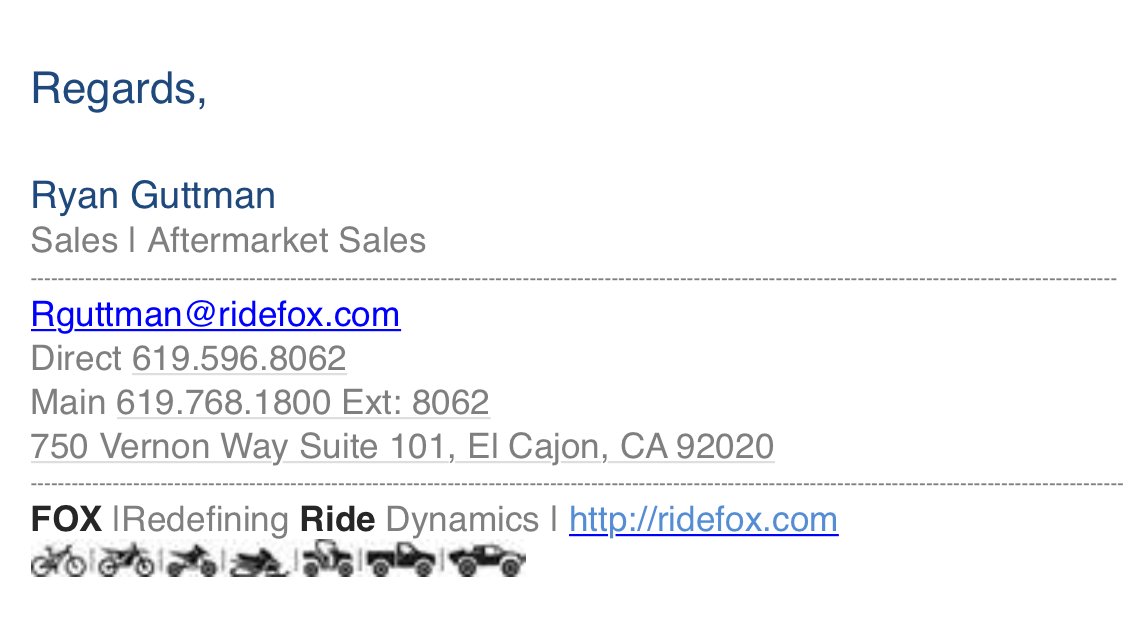

    This is from my email discussion with FOX:
    Me: DSC only makes shocks stiffer, not possible to adjust (dials) softer than without DSC?

    We
    This is from Fox? Or from someone who is in “aftermarket “ sales somewhere?
    Because I just got off the phone with a rep who sales fox and read this to him and he just laughed.
    I’m confused .

  10. Jan 7, 2018 at 7:46 AM
