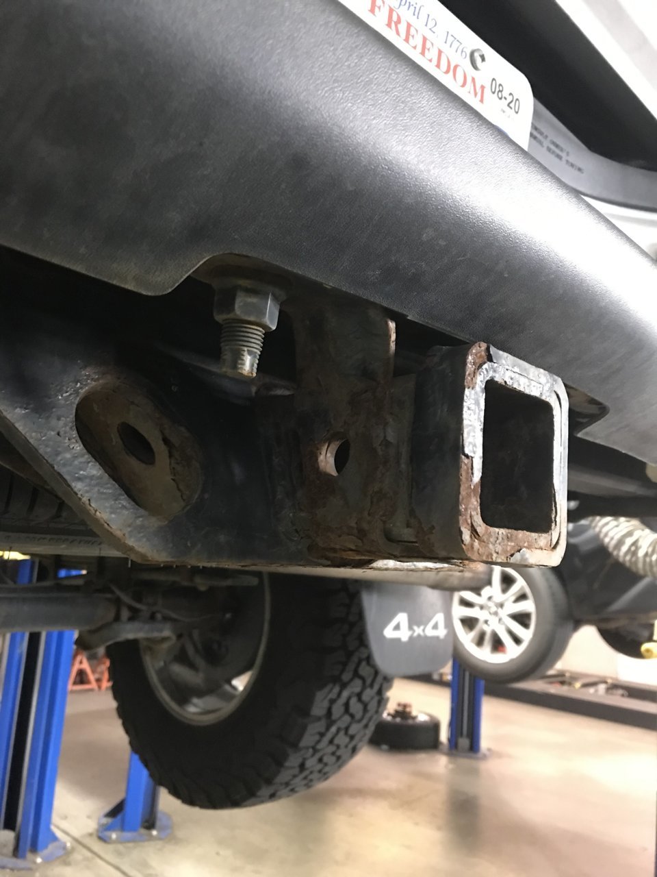

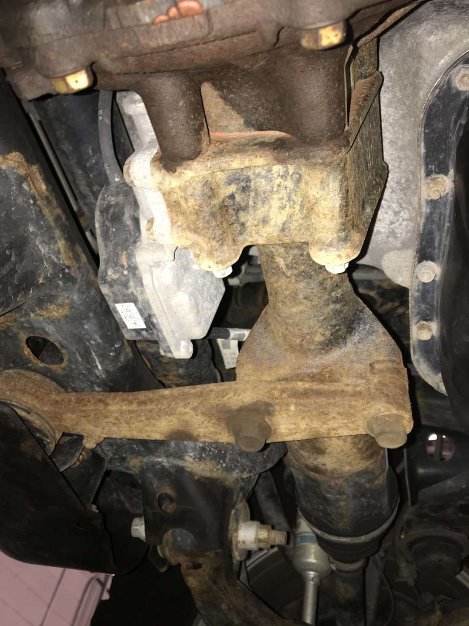

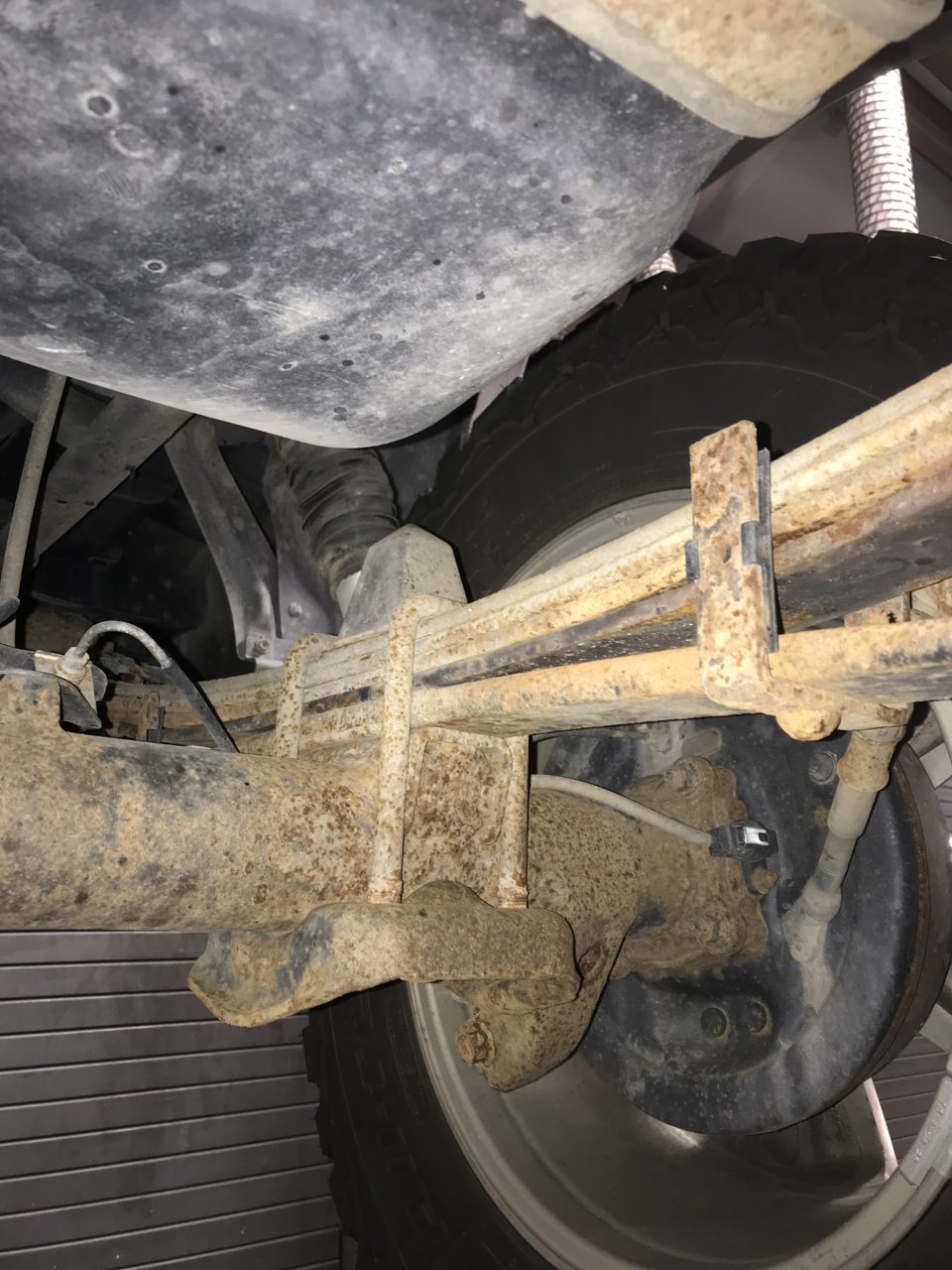

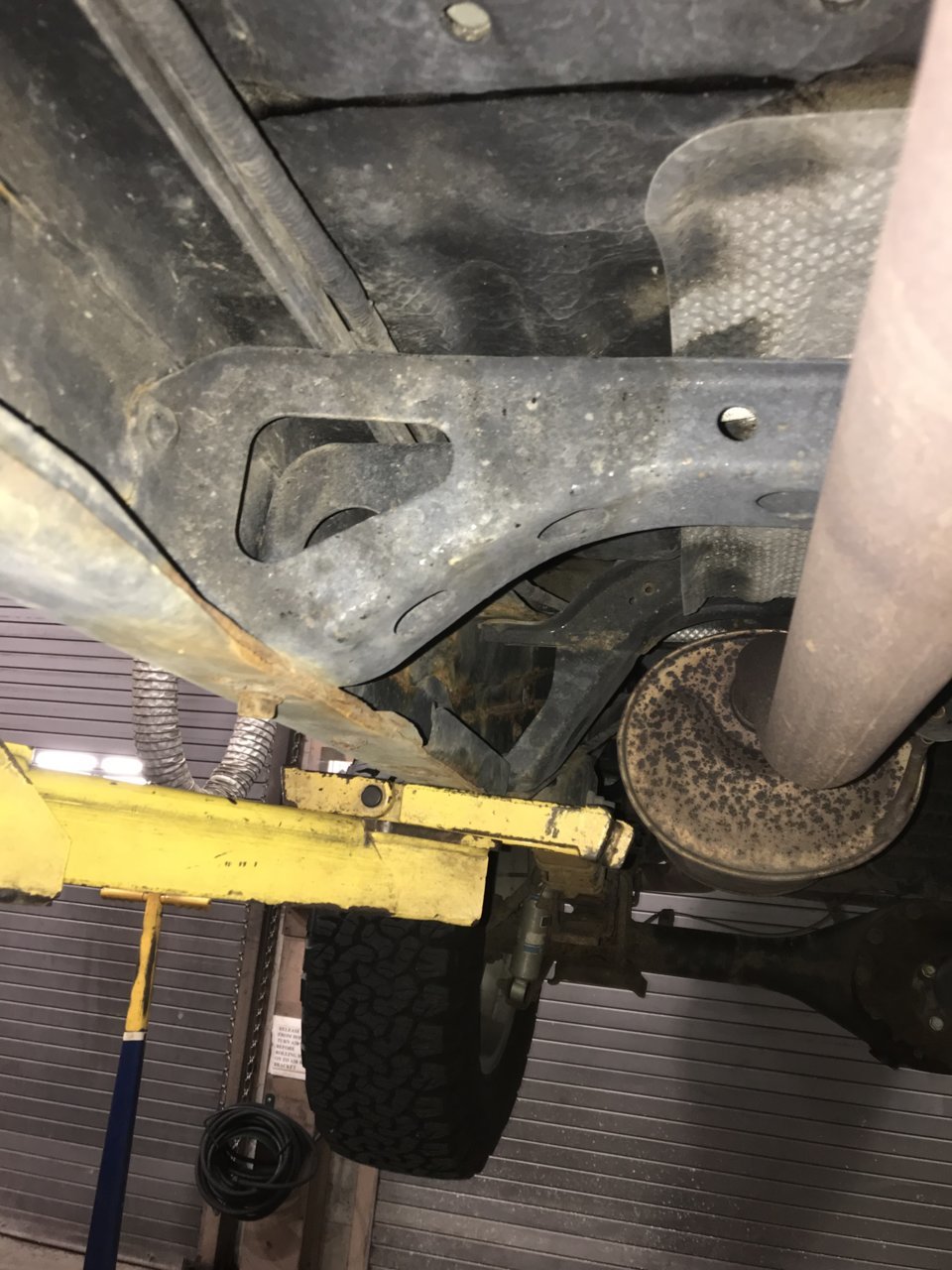

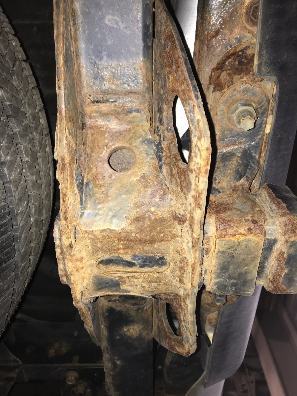

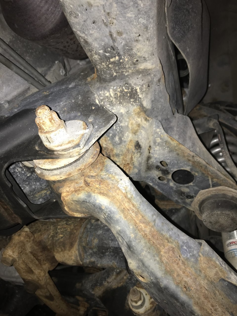

    Hi All,
    I'd like to get some other opinions on the condition of my 2013 4-door (62K miles, currently in North Carolina inland, rust was from when taco was owned in PA). There is a significant amount of rust on most of the bolts, and it was incredibly hard to replace my suspension. This got me thinking about possible issues down the road related to rust, and what I could do about it.
    There are no holes in the frame, however the rust has me worried that I won't be able to keep this another 100K miles without some sort of treatment/removal. I'd really appreciate your guys' input on the pictures below.
    IMG_0857.jpg IMG_0851.jpg IMG_0855.jpg IMG_0848.jpg IMG_0854.jpg IMG_0858.jpg

    It doesn’t look that bad. If you’re worried you could use a wire brush on the rust spots then hit it with POR or rattle can black. Afterwards fluid film everything, that’s about the best you could do.

    My dads 08 looked about that bad when he brought it down to NC from upstate VA/NY before then back in 2016. Got a new frame this year. When the metal layers in the frame start to warp/come apart you know its getting bad. All I did was tap on one of the crossmember welds and it the hammer just fell through the frame. Didnt look horrible either, guess its all on the inside.
    Clean it up, and get it coated by your dealer so it can be eligible for replacement someday.
