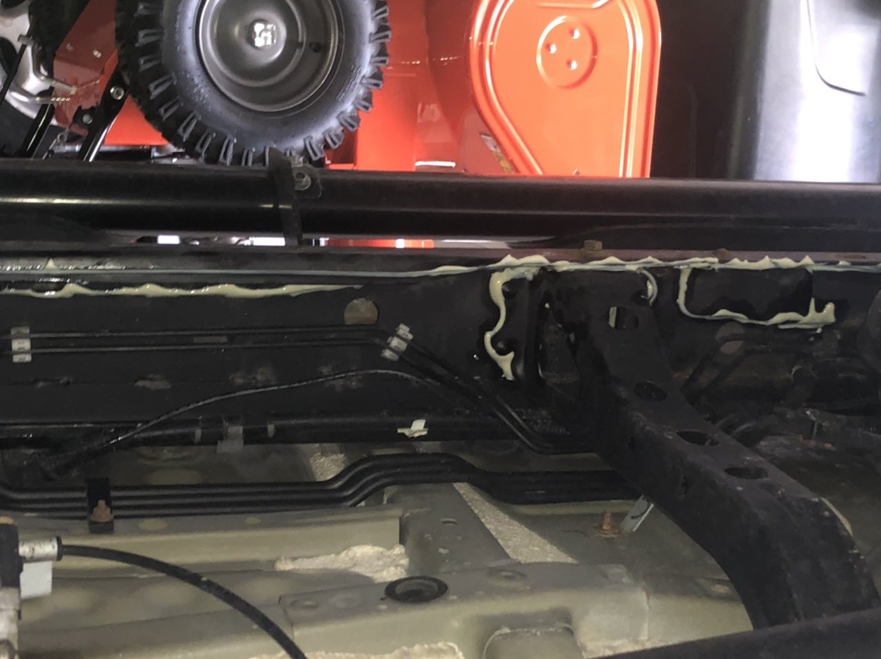

    Got my truck back today from the CRC Frame recall. They injected what looks like thick snot into the box part of the front of the frame after cleaning and drying it for several hours. There are also parts of the open channel midway down the frame that show the same snot where the welds come together. They do nothing the the rust on the welds and nothing is applied to the outside of the frame at all. Sorry not sure why the pic is upside down?!

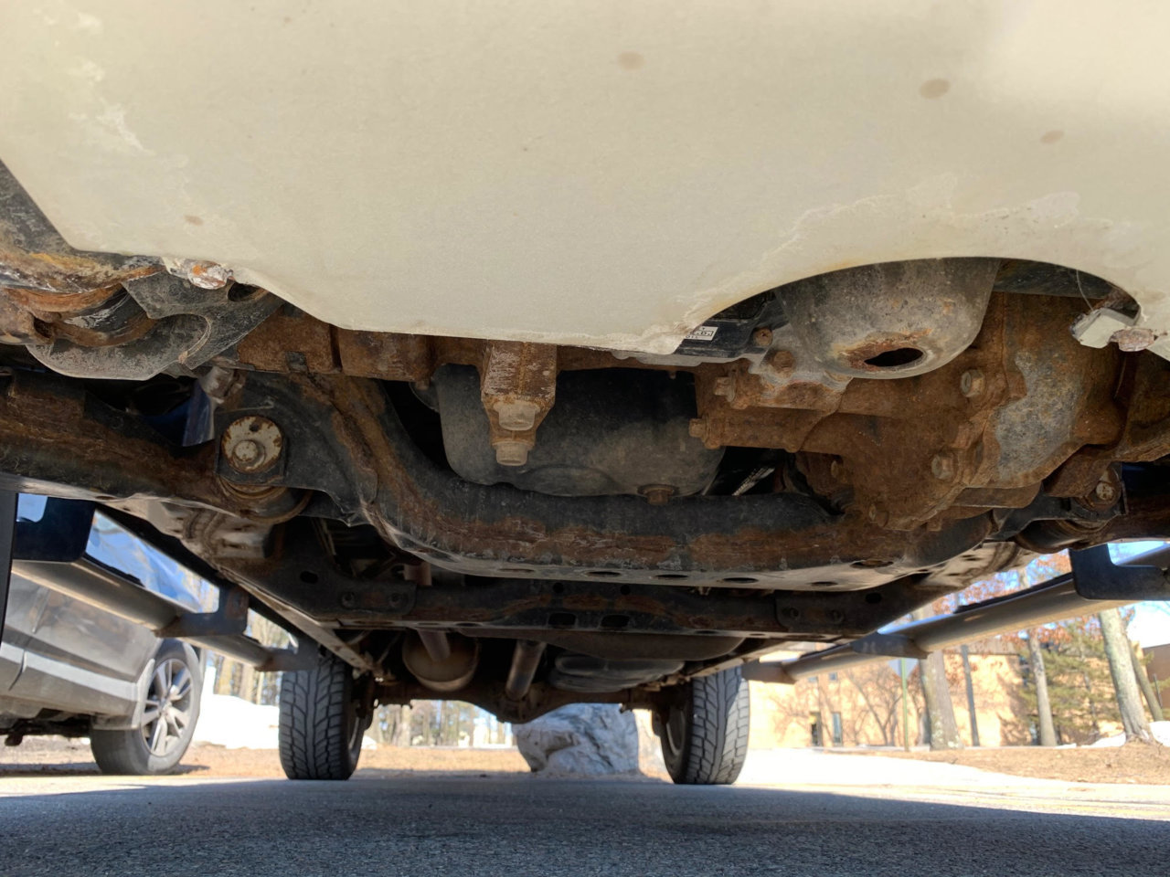

    I was looking at this truck it is a 2013 with 75000 miles. For what it cost this scares me a little . W hat do you guys think. 2013tacoframe.jpg

    Damn. Mine's a 2013, NOTHING like that. Just had the CRC done. Where is this truck? Given that everything under there is rusty...not just the frame, which we know is prone to it, makes me think the PO never washed it! so what else didn't they do?

    Northern VT It is a Limited but doesn't look much better than my 2002 Frontier underneath

    It depends how handy you are and how much time and effort you are willing to put into it.I would need more pictures of the rest of the frame.The lone picture shows surface rust. I would wire wheel off the rust, hand brushes for those hard to reach areas.I would buy Ospho rust neutralizer apply Eastwood primer apply Eastwood black Chassis paint and then Amsoil heavy duty metal protector. Eastwood makes a product to apply inside the frame to clean out the accumulated debris and rust then you can apply Eastwood internal frame protector. This is my frame maintenance program which I'm happy with every year that goes buy I'm doing less touch up. My .02 Rust Never Sleeps Neil Young use that rust to get a discount. FYI I have no affiliation with Eastwood nor Amsoil I just like their products.G.L. in your search.
