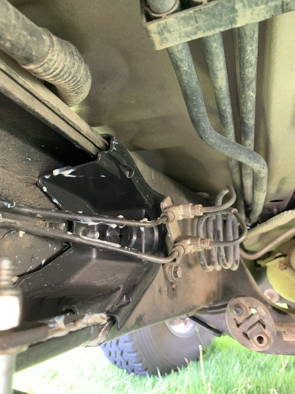

    I took my bolt on sliders off before bringing the truck in. They needed to be refinished anyways. However before I did so I asked the service writer and he asked the Toyota tech. He said it wasn’t necessary to take them off but the coating would cover more area if I did.
    Turns out they cap the boxed section at the front and my sliders bolted into that area so I’m glad I took them off.
    Weld ons shouldn’t interfere with the coating at all, but you know how dealers are. Every one has a different approach.

    I have Apex sliders. I was going to do the same. Is the cap removable? will it interfere with re-installation of your sliders? Could you share some pictures of the cap and the job they did?

  14. May 7, 2020 at 2:21 PM
    #234
    Sharpish
    Sharpish Well-Known Member
    Jan 4, 2016
    #173981
    3,832
    Brian
    Victoria, British Columbia, Canada
    2012 Tacoma TRD OR 4x4
    My sliders are Cali raised. They use a “paddle” with snap in nuts that you insert into the boxed section of the frame, then thread 2 bolts per side through the slider and frame into the paddle. The cap that you see in the picture definately interferes with inserting the paddle. The holes in the frame that are used for inserting bolts are plugged as well. Two per side.
    I chose to leave the cap in place. I upgraded all the slider hardware and I’m confident it’s strong enough. In the future I might drill through the plug and the inner part of the boxed section and slide a long bolt through. For now the sliders are there for the occasional “Oooops. Ah fuck” vs constant crawling and scraping. So I think they are strong enough for now.

    Looks like the cap i just bolted in and could be remove a put back after.
    Whats the point of the cap? To minimize dirt in the frame that would hold moisture anf cause rot?

    Keeps water and salt out and the CRC goo in?
    You could remove it if need be for the slider install. Or modify it to accommodate the slider. Depends on how your slider bolts up.

    I wanna know what this slime looks like in 5k, 30k miles. That cap thing looks like it will do the opposite of keeping things out, but in.

    They also install a cap inboard of the cab mounts, internal to the frame (inside that huge 2" hole) and a few in the oval holes in the wheel wells (forward of the cab mounts). Also, a few other holes get plugged.
    I can post pics later if it helps.
