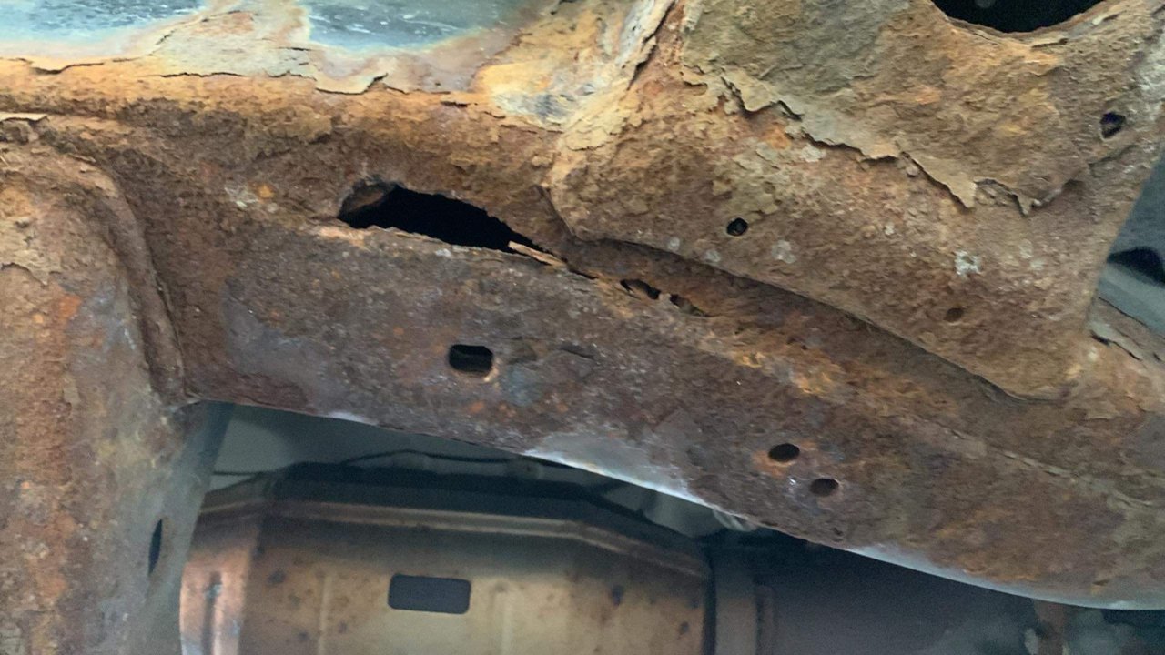

    Hey all, While greasing the U-joints today I found a pretty large rust hole in the frame near the front cab mount. In your opinions would that qualify for the new frame or rather just a patch? The KZA recall was done by the previous owner but the K0D recall is scheduled for next week. IMG-2082.jpg

    That likely will be getting a new frame. If K0D is still open. Be sure to show them the spot.

    Our opinion(s) don't really count. Only your Toyota dealer can tell you if you qualify for a new frame. That said, the hole in your picture looks more than big enough to qualify if you meet the other criteria.

    Well the frame had the KZA recall done 4 to 5 years back. So with the K0D open and not done I'm hoping they won't try to screw me around. Definitely will let everyone know the results.
    I know they have the follow certain criteria when following the KZA recall so with that being over 10cm what other reasons could a dealer say no ?

    If you have that hole it’s almost a sure a thing you’ve got more holes

    If i had more time I'd like to inspect more, maybe a tomorrow project. I don't foresee a issue getting the frame done and hopefully some other listed parts that Toyota will cover
