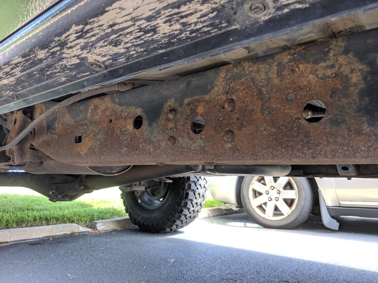

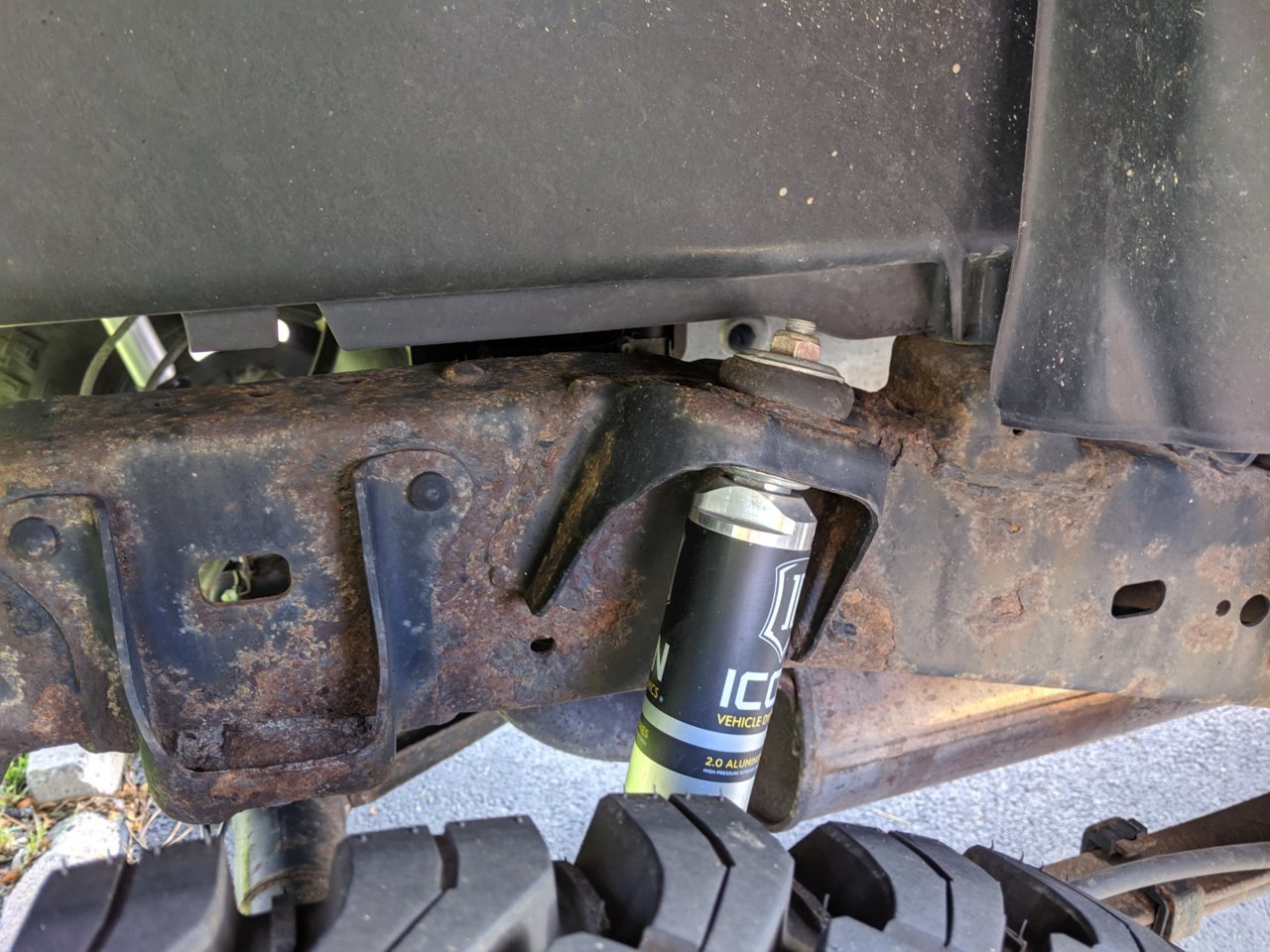

  8. Sep 26, 2019 at 7:52 AM
    #168
    Bmayes91
    Bmayes91 Member
    Jun 14, 2019
    #296313
    8
    Brendon
    2011 Black SR5
    Icon stage 1. Total Chaos UCAs. Falken Wildpeak 285
    Had the dealer take a look at mine last weekend and they advised that it needs to form a hole or be compromised in some way, but my VIN is covered so they'll replace it entirely if it goes bad by 7/2023. I then called Toyota US and spoke to someone about the class action lawsuit this new warranty is in response to. They told me the registration state is not relevant and it's solely linked to the VIN (I'm in IL at the moment) and when to replace a frame is entirely up to the dealer's discretion.
    The rust on my 2011 is all from the last year and, although IL is extremely salty, I clean it adequately so it's pretty disappointing that it would corrode so quickly/easily (see pics). My struggle now is how to get it to a replaceable level without risking other parts of the truck...
  9. Sep 26, 2019 at 9:31 AM
    #169
    Sharpish
    Sharpish Well-Known Member
    Jan 4, 2016
    #173981
    3,832
    Brian
    Victoria, British Columbia, Canada
    2012 Tacoma TRD OR 4x4
    Yikes! That's unreal for one year. I don't think you need to worry, a couple more winters and that this is toast. You will certainly have some big holes before the cut off date.

  10. Sep 30, 2019 at 7:09 AM
    #170
    Bmayes91
    Bmayes91 Member
    Jun 14, 2019
    #296313
    8
    Brendon
    2011 Black SR5
    Quick update: took it to another dealer for a 2nd opinion and this service manager told me the rust is "completely normal for any 2011 vehicle" so I brought up the ZKA warranty and he wouldn't even acknowledge it. Then, they hesitated to give me a hard copy of the inspection report and acted like the request was out of the ordinary. Ironically, they offered me the exact same amount on tradein as the last dealer...
    For anyone going through the same struggle, I'd recommend calling Toyota and getting a case number for yours. Seems to be the best way to link your covered frame back to the warranty concretely.

  15. Sep 30, 2019 at 10:47 AM
    #175
    Bmayes91
    Bmayes91 Member
    Jun 14, 2019
    #296313
    8
    Brendon
    2011 Black SR5
    Oh, I see. I haven't gotten the notice in the mail so this all started for me in deciding to ask the dealer to take a look preemptively. It's pretty gnarly as you can see, but not bad enough yet I guess.
  16. Sep 30, 2019 at 11:56 AM
    #176
    dirty deeds
    dirty deeds Big Blue Nation!
    Oct 13, 2016
    #199662
    29,322
    Nick
    Eastern KY
    '14 Wht AC SR, 2.7, MT, Baja wheels
    PlastiDip front emblem, twine, and Scotch tape
    Your frame is incredibly progressed and probably should've been covered on the existing frame coat/replace program.
  17. Sep 30, 2019 at 1:24 PM
    #177
    Hashc93
    Hashc93 Well-Known Member
    Mar 19, 2016
    #181739
    368
    I would tap around with a hammer
  18. Sep 30, 2019 at 1:32 PM
    #178
    Bmayes91
    Bmayes91 Member
    Jun 14, 2019
    #296313
    8
    Brendon
    2011 Black SR5
    Yeah, I've hit it in a few spots. Pretty significant flakes fall off with some tapping but no perforation
    Hashc93[QUOTED] likes this.
  19. Sep 30, 2019 at 1:59 PM
    #179
    oly51
    oly51 Well-Known Member
    Dec 3, 2013
    #117807
    361
    Gary
    S.E. MA
    2017 Tacoma, TRD Sport, MGM
    Did you hit the inside of the frame near the cats with a picking hammer? That's where mine perf'd through on my 2nd gen.
    Hashc93 likes this.
  20. Sep 30, 2019 at 2:11 PM
    #180
    Hashc93
    Mar 19, 2016
    #181739
    368
    This^^^
