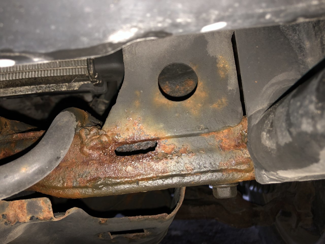

    Well I just joined the line awaiting for my frame to come in. Wanted to wait til next year but couldn’t take not coating it if it didn’t fail.
    I will be keeping my truck until it comes in 3-4 months they say.
    I will have my new winters mounted on the stock steels and have removed avid bars and add on’s before she goes.
    I love the thought of a new frame but shudder to think of what they will get wrong. I try to check their work and usually find something loose or grommets not seated some shit like that.
    Here’s my hole!! The round bar is the tie down on the front crossmember.
    08 base so no fancy skids.
    164k
    On a side note the tech made a statement that these frames are covered for 15 yrs. I didn’t say anything. And the desk guy said hmm depends if there is a open recall? I said it’s not a recall it’s a class action suit he didn’t look up at all. Yes he says it is covered lol.

    I’m in the queue as well. The rot on my frame was on the inside towards the middle of the side. It was not near a corner or near a weld like yours. My dealer did not offer a vehicle nor did I push for one yet.
    I wonder if other spots on my frame are ready to let go.
    Please think again about not taking a loaner from Toyota. Rot that close to a weld and near a corner can raise stresses quickly.

    It is the weld itself that is missing.
    Noticed it last yr realized it was actually a hole doing my after winter clean and coat. Not overly worried about it structurely. More worried about the thought of it being at the dealer for that time period. If it’s not in the garage I want it in sight. So I really prefer to keep it with me until needed.
    A loaner would had been provided and will be when that time comes.

    Looking at your hole it does not appear the weld bead even touched the joining member. The edge is so straight and ‘clean’.
    Eeeek! Hate to think about all the other welds if this one was so poorly made.

    The puddle of weld on the left of it is impressive.
    Tech says they have seen a few like mine but that’s it maybe 4 he said. The usual spots are solid!!
    Confused me. Guess I paid to much attention to the underneath and not enough up front?

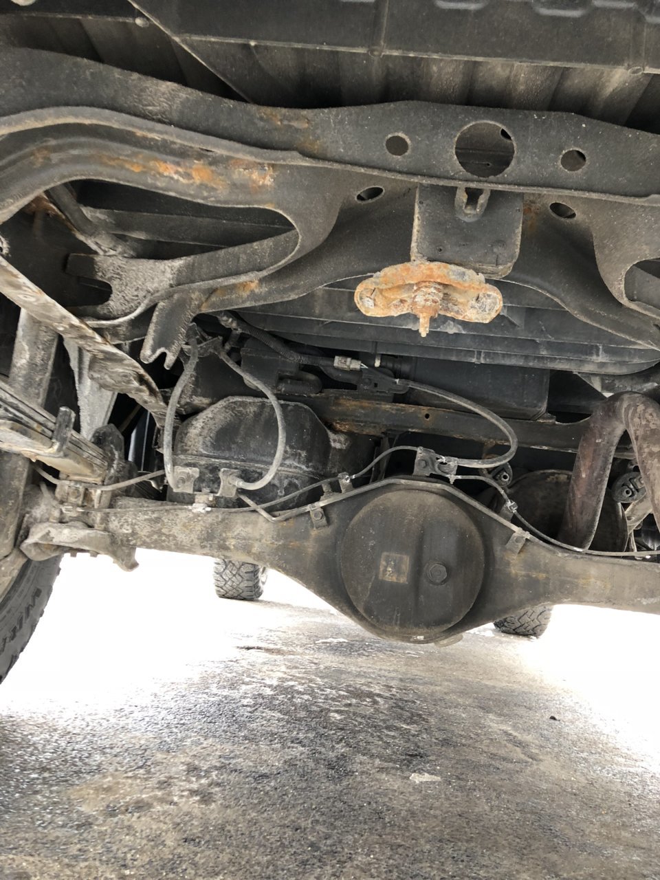

    Lol just had to go out and the dealer is 2 blocks away from me.
    A truck was pulling into the dealer with about a dozen frames.
    Been watching my phone for the call.
    Thinking I want to go take one and have it blasted and redone with something better.
    We build casting machines where I work I’m a machinist and we have full blown fab/machine/paint in house. And the primer/paint we use lasts in some pretty crappy environments.
    I’ve worked really diligently to maintain my frame.
    Lots of hours on my back picking scabs.
    Pic was April 18 the tire thing is Toyota’s doing the rest is me.
    Still have a hole seems it was all for not. I will do it all again with the new frame but I have a chance to do it before it has rust hopefully.
    I was thinking my worst areas were above the spare and at the gas tank.
    The 2 minute update.
    Lol dealer just called!!!!!
    Customer satisfaction call grrrrrr!
