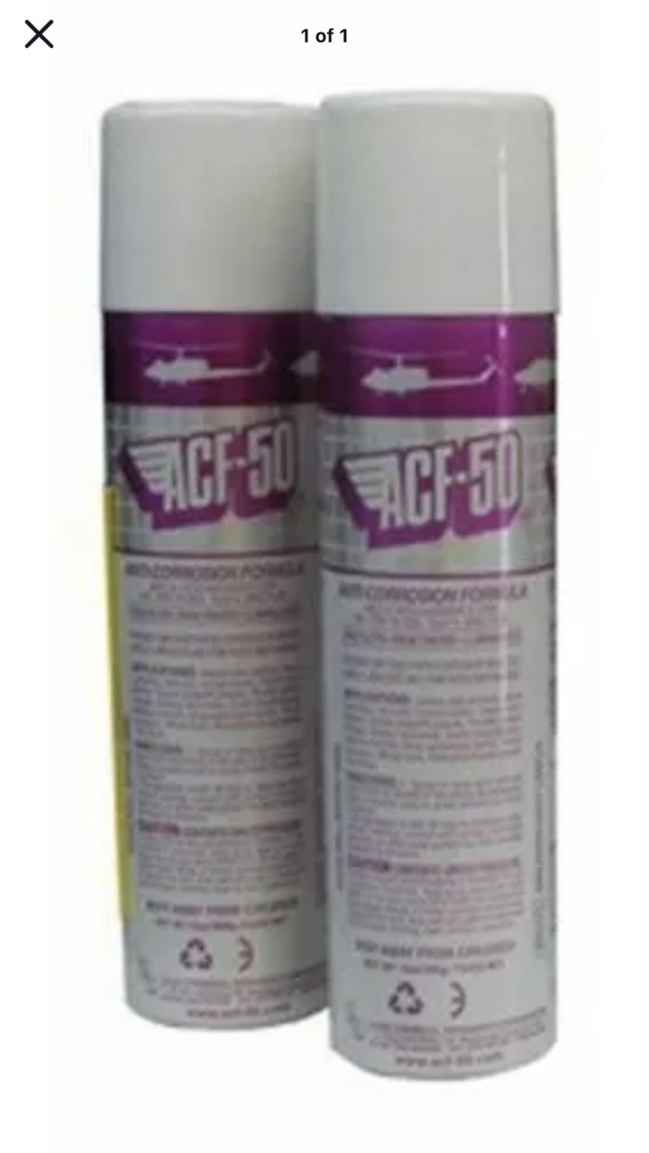

    Hi has anyone used this spray on there frame to keep it looking new?

    a lot of people use Fluid Film / Wool Wax. I've heard of people using ACF-50 and I know there are a few threads about it... google 'ACF-50 site:tacomaworld.com' and you'll get some discussion

    Never used ACF-50 but have done the old used oil and dirt road method in the past with good results. For the taco I plan on getting a coat of NH Oil sprayed soon and resprayed before the winter season.

    ACF-50 is a penetrating corrosion inhibitor. It works well to get between layers and under fastener heads and nuts to break up anodic cells but it can also result in loosening of shear fasteners like rivets that can't be tightened easily. If you regularly check the torque on all the frame mounted fasteners, it wouldn't be a bad idea, but it won't last very long on outside exposed surfaces. Same goes for CorrosionX. I've used both extensively in Aviation
