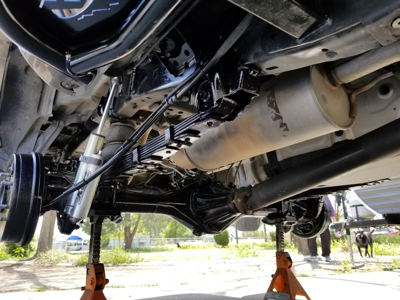

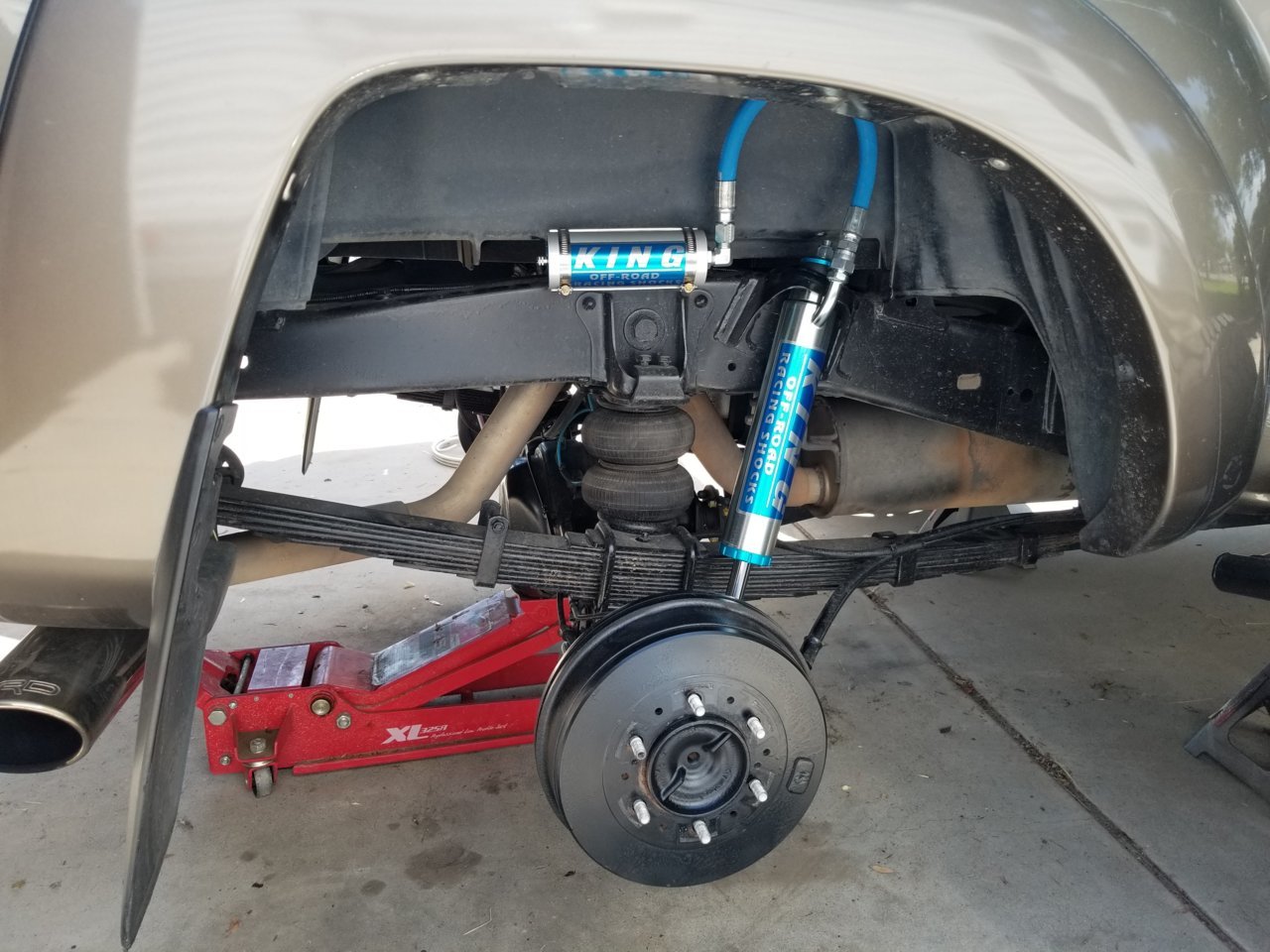

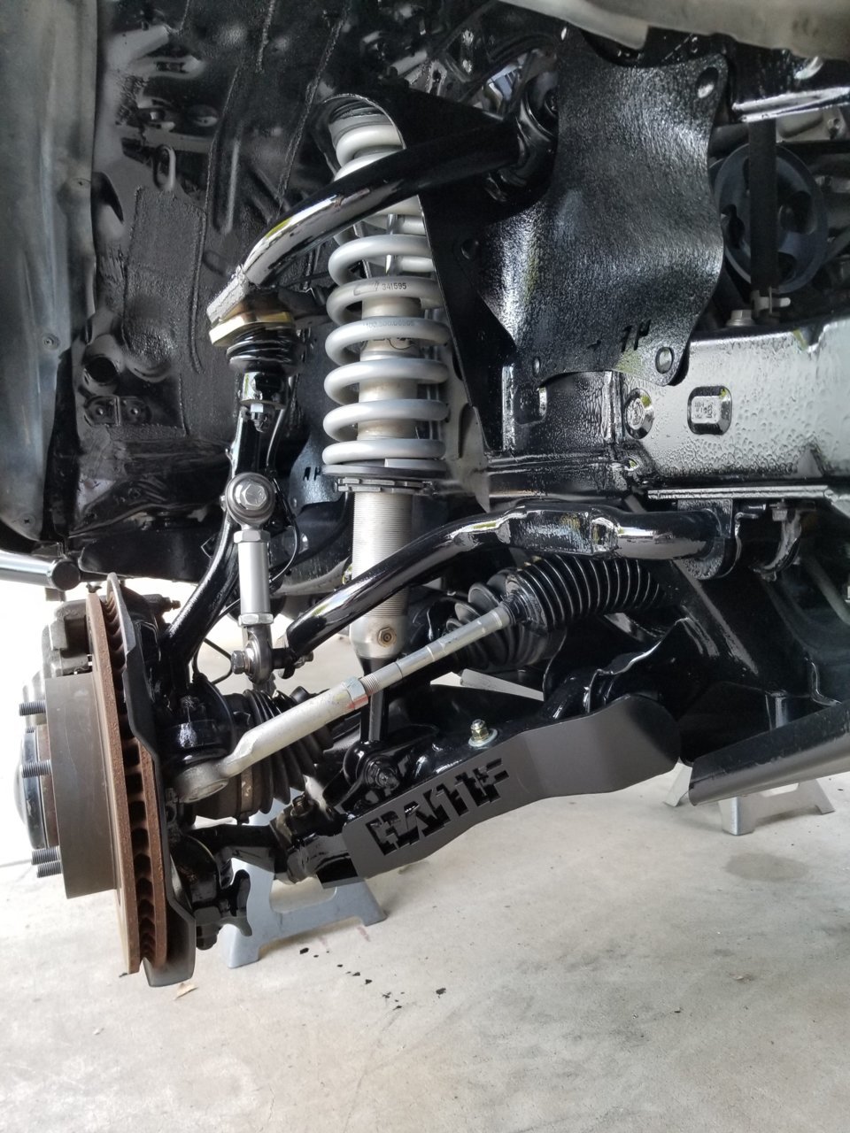

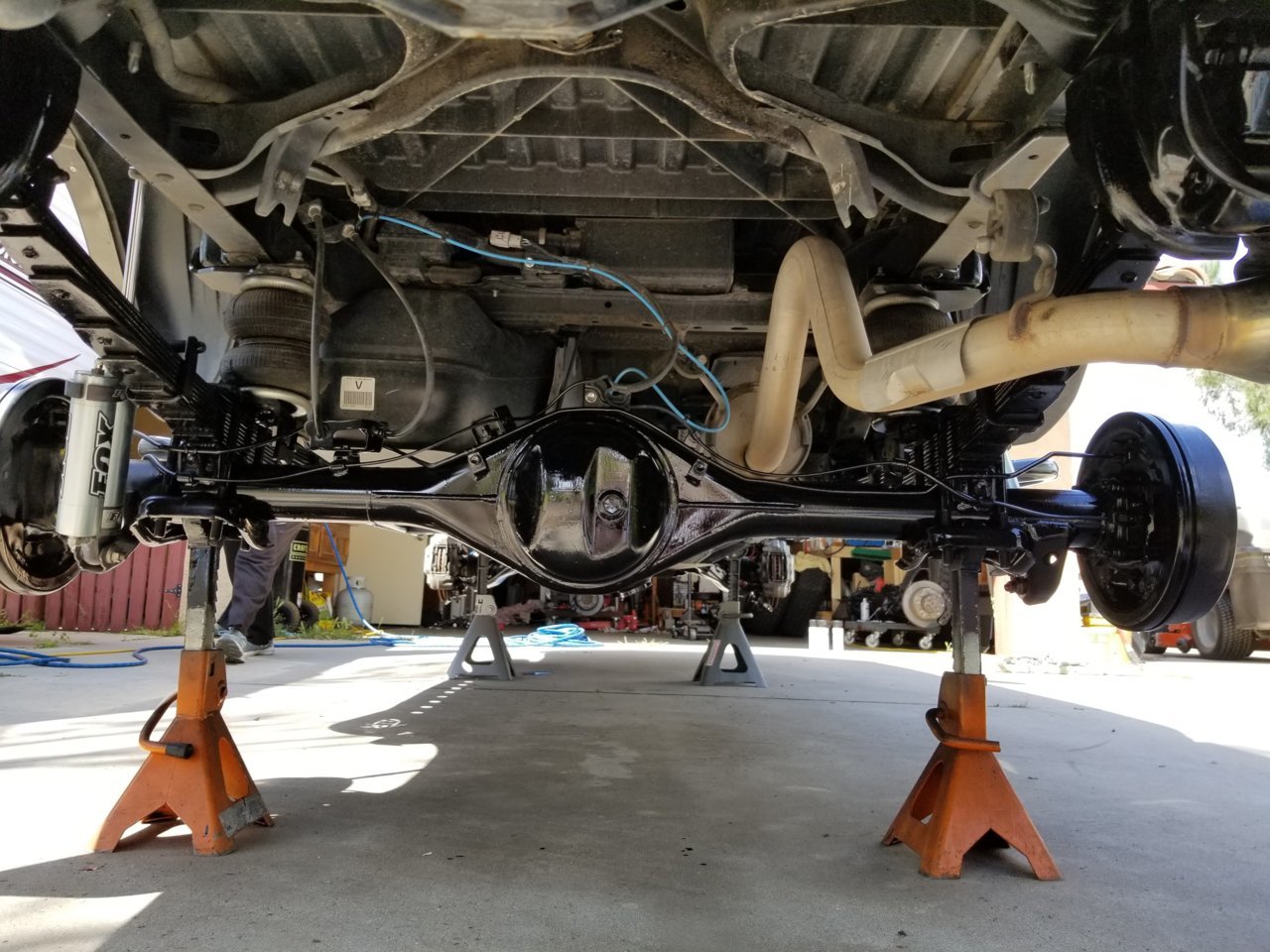

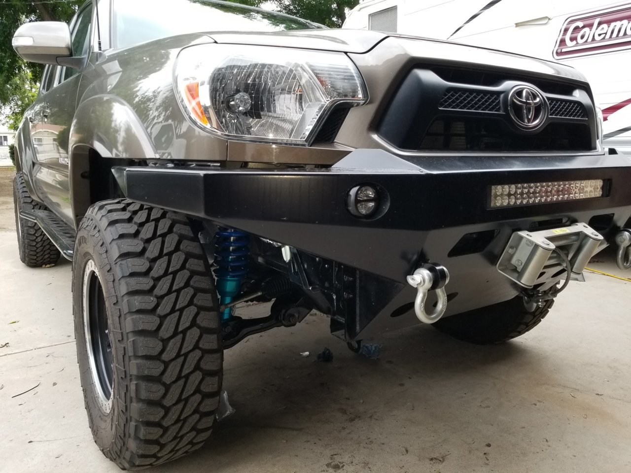

    Whenever I do a suspension modification, I spray what I am working on and the frame. Here is my 1st lift kit and everything painted. I think this shit works quite well. Then again, I guess you could spray this shit all over everything if that's the way you want to do it.

    Again suspension looks nice but it’s not a suspension thread. Got anything from under the truck showing the rails and whatnot?
  10. Apr 4, 2021 at 2:00 PM
    #30
    Mully
    Mully Well-Known Member
    Feb 12, 2014
    #122907
    5,267
    CA
    12 DC 4x4 Lifted Sport
    Lifted, Kings, Locked, 295s and more.
    Look at the frame in front of the coilover.

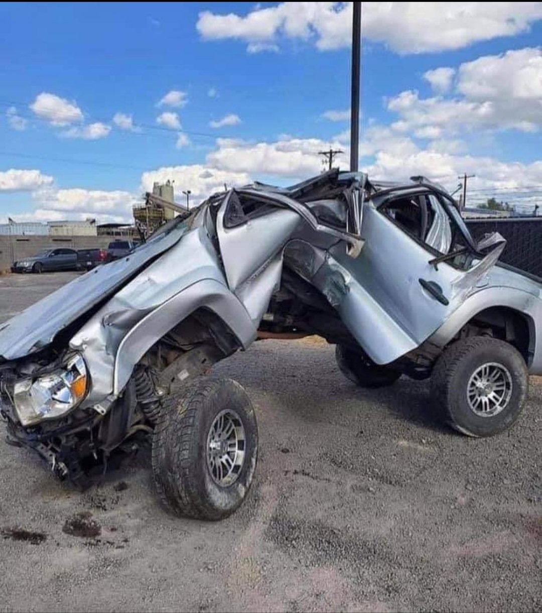

    Little bondo and paint and that trucks good to go.
  18. Apr 5, 2021 at 9:20 AM
    #38
    Mully
    Feb 12, 2014
    #122907
    5,267
    CA
    Still runs, won't shift into gear though.
