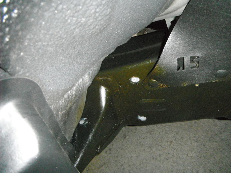

    Yes, if you look directly up from the front mud flaps, you will see small holes in the boxed section that lets any water entering the box section drain through those holes and they need to stay unplugged or you will have water collect there, causing corrosion.

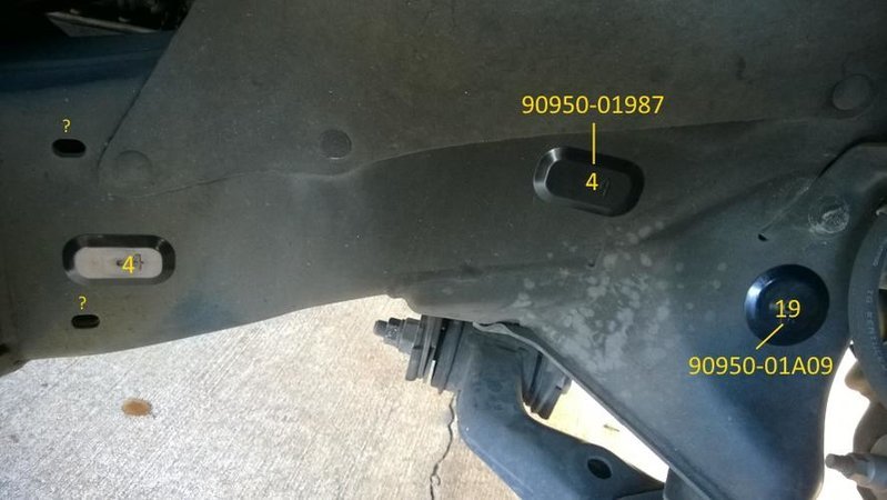

    I still haven't blocked these 2 small hole towards the back of the front wheel wells and may use some caulking inside them, but they aren't critical. Makes you wonder why Toyota has these holes and what their purpose is?? :confused: Maybe in the manufacturing posess, these holes under the front wheel wells are attachment points during the manufacturing process.
    Seen here with the ? marks =>
