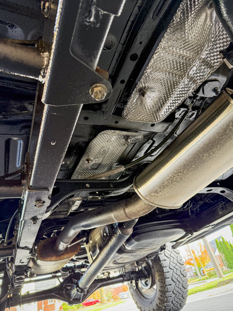

    #127
    Coopsdaddy
    Coopsdaddy Well-Known Member
    Jul 7, 2017
    #223417
    471
    Quinton
    2012 dclb tacoma
    6112/5160 Deaver stage 1 Are topper Steelies,255/80/17
    Wool wax hard on.
    No nasty mess and last 5-10 years vs 1-2
    Kind of hard to see in my photo.
