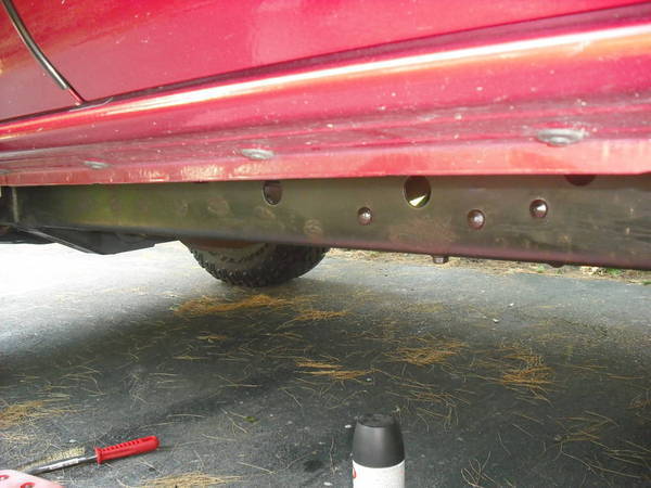

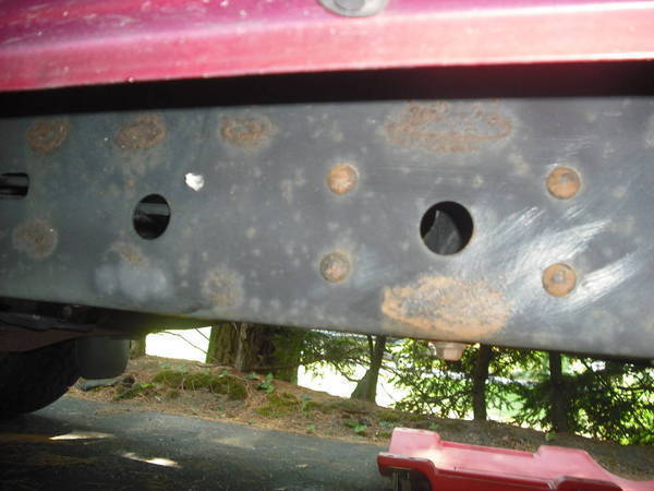

    Up in the north east the winters take their toll. My truck is an 06 so its headed for its sixth winter. The truck is in excellent condition and that inludes the frame. I noticed some rust/flaking around the welds and a few other areas so I decided to take of it and prevent further rusting.
    I started but wire brushing the loose and bubbled areas.

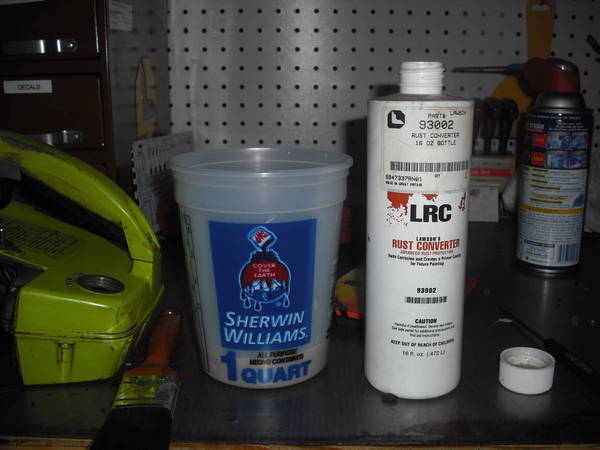

    Then I applied a rust converter made by Lawson. Goes on real easy, dries black and supposedly seals and prevents against further rusting. And you can paint over it.
    I also sprayed the exh. pipe with a high temp paint.

    Another product to look into is PRO-15, realy tough stuff. Did my 4runner with it, I purchased it at napa but you can get it online aswel.
    Just dont get it on your skin, It does not come off easily !
    Another thing a ol' timer told me about is during the winter to spray up to frame with WD-40 . I have no research on this but he has a 1st gen tocoma with a frame that looked brand new. Seemed to work for him ?
