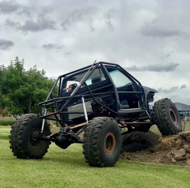

    ant-man could help maybe :confused: get into hard to reach spots

    Just have iron man build a new frame for you. Hulk smash the old one. Then go out for a drink with Blackwidow.

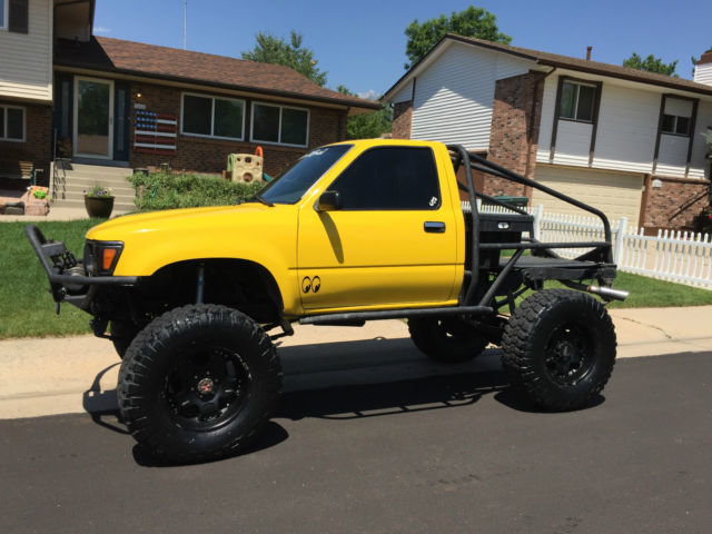

    Miguel
    El Cerrito, Ca
    2023 Ford F250
    Its the company truck
    Perfect excuse to do this
    jenk, 3pooches and GQ7227 like this.

    a yellow toyota wow!

    Or if the frame is really bad
