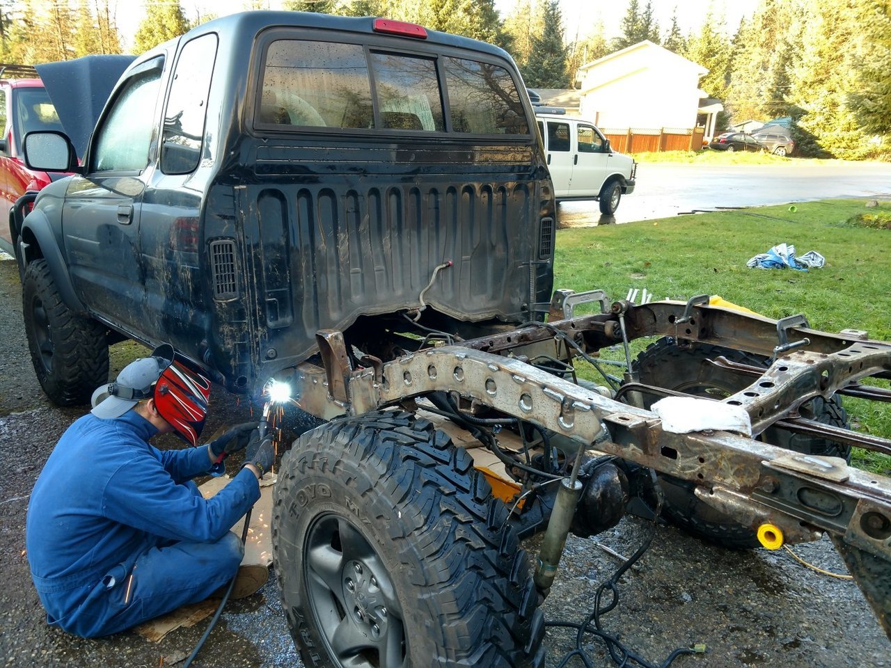

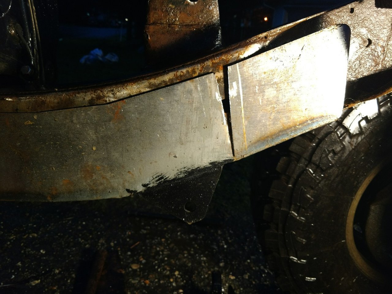

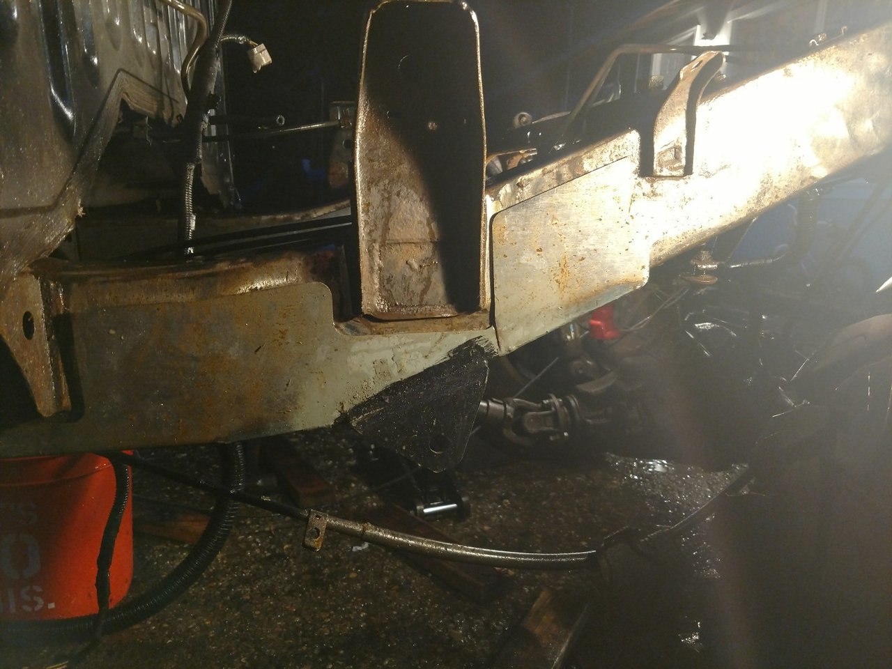

    Here we are with the Safe-T-Caps all fitted ready to go for the welding!
    If you look at some other threads on these caps you'll notice a common issue... They don't fit 100%... No amount of persuasion could get one end to sit flush when the other was good. So I made some cuts to allow them to fit nice and flush on both ends, really pretty simple.

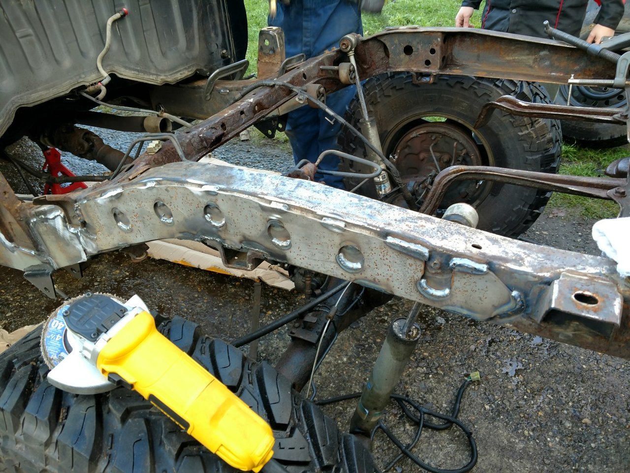

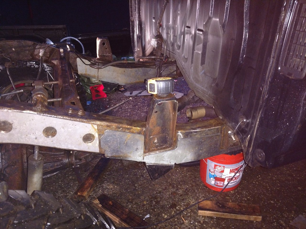

    Frame caps and reinforcements are welded in! Quick job when you've got friends who know what they're doing. This is really motivating me to pick up a welder and learn!

    You have some great friends. That looks solid.
    Anton338 and sologeek like this.

    Nice work and good job! I love seeing a first gen being kept on the road / trail and kept out of the graveyard.

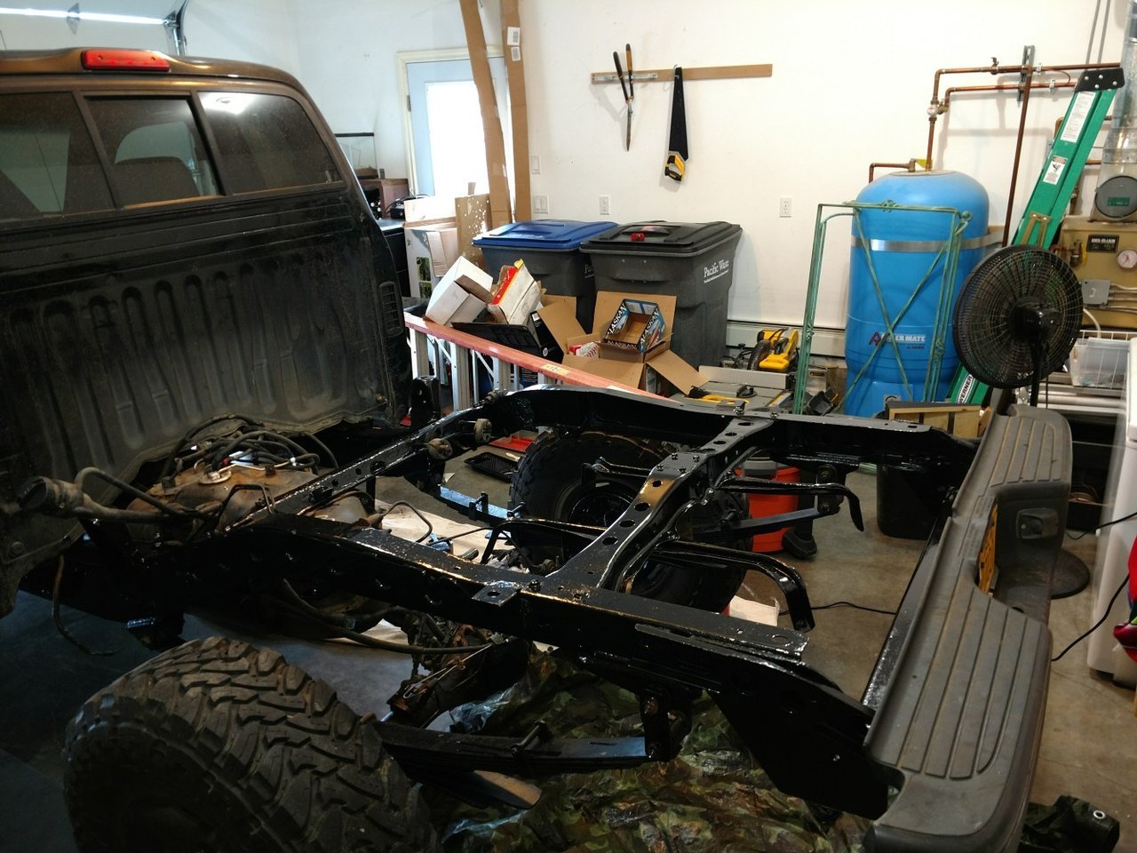

    Got her back together enough last night to drive her over to another friends house with garage space! It was fun wrangling the tank into place, by myself at 1 am... But I got'r done. Putting the leafs back in with the tires still on and lined up took up most of my evening... 3 car jack's a hilift and a multiple jack's... But that worked out as well. My output line on the LSPV took a dump... Luckily I was only a mile away... Must have been the "rust" seal on the fittings I knocked loose.... I'll be dealing with that before I can drive her back home. I might just cap the line at the t fitting up front to get me home, then install a manual proportioning valveo_O.
    Anyways... Here is one coat of POR15
