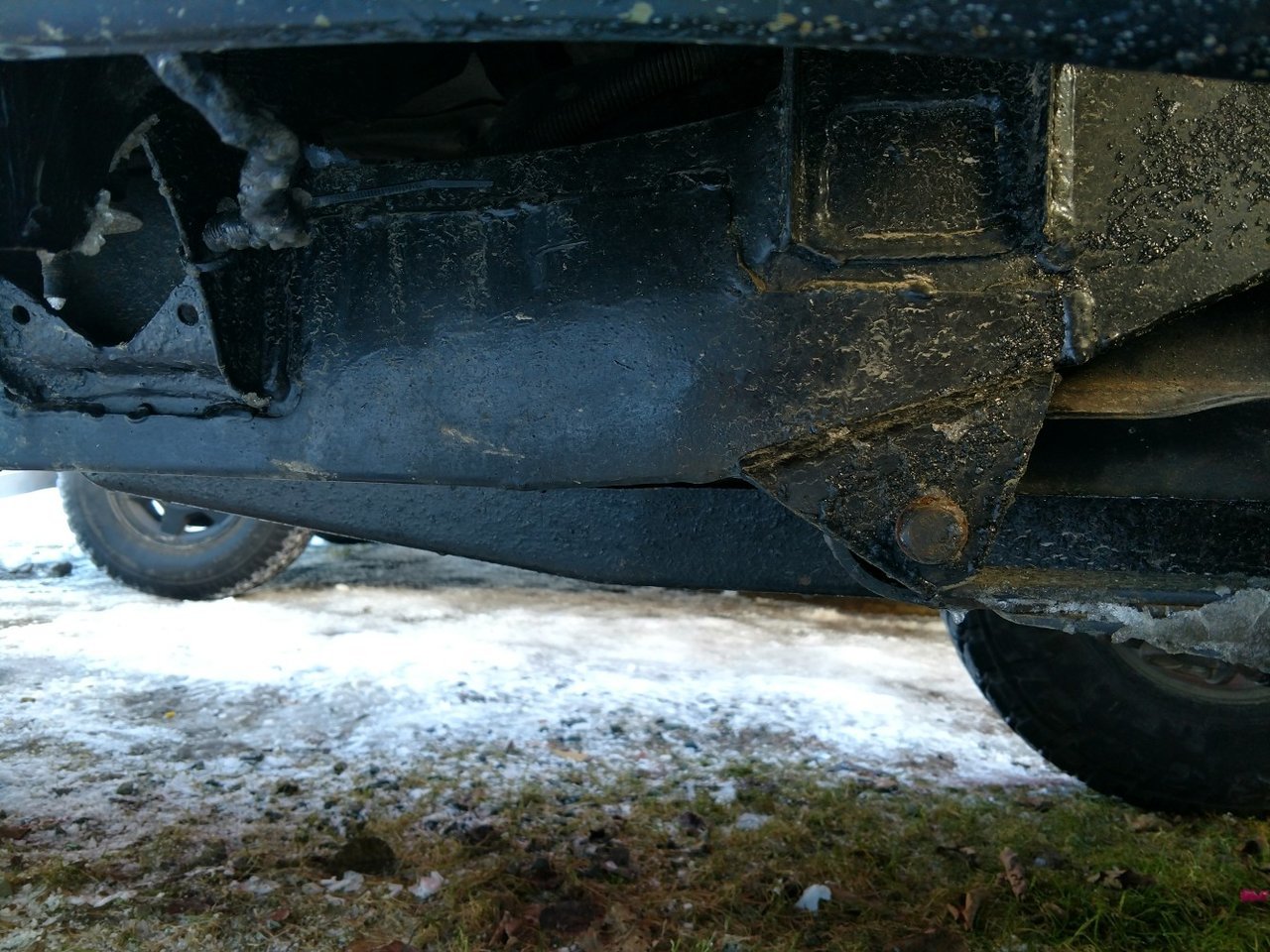

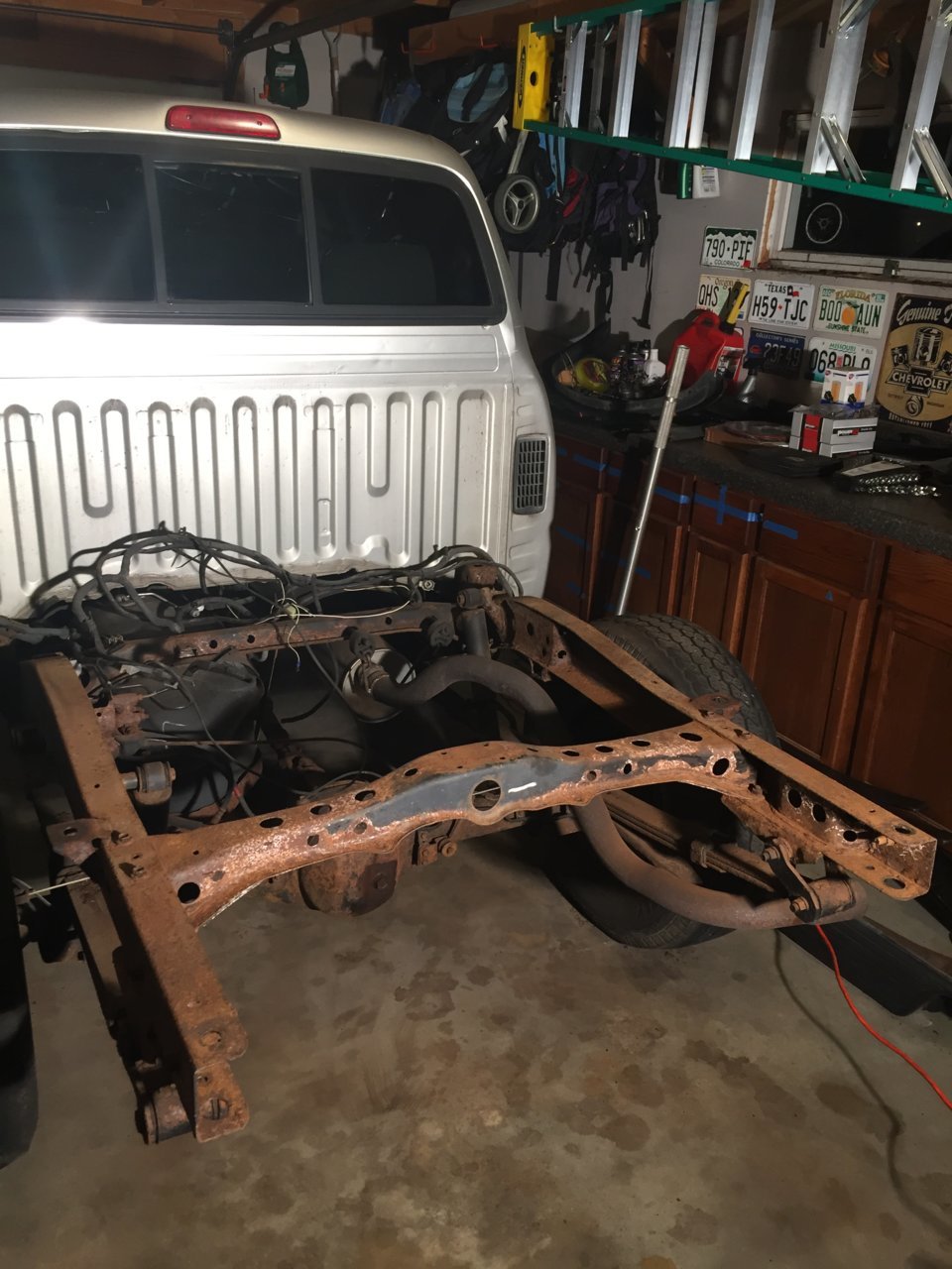

    IMG_20171112_101147901-1336x1002.jpg IMG_20171112_101154912-1336x1002.jpg IMG_20171112_101213674-1336x1002.jpg IMG_20171112_101227113_HDR-1336x1002.jpg
    I'll make sure to update how this fix holds up, but I'm hopping i gave her a 2nd life!

    damn thats how I found the rust as well. by checking the o2 sensor I heard rattling around. I think im gonna be doing this as well. did you make the plates with all the holes in them your self or is that from the auto rust tech guys? most of the rot on mine will be solved with the cap but i got a questionable spot near the top as well that would be fixed by using an idea like that plate. and thanks to the guy that said to grease it before welding. gonna try to keep this truck going strong.

    Those are frame reinforcement plates from trail gear. I didn't need them due to frame issues in those areas... I mean the c channels in the back certainly didn't look great, but no holes like by the perches. I mainly got them because I had my buddy do the welding, and since we were already at it, might as well add the extra piece of mind!
    Plus I wanna slap a CBI bumper on the back, so the extra support for $80 was a no brainer

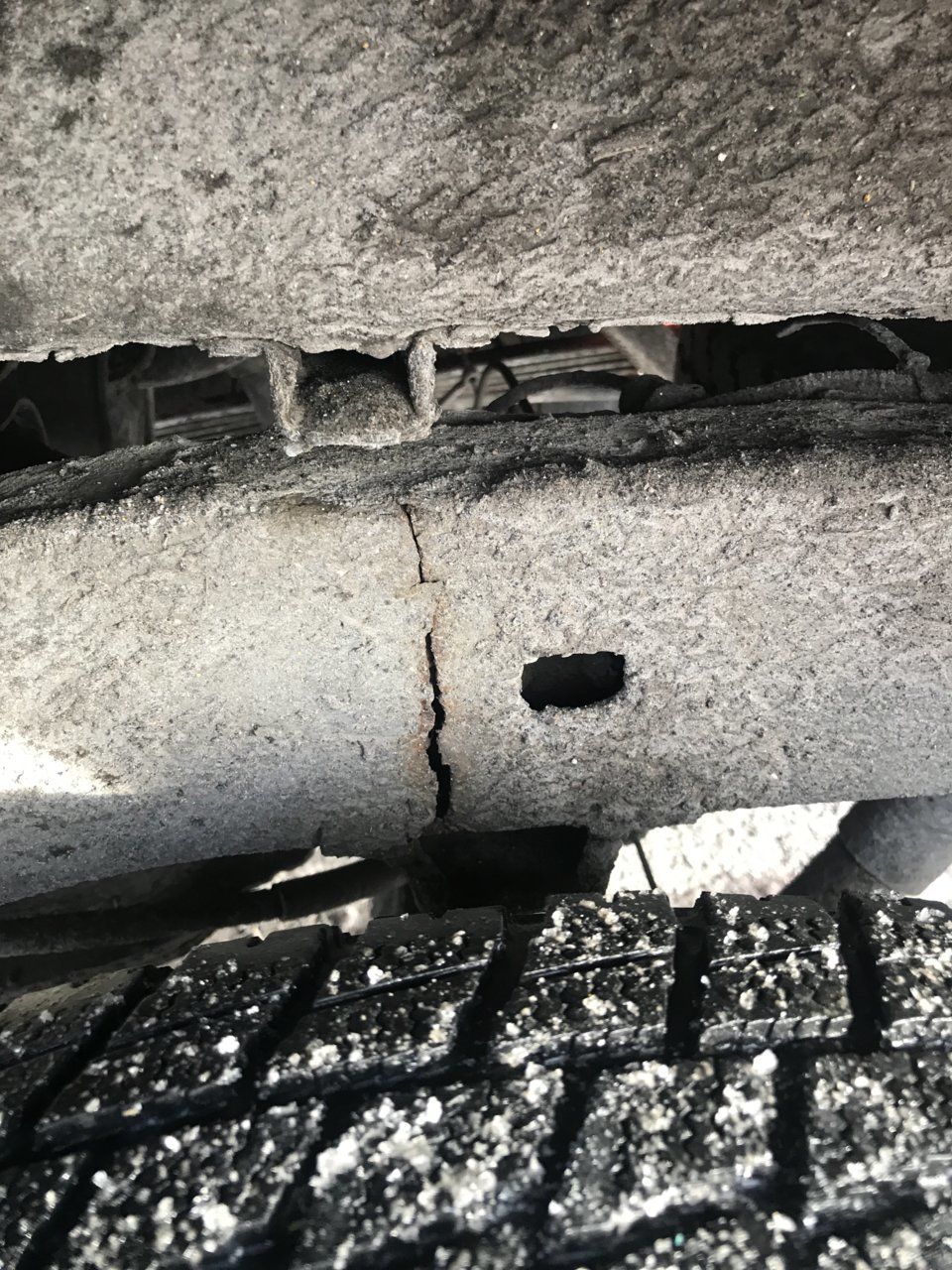

    I've discovered cracks just above the bump stops on both sides. Does anyone on here know any shops in the Montreal that are qualified to install the Safe T Cap parts? I'm also willing to drive down to NY, VT if need be...

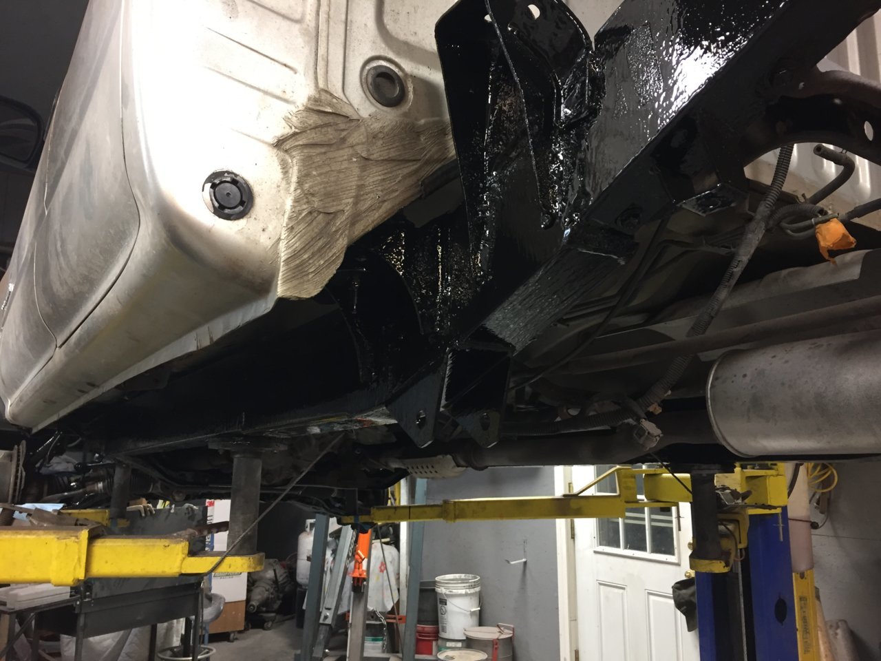

    I started the frame repair project on my 2001 Tacoma Double Cab 4WD on January 19, 2019. I installed Safe-T-Caps from AutoRust Technicians, new leafs & shackles, (2) coats of KBS Coating for the frame and upgraded to Bilstein 5100's all around. Should have the bed back on and things wrapped up by next weekend.

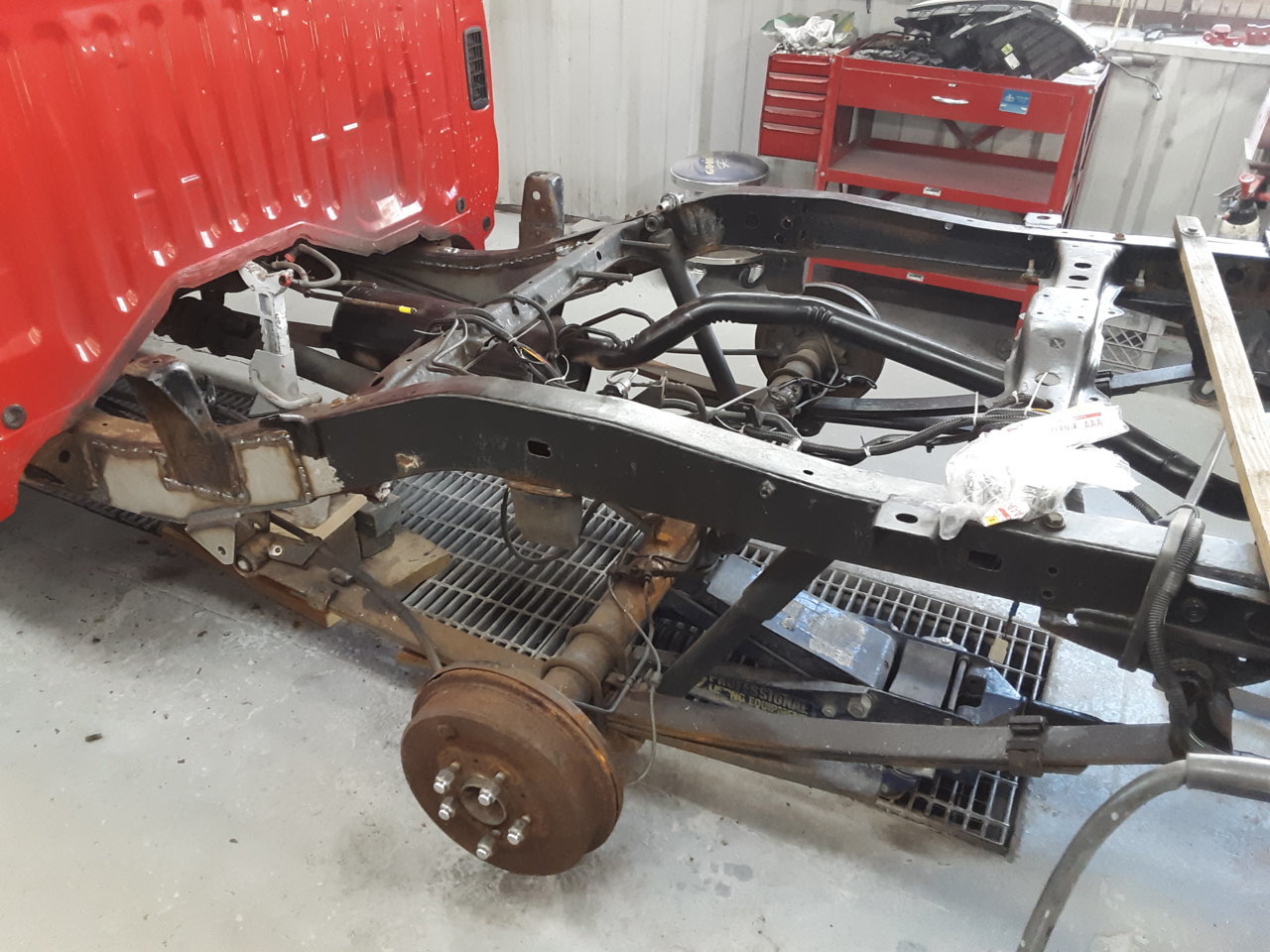

    Nice! My 2003 Xcab is in the shop now getting both forward spring patches replaced with Rust Fix parts.

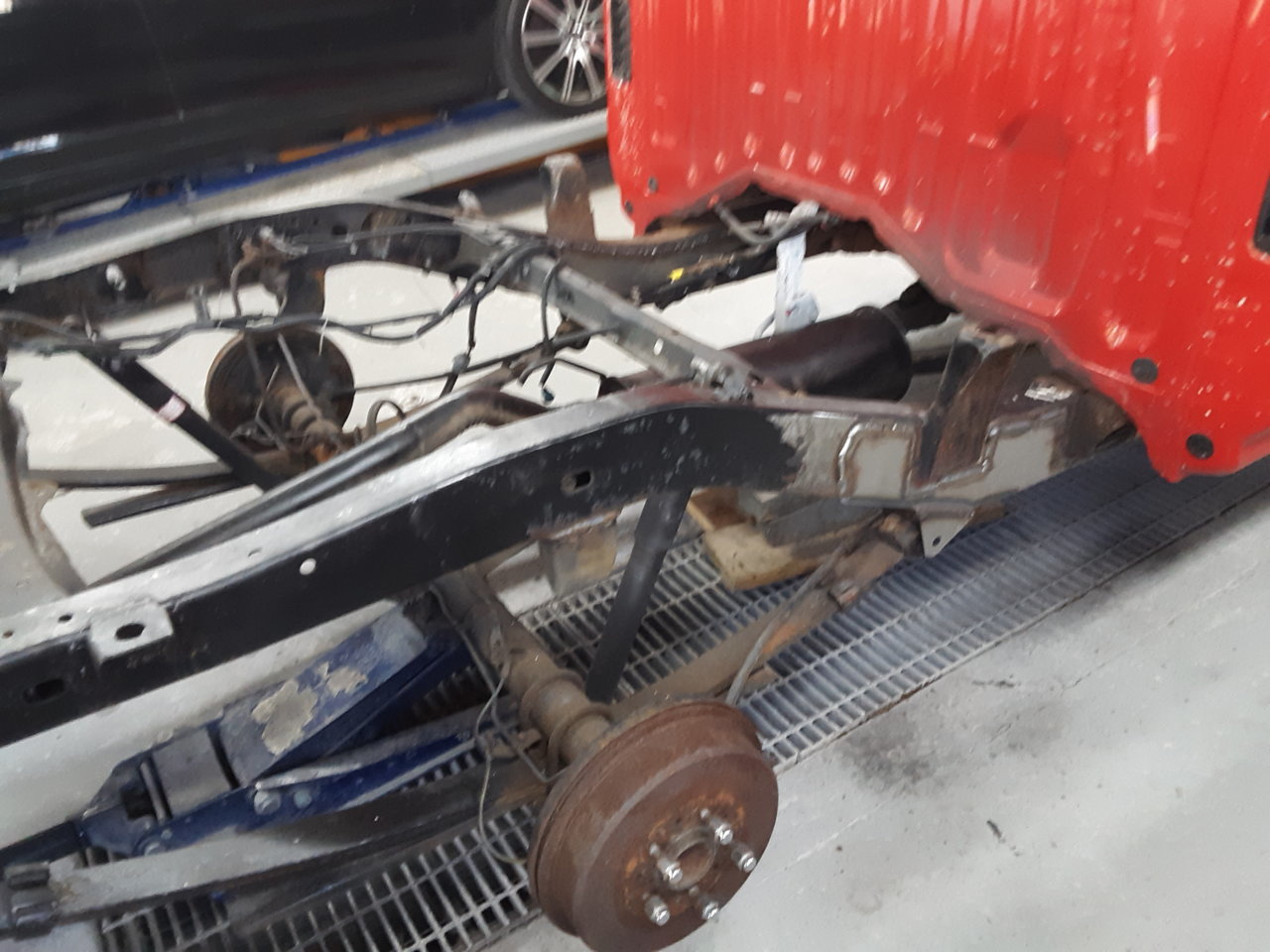

    Got the truck back Friday, Came out great!
    All undercoated by shop after this photo was taken. 151,000 miles and ready for a lot more.

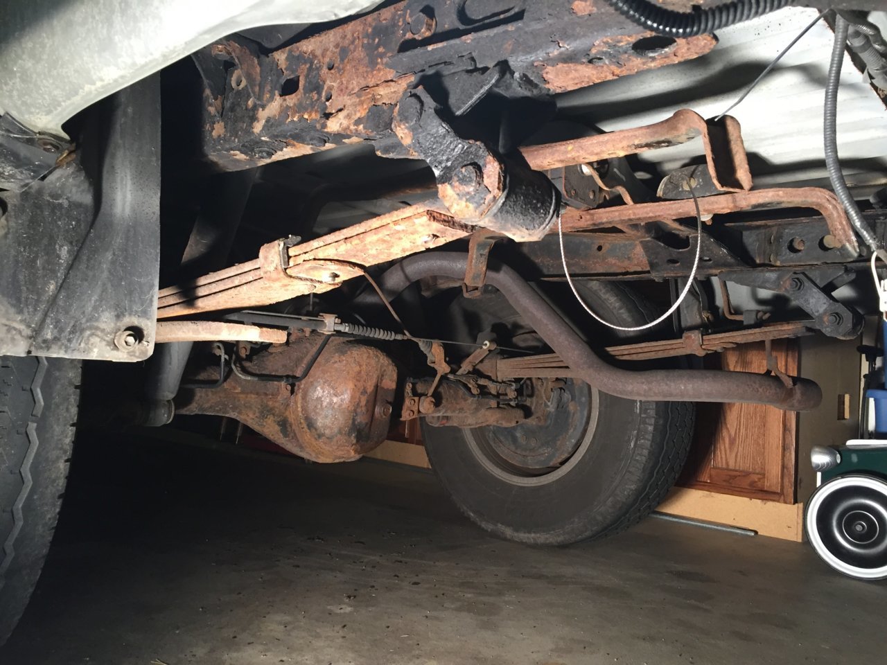

    This thread gives me hope. I don't have any holes in my frame, but I find enough metal flakes when I crawl under there that I know its only a matter of time.

    I haven't. It could be all surface, but I'd be surprised if it were. This truck has been around.
    EDIT: I really just need to pull the bed and powerwash the snot off it. Right now its hard to tell what's rust and what is just "accumulated"

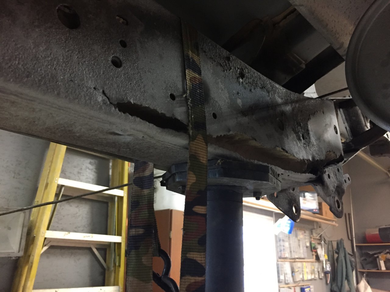

    Driver's side bumpstop last night. The other bumpstop has a hole through it.
    I've been up and down the frame itself with a hammer though, it sounds solid. So I dunno.

    On mine, the worst was the left inside frame by the gas tank.
    Hard to see. Feel for cracks up there.
    The labor to fix both sides on mine was $1250.00 Parts were from www.autorust.com
