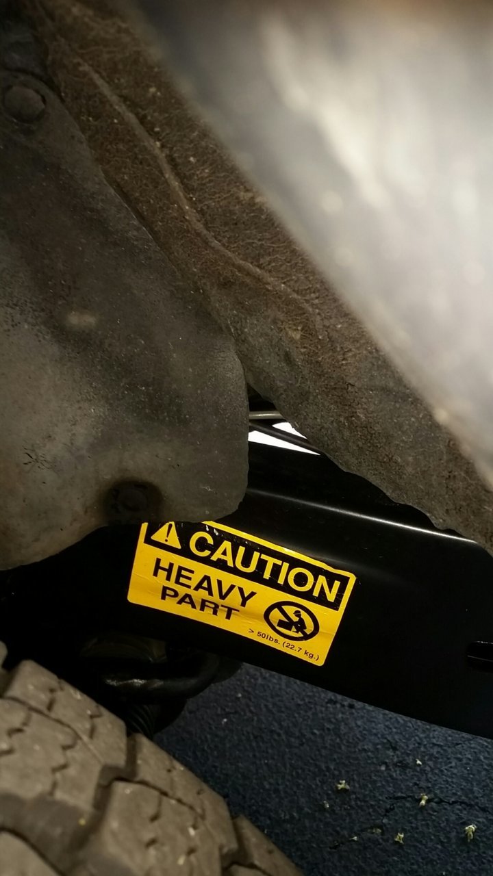

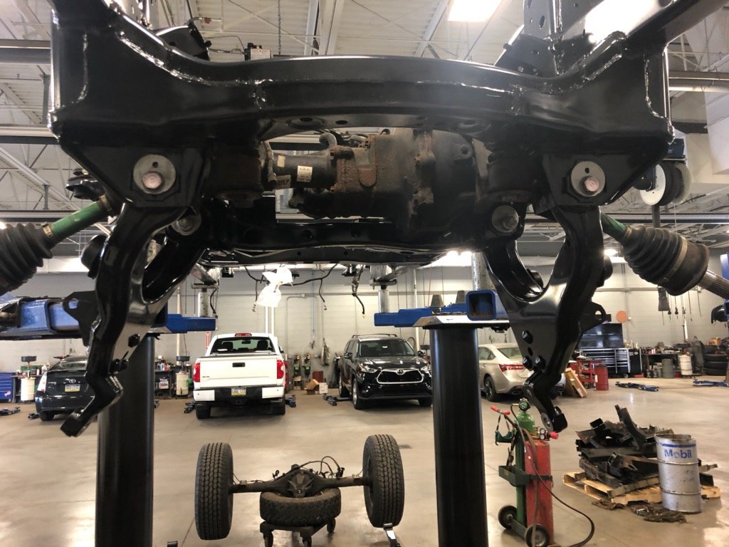

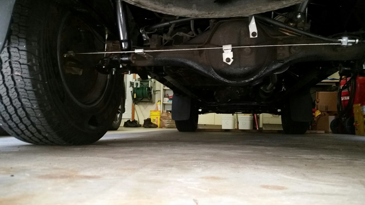

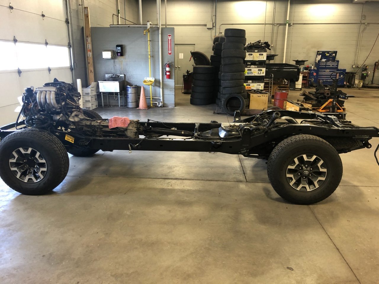

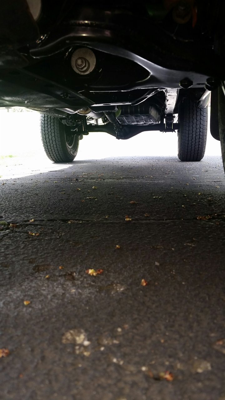

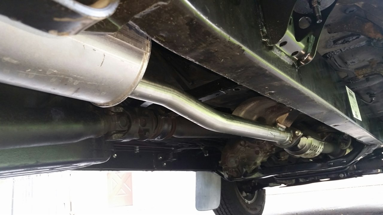

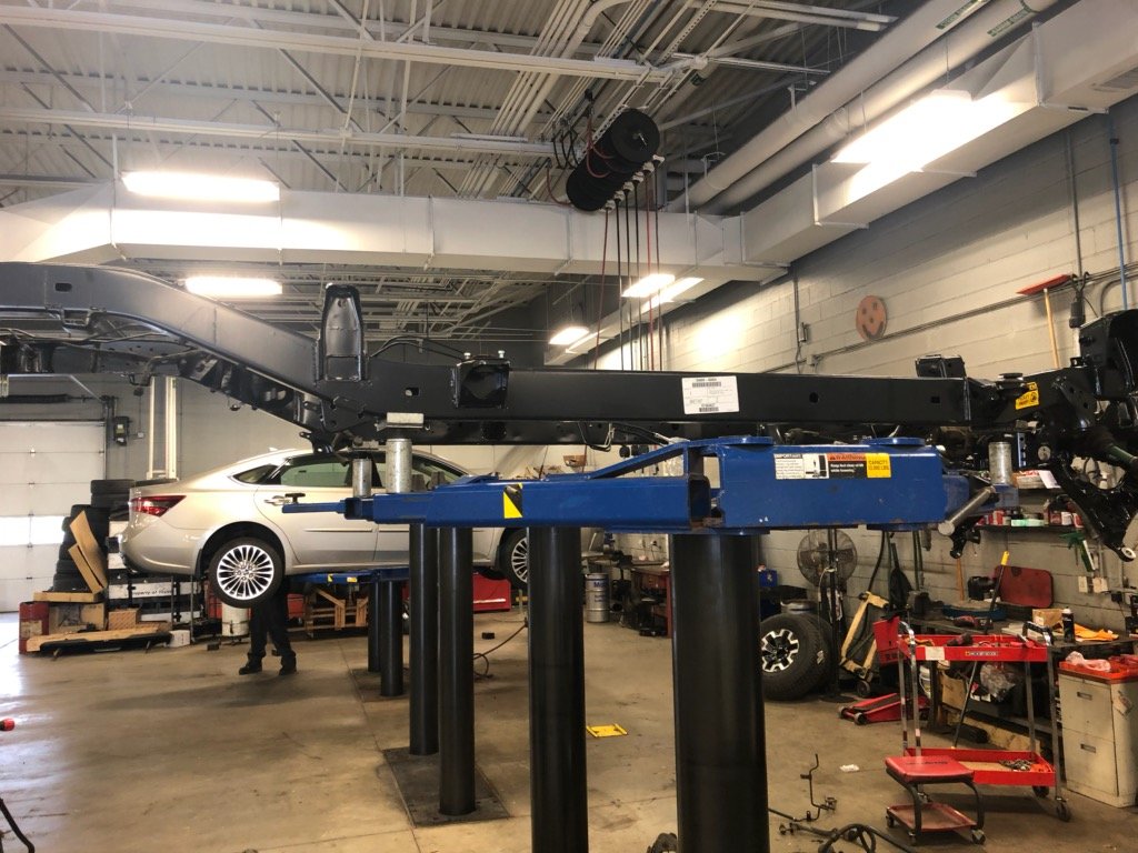

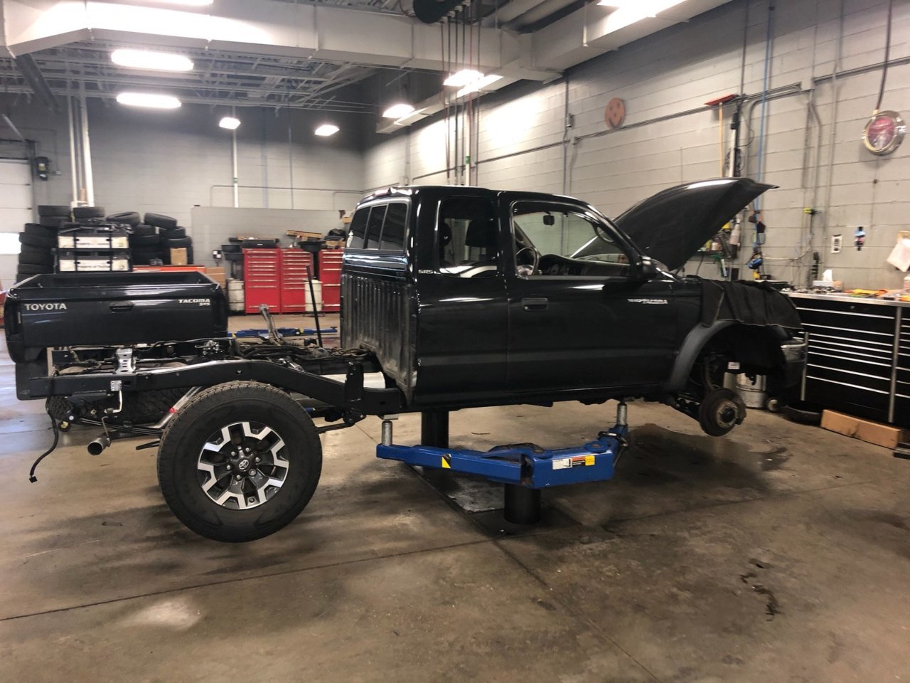

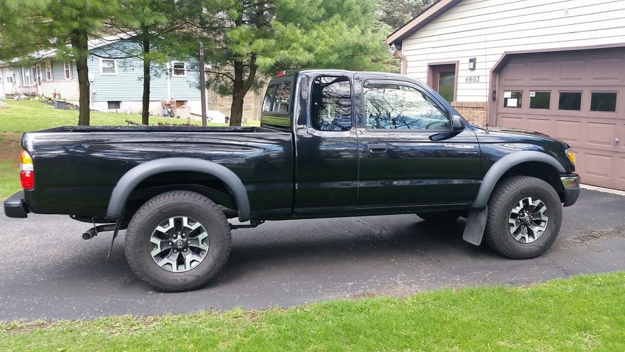

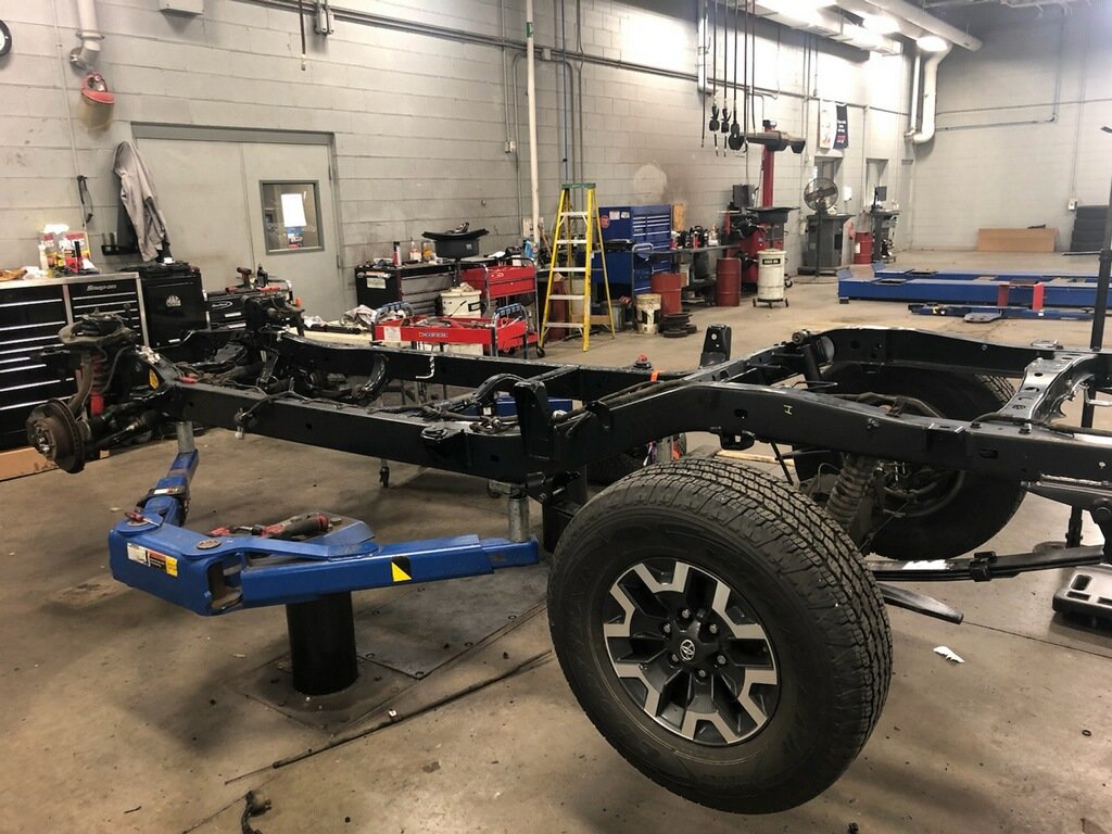

    After more than a six month wait, what is likely to be one of if not the last 1st gen frame replacement is underway.
    After an almost seven month wait It's finally finished! Lots of new parts and some additional work requested by me such as new exhaust, rear shocks, and radiator hoses. Drives and rides like a new truck.
