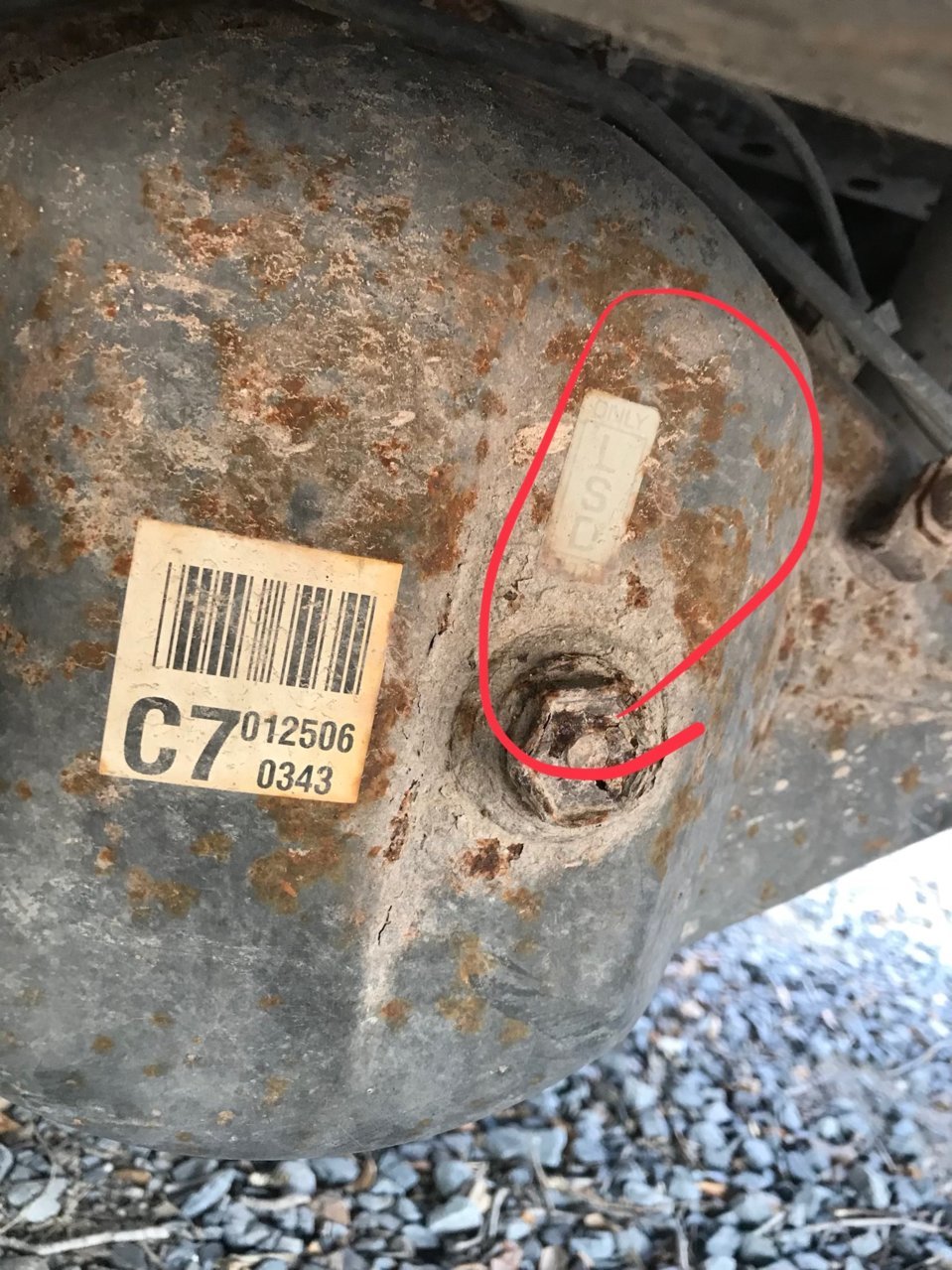

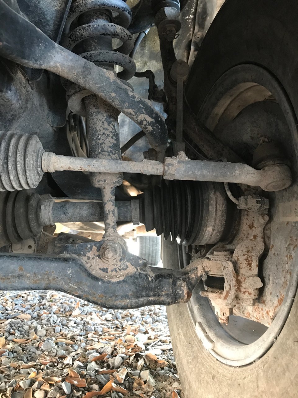

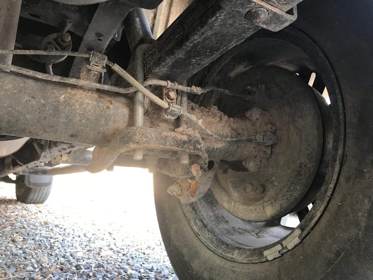

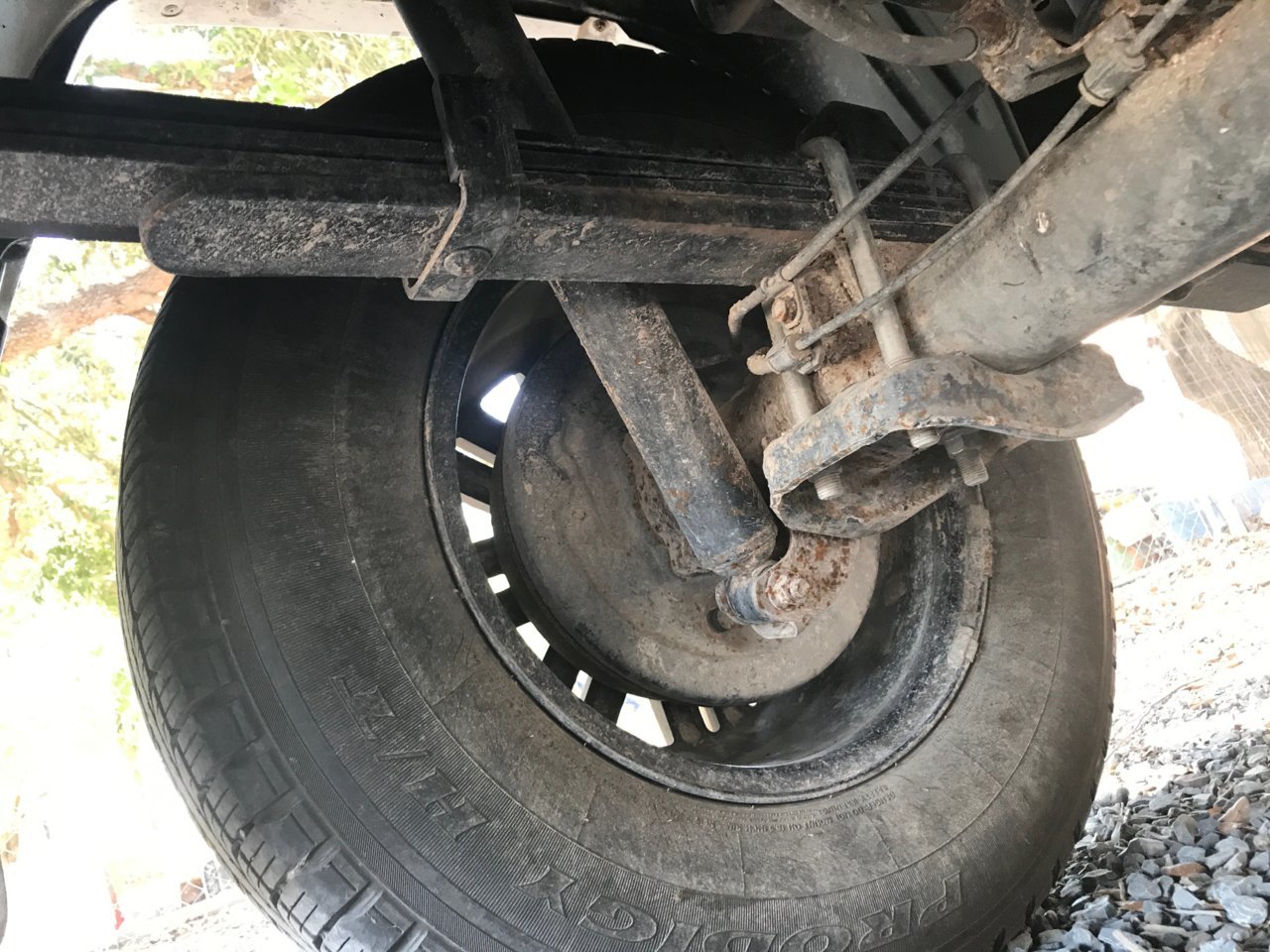

    To OP, great work!
    I'm in the process of buying my first Tacoma.
    The truck was driven up north (salt) for the first five years.
    Then owner moved down to South (no-snow/salt) for the past six years.
    The frame was replace along with the leaf springs in 2014.
    The truck, however, still show some sign of rust spot on area and parts that did not get replace under the recall.
    I have pictures for anyone that want to pitch in their advice.

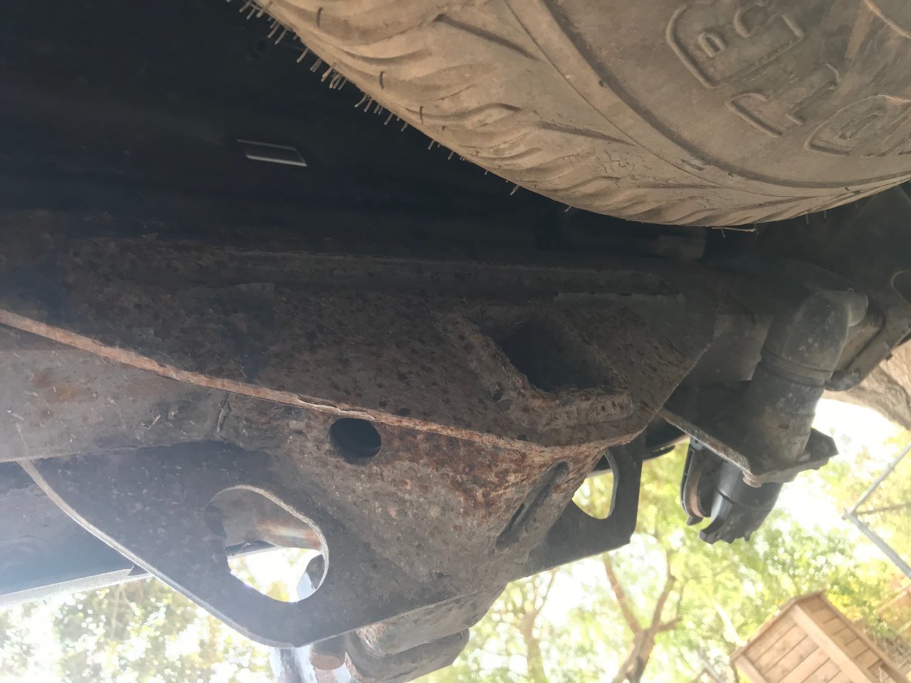

    The truck is an 2006 Tacoma 4x4 with 180k miles.
    I have been back and forth with this truck not sure if I should pull the plug and buy it or not.
    As far as I can tell, the truck would need some rust treatment on areas that is critical.
    No sure if it's a good call or not.. Thanks everyone for the input!

    Look fixable to me. But I had another vehicle to use while I took my time removing rust... Looks like the fame and leaf springs are in good shape. Tow hitch is easy to remove and work on. Guess the price will make this a deal for you.

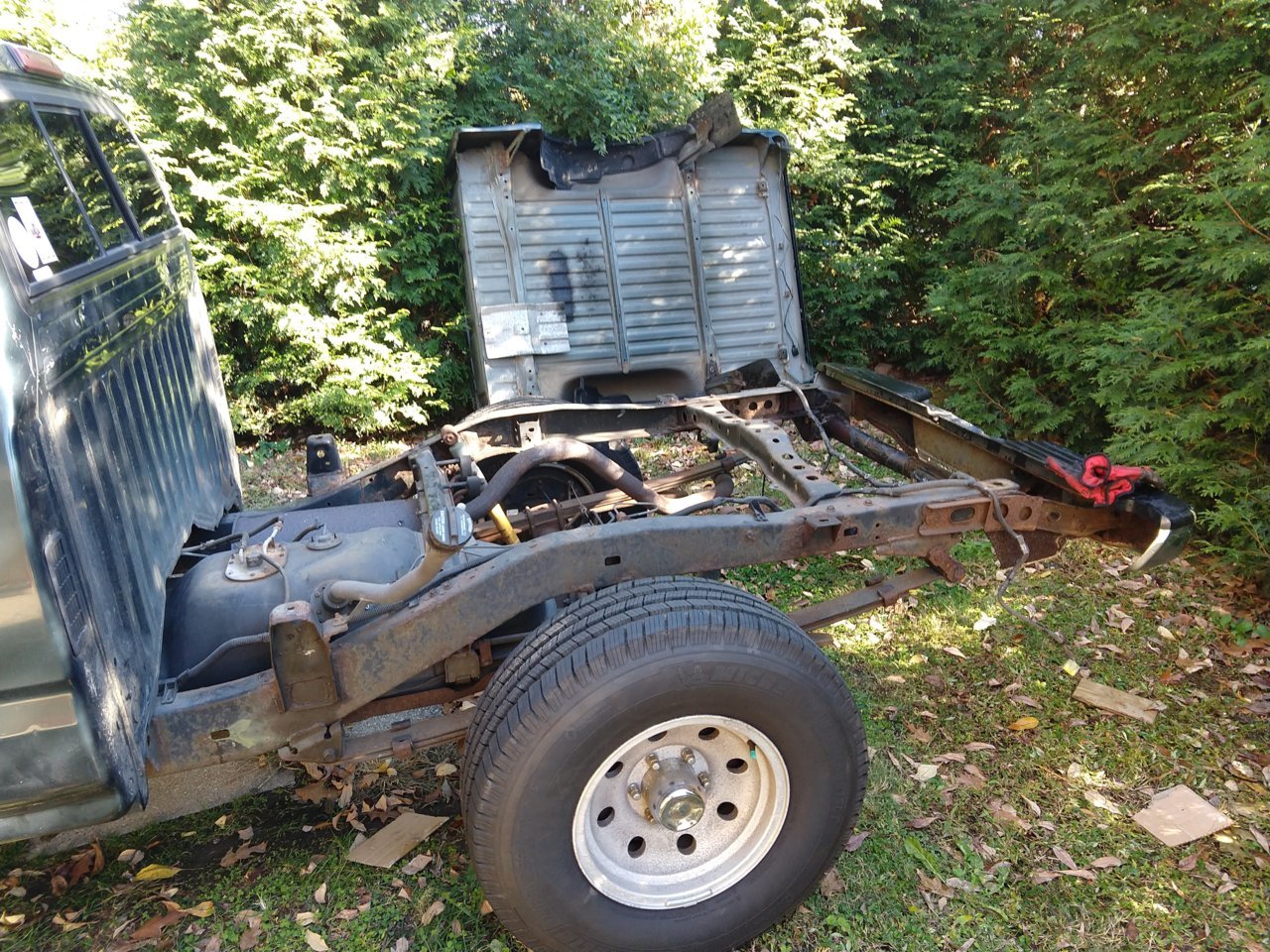

    Taking the bed off used up all the project time I had allocated to my frame painting, but excited to get started with the needle scaler tomorrow ... only a week late!

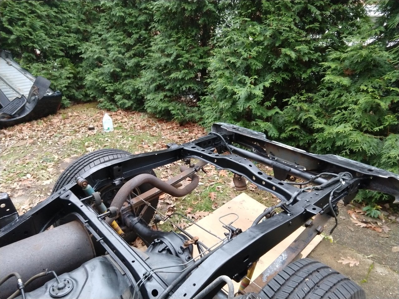

    So this is probably going to be an unpopular opinion here, but I would definitely not do this job again. It was hard, uncomfortable, labor-intensive, and time-consuming. For a truck I bought for $2,500 - I should have just wire-wheeled/brushed and used a pressure-washer to degrease the back-end (without any disassembly) and sprayed Ospho over everything. I think that would have been about 90% of the benefit and 5% of the time.
    Someone asked for time estimates up-thread, here's what it took me. Note, I only did from the back to just before the front wheel wells (my front looks pretty good and space constraints in the back-yard kept me from getting at the front). Add some hours to do the whole job.
    • Needle-gunning: 8 hours
    • Degreasing/Washing: 1 hour
    • Rust Converter: 3 hours (less time needed than painting as the whole truck didn't need to be covered)
    • Sanding/Air-gunning surfaces: 1 hour
    • Painting: 6 hours
    • Total project time: 18 hours
    Here are my tips/findings.
    • As others have mentioned, if you could get a decent angle on everything, it would probably be faster, but a lot of time is wasted just trying to get into position (I left the truck on its wheels as the ground was pretty soggy for jackstands, but did remove the bed).
    • Get full chem goggles or a face shield, even when needle-gunning. I was wearing 'sport' safety glasses as that's what I had up here, and shit flew in the sides all the time, especially when laying down. Took some breaks to eye-flush, especially when needle-gunning. In the same vein, dust mask for needle-gunning, and respirator for painting. Even outside, working up-close to the acid-based rust converters and paint is pretty harsh. My 3M worked great to protect me.
    • I applied with foam brushes and a quart can. The foam brushes were exceptionally frustrating. While okay on flat surfaces, they don't apply paint very well to round surfaces (think axle/diff and tow bar), and they don't spread paint well enough on medium pitted surfaces/seam welds, especially upside down. A rattle can of Eastwood would be a helpful addition as the forceful spray would better coat pitting, apply to welds, and get the rounded surfaces done. In addition, I went through about 18 foam brushes - I actually used so many I had to stop painting and go down to Lowe's to get more! While the foam brushes kept some stiffness for the first few dippings in the paint, they very quickly became paint-logged and floppy, and lost all stiffness, which made them very difficult to use, especially upside-down or when trying to force paint into narrow places. In addition, the coarseness of the surface ripped the foam apart, and they quickly disintegrated/tore apart. I really needed firm tips to dab paint into weld-seams on the frame, and a flat brushing surface to get the long straight-aways. The foam brushes provided neither for very long. For what it's worth, I've used foam brushes quite a bit for marine varnishing, and this is the first time I've had issues like this. I used the multi-pack 'Project Source' ones from Home Depot/Lowe's - not sure if there are better ones.
    • I used Eastwood Rust-Converter on heavily-rusted areas and then top-coated everywhere with Eastwood Rust Encapsulator. The Eastwood Rust-Converter DOES NOT work with a standard trigger-bottle head, despite their assertions to the contrary. It is thick, and very quickly clogged/broke the spray head. To spray hard-to-reach places that the foam brush couldn't get to, I switched to Ospho, which is thinner and sprays very well with a standard trigger spray head (like what you have on a Windex bottle). The Rust Encapsulator, on the other hand, is a great product that creeps very well and spreads smoothly.
    Anyways, here's the finished product, now to cut holes in the bed so I can get the nuts out and re-secure them.
