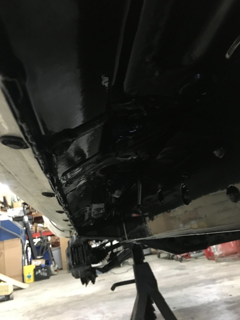

  4. Feb 2, 2019 at 8:22 PM
    #204
    SaphiraTaco
    SaphiraTaco Well-Known Member
    Feb 8, 2018
    #243869
    483
    Sean
    Seattle WA
    2013 DCLB TRD Sport
    About halfway done...
    Don't skimp on the Ospho metal treatment. Apply it generously. It stops the rust chemically which is the most important part. Covering with the Por-15 will prevent new rust from starting.
    bax and CableTec[QUOTED] like this.

  7. Apr 18, 2019 at 11:34 PM
    #207
    SaphiraTaco
    Feb 8, 2018
    #243869
    483
    Sean
    Seattle WA
    2013 DCLB TRD Sport
    I applied two good coats on full frame, LCA, tow hitch. I used no more than 8 ounces.
    I would recommend the smallest cans you can find. Because it's hard to preserve the larger can before it goes bad or lid gets stuck. Also, put at least two layers of plastic on the can before closing the lid.

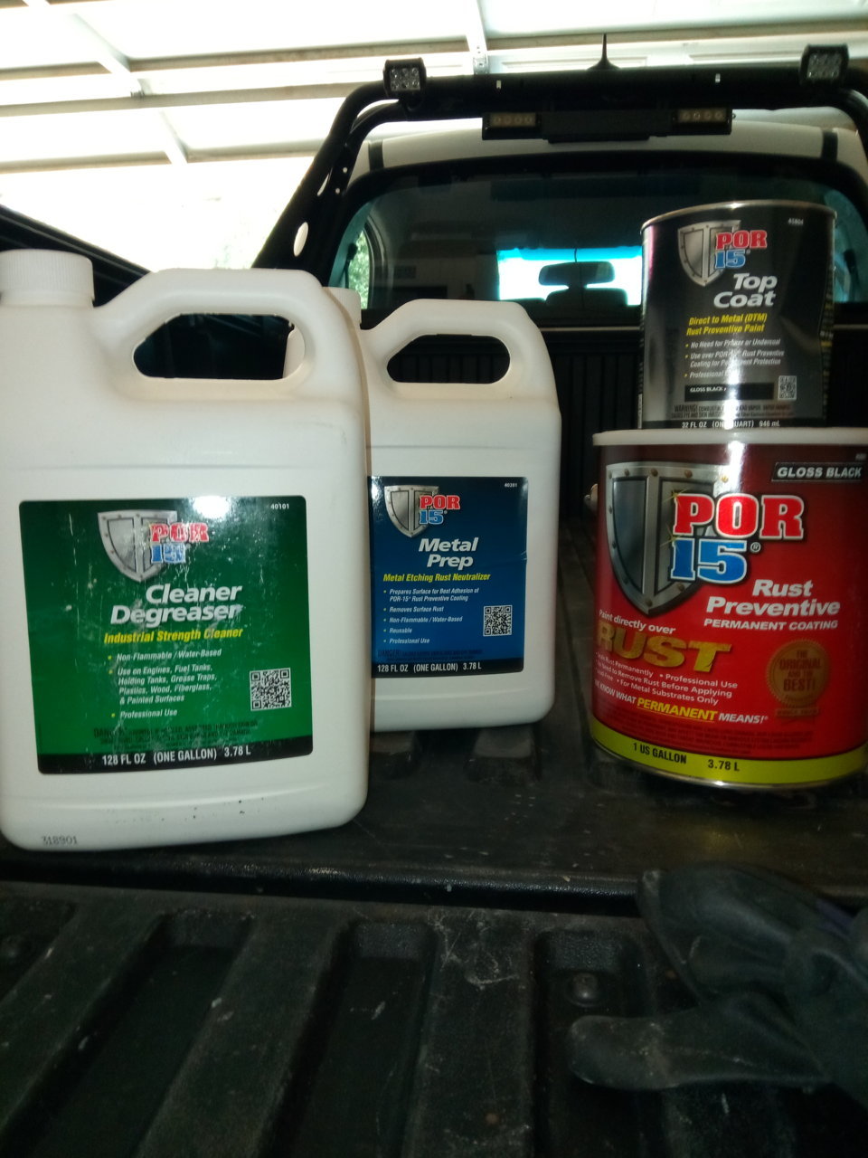

  15. Apr 6, 2020 at 8:49 AM
    #215
    UOFan
    UOFan Well-Known Member
    Jun 16, 2012
    #80791
    232
    Bryan
    NC
    1994 Single Cab DLX, 2013 TRD Sport, 1999 Dodge 2500 360 V8
    5100 Lift + AAL
    Have a few questions for anyone who's done something like this. Planning on doing a less-intensive version of this as a bandaid, later towards the fall i'll do this whole method, hazmat suit and all.
    1. I have a bunch of extra PB Blaster...would this be useful at all for aiding in rust removal with a wire brush?
    2. Is it worth using a Dremel/wire toothbrush/scour pads instead of a grinder, to make it simpler to get the hard-to-reach places?
    3. From what i've been reading the quick method looks like this: Remove Rust - Degrease - Coat. Is this correct?
    Thanks guys
  16. Apr 8, 2020 at 1:18 AM
    #216
    SaphiraTaco
    Feb 8, 2018
    #243869
    483
    Sean
    Seattle WA
    2013 DCLB TRD Sport
    If you fully commit to the POR 15 products then after the degrease is the metal prep(acid etching)
    This is import if you want to stop the current rust chemically. I have also used POR 15 on new steel. Happy with the results so far
    Ahhhh and UOFan like this.
