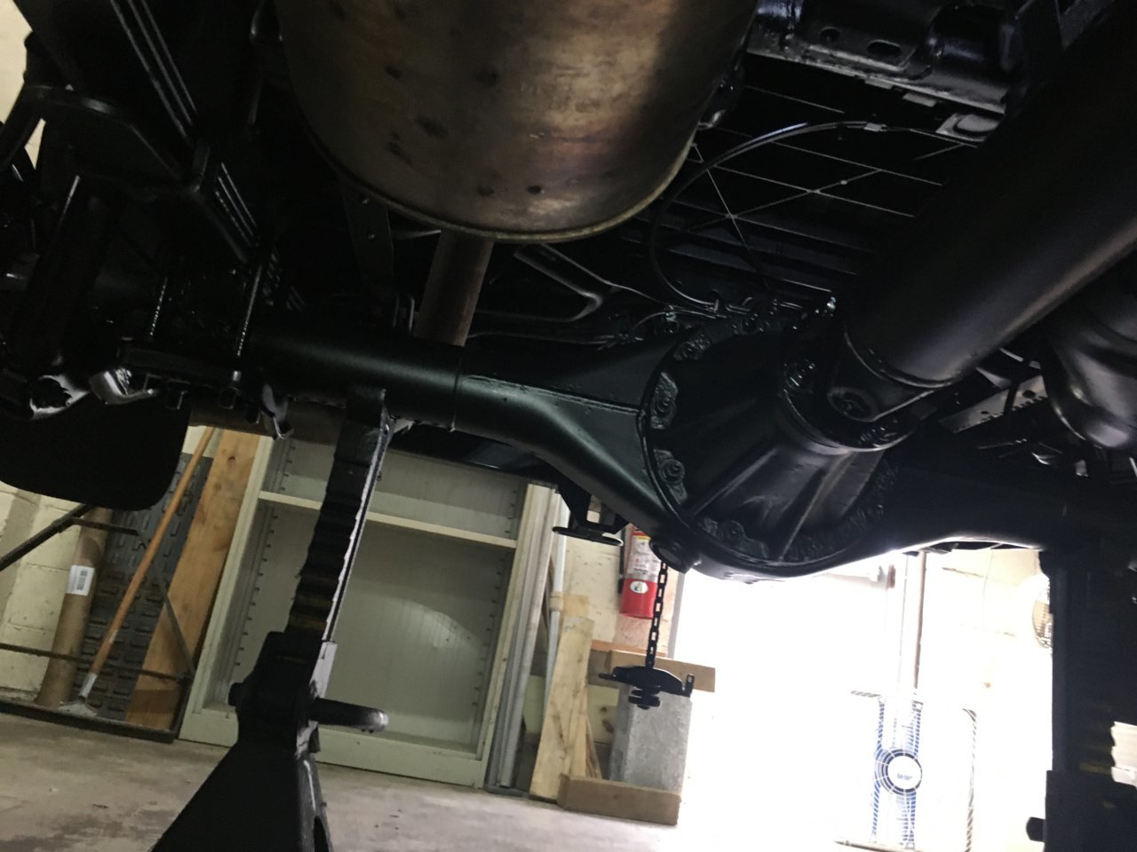

  6. May 5, 2020 at 12:19 PM
    #226
    itsmebags
    itsmebags Well-Known Member
    Nov 25, 2019
    #311700
    63
    Germantown, NY
    2003 Green Tacoma TRD Off Road
    Did my frame and undercarriage these past two days. A whole lot of work but very happy with the results!
    1) Needle scaler/wire brush to the frame and anything I could hit
    2) Degrease
    3) Eastwood Rust Encapsulator (I am absolutely covered in it...whoops)
    4) Eastwood Chassis Paint
    Took about a day to prep and then another day and some change for the paint. I brushed it all on. So def took longer but didn't have to worry about overspray.
    Used 1 quart of the Encapsulator and even did two coats. The Chassis paint is way more watery and went through about 1 and 1/2 quarts for two coats.
    If anyone is looking to do theirs I will gladly sell/ship the Encapsulator! Save some bucks on the project!
