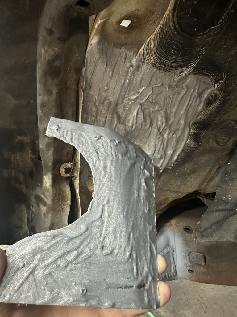

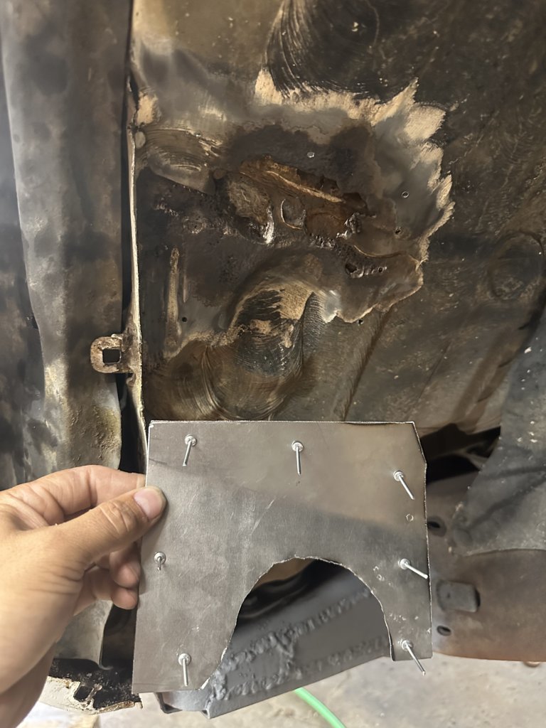

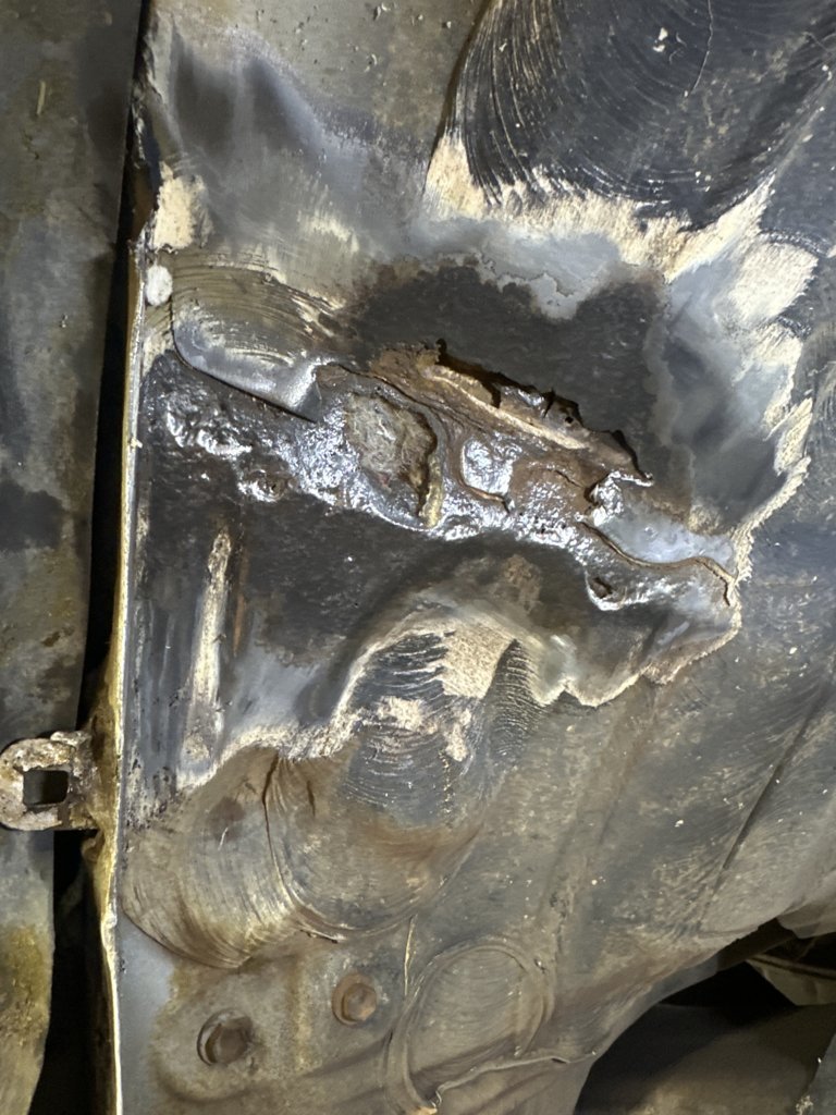

    I have however found a second Rust location, while replacing my antenna under the passenger aide fender. have not seen documented so here goes. It is on the front passenger wheel well about half of the way up to the top of the arch on the rearward side, where the seam is to the firewall. My truck does not have the creamy coloured fender liner coating over the entire metal wheel arch structure. Maybe it was a monday morning truck. Its there, just not 100% there. And this is where it rusted. There is a seam there that has rusted as water wash has gotten in from the wheels. It’s actually perforated all the way through to the underlay on the inferior side of the fire wall, and above, into the engine compartment.
    I looked to see if I could easily remove the carpet on the inside. Then I would weld in a little patch. However, this steel is very very thin. So my new plan now that I have wire wheel a nice good size patch, buy some thin metal 25 gauge it was, coat the acetone cleaned fender liner, and both sides of my patch, using rivets to “clamp” it together and the 3m panel adhesive will be rock solid.

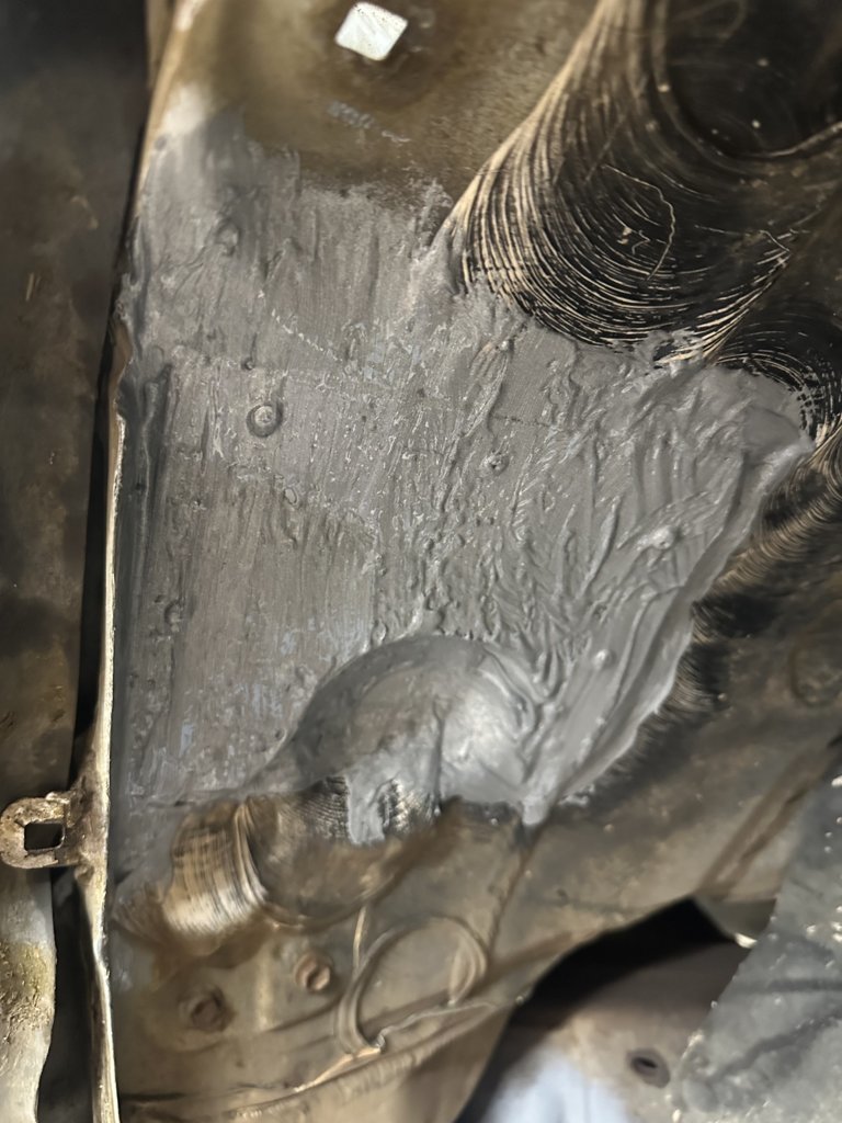

    the panel bond will be rock hard, and the rivets plus the bend formed into the panel made for a rock solid fit.
    Will probably spray with some sort of abraision /wheel wash resistant coating like a tar after this. I think the panel bond will be fine, but id rather clean and reapply a sacrificial coating a couple times per year than redo the patch.
    Also, inside the engine bay, where the firewall meets the arch, its all filled in with panel adhesive (its an epoxy). All fixed up
