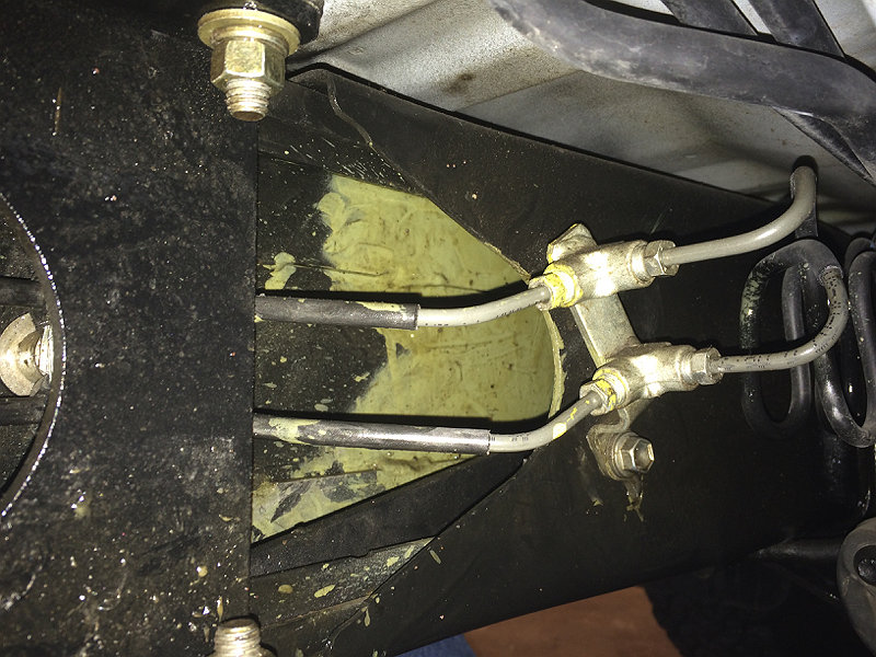

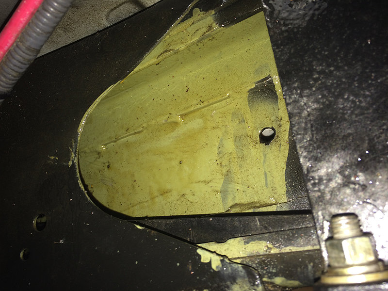

    I sprayed this down the boxed sections of my frame. Unfortunately there's no way to really, really clean the scale and debris. I washed the crap out of the insides using high pressure spray and air but figure on using a couple of thick coats to basically just epoxy whatever's left in place. I used I think 2 cans on each side, but that was excessive. Three cans is probably more than enough. This stuff is thin, make sure you tape all the weep holes and openings and cover the floor under the truck since it will run out everywhere.
