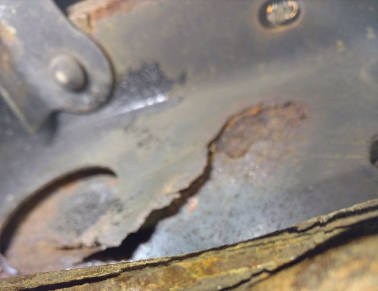

    We have a great concern at this point with our 2009 Toyota Tacoma Dbl cab, short bed, 4x4. Our Tacoma is used primarily to travel back and forth on highway and dirt roads to our camp at Long Lake each weak during spring, summer and fall months. We also use the vehicle to haul our boat, haul our small J.D. tractor on a tandem trailer and to hunt and fish. The vehicle only has about 56,600 miles on it but I have repeatedly been troubled by the truck’s frame with increasing evidence of deep rust and corrosion. I am now concerned the frame may actually break and since I haul trailers with the truck it could be disastrous to have a frame break during this type of service. The pickup might come apart and cause personal injuries, property damage or even death to us or people in oncoming vehicles if
    this were to happen while we were hauling the boat or our tandem axle trailer it could be devastating on the highway. My VIN ends with 9233???
    What can I do about this, I received two cards, should I contact dealer myself or should I wait till I get something from Toyota?

    Take it to the dealership and tell them you want it checked on the recall.

    Thanks, don't really know what else I can do? Will Toyota be notifying customers about going to the dealer? My dealer is not really close, being way up here in northern Maine.

    I got a recall letter, of course AFTER I did this to my frame. I went under the truck and checked it personally since it's pretty easy to see if there are holes or thin spots using a small hammer.
    You can always call the dealership and talk to them about it.

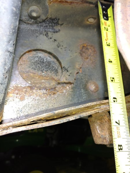

    Well I have never received a recall notice on my 2007 OR I've read that the inspection period is over so I started cleaning my frame. I bought a new compressor and needle scaler and so far it's working well on flaking rust but what I thought was a one inch crack on the inside frame coming off a punched hole by the cat is about 3 inches after using the needle scaler. So it looks like I will need to do some welding before I start cleaning again.

    Welded it up and cleaned,rust converter,primed, painted and under coated looks great.
