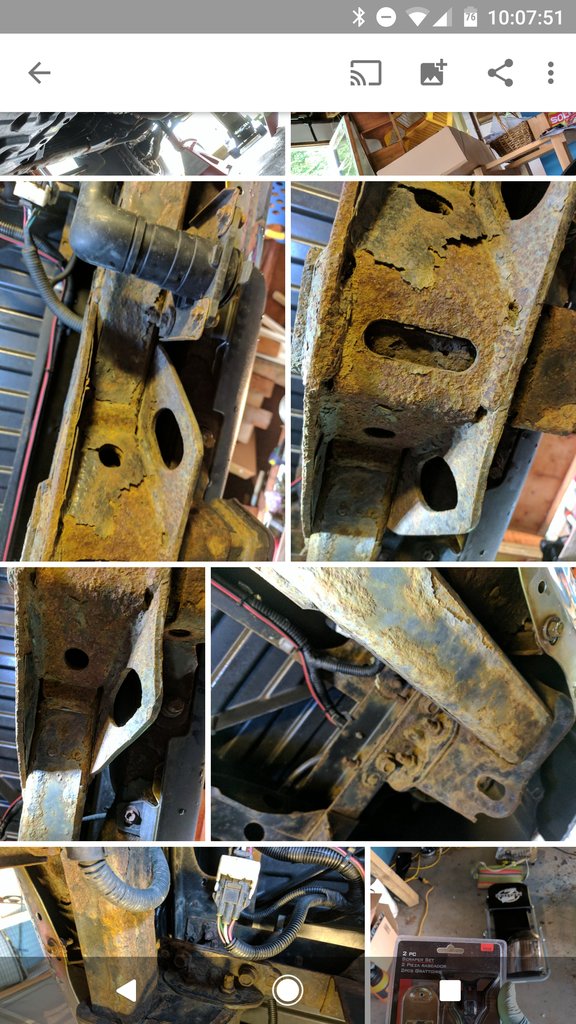

  11. Sep 14, 2017 at 2:51 PM
    #151
    Dangorah
    Dangorah Well-Known Member
    Mar 22, 2017
    #214067
    247
    Dallas, TX
    Can you apply POR15 over bolts and rubber parts? I'm now trying to coat those but if they get some POR15 on them while I am painting the main components will that cause any trouble later? I am worried about bolts seizing together with the POR15 or rubber deteriorating because of POR15. I plan to do this to most of the major components and the frame of my truck.
    I'm more concerned with the front portion of the vehicle where the ball joints meet the control arms etc.
  12. Sep 25, 2017 at 6:10 PM
    #152
    redbull9944
    redbull9944 Well-Known Member
    Oct 28, 2013
    #115443
    969
    Southwestern PA
    ‘24 LC250 First Edition, ‘25 TRDOR 6MT, 2016 DCSBTRDOR Inferno 6MT, 2004 Double Cab 4WD Project
    Prinsu Rack, 275/70R17 Cooper ST MAXXs, TRD PRO 4Runner Wheels, 5100s
    I would tape off bolts. POR 15 is very, very strong. Once it gets on something and is cured it's hell to get off.
    I would assume it would wear out rubber components, too
  13. Sep 25, 2017 at 7:44 PM
    #153
    Dangorah
    Mar 22, 2017
    #214067
    247
    Dallas, TX
    Awesome. I'm putting it on now. I taped off rubber and threads/bolts

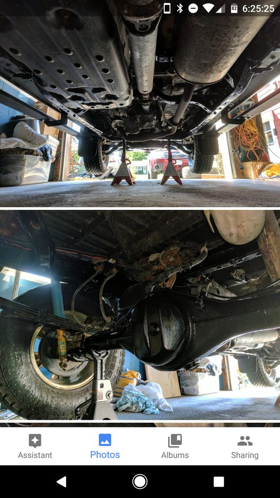

  18. Oct 1, 2017 at 1:11 PM
    #158
    Dangorah
    Mar 22, 2017
    #214067
    247
    Dallas, TX
  19. Oct 2, 2017 at 12:31 PM
    #159
    SeNate
    SeNate [OP] Well-Known Member
    Dec 12, 2011
    #68619
    129
    Salt Lake City
    05 SR5 TRD 4x4 6spd
    Satoshi Grill (HomerTaco), Ambiguous' headlights, refinished my frame with POR-15 after half a week of prep and rust removal
  20. Oct 2, 2017 at 4:49 PM
    #160
    Sasquatchtaco
    Sasquatchtaco Sasquatch Taco
    Feb 21, 2016
    #178916
    1,689
    Catskills NYS
    09 MGM DCSB 4X4 TRD
    Too many to list.
    You're gonna make me do mine over...and I just did it. Looks awesome!
