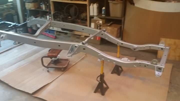

    Props to you for doing it assembled. I like to strip that bitch and do it bit by bit. Good work!FB_IMG_1493772918740.jpg
    This is the new frame in progress (at the time) for my 1985.

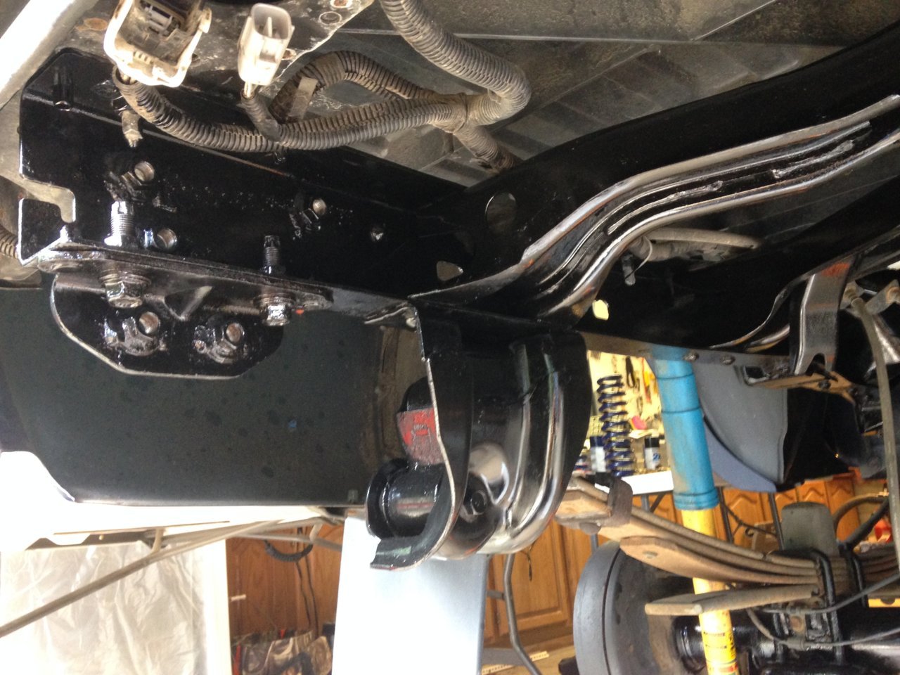

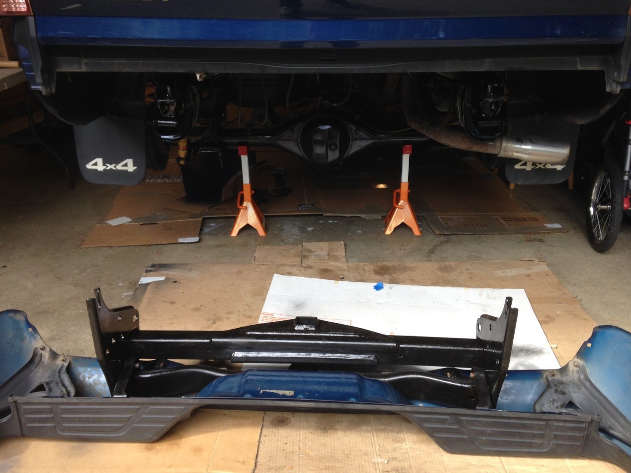

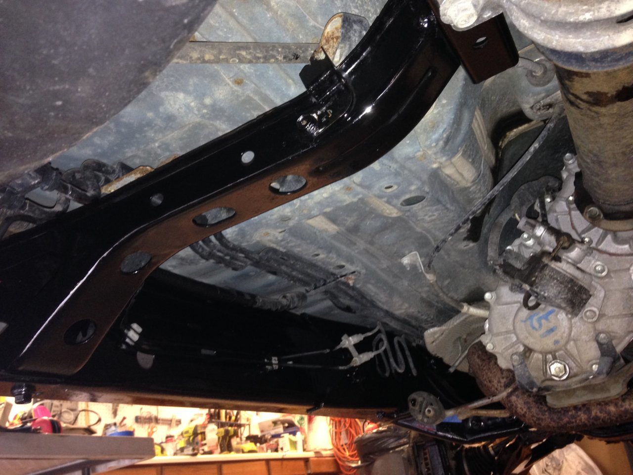

    About halfway done...

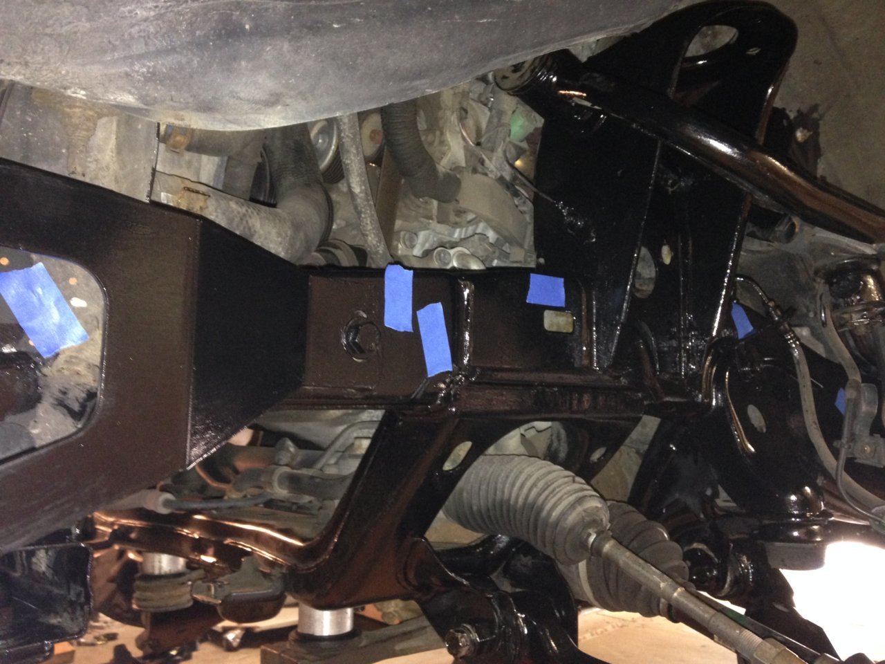

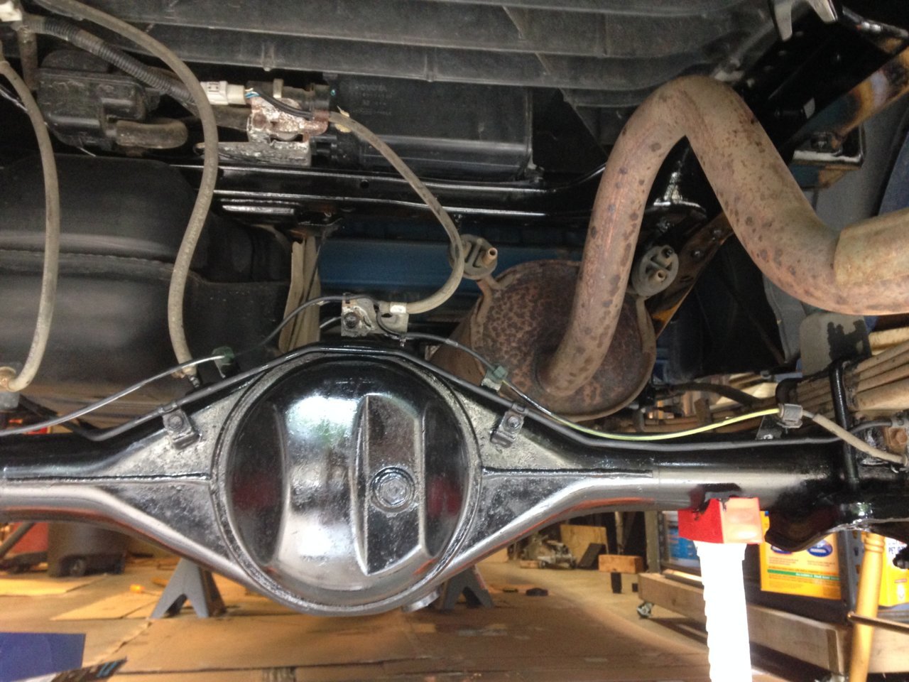

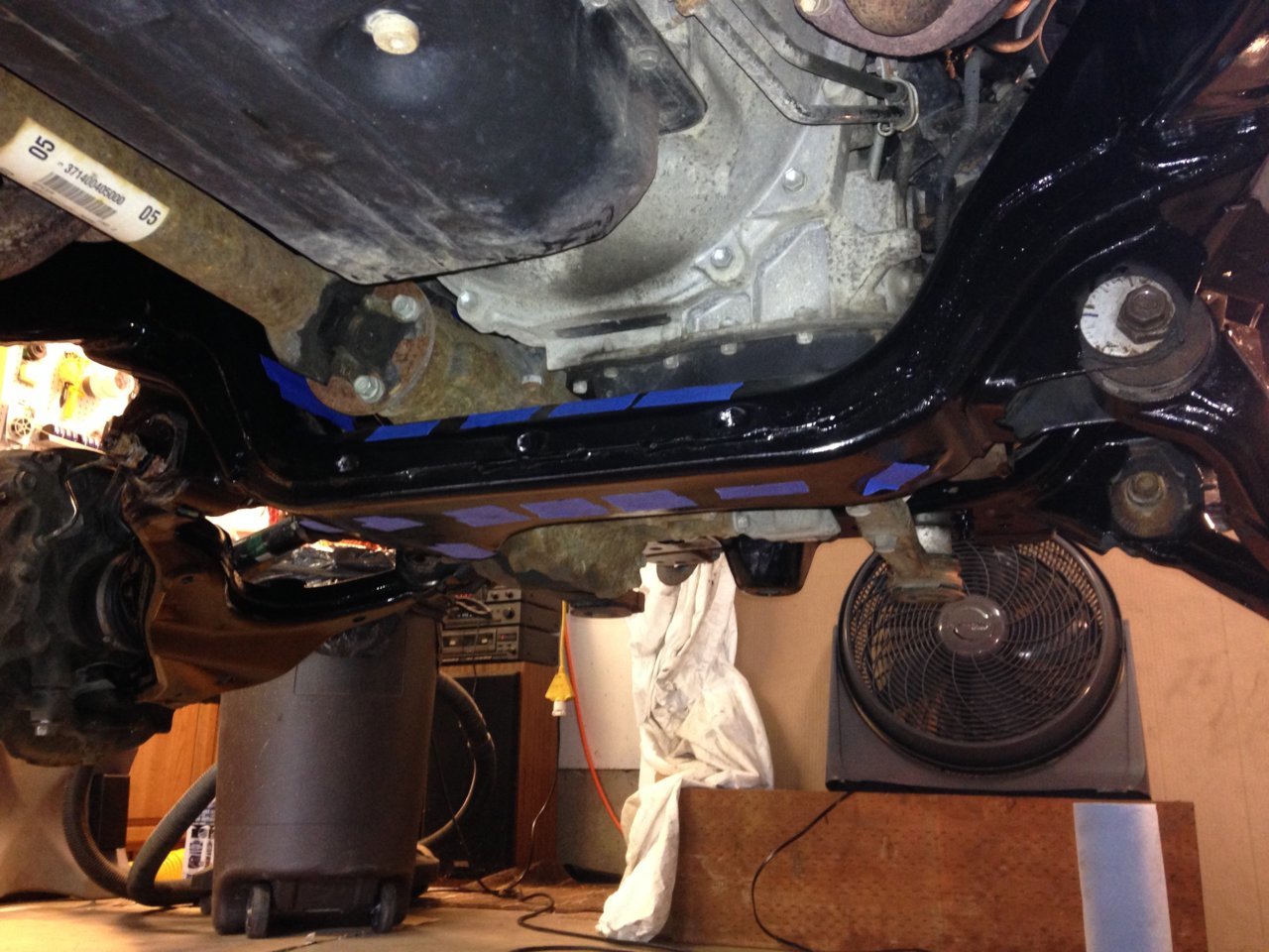

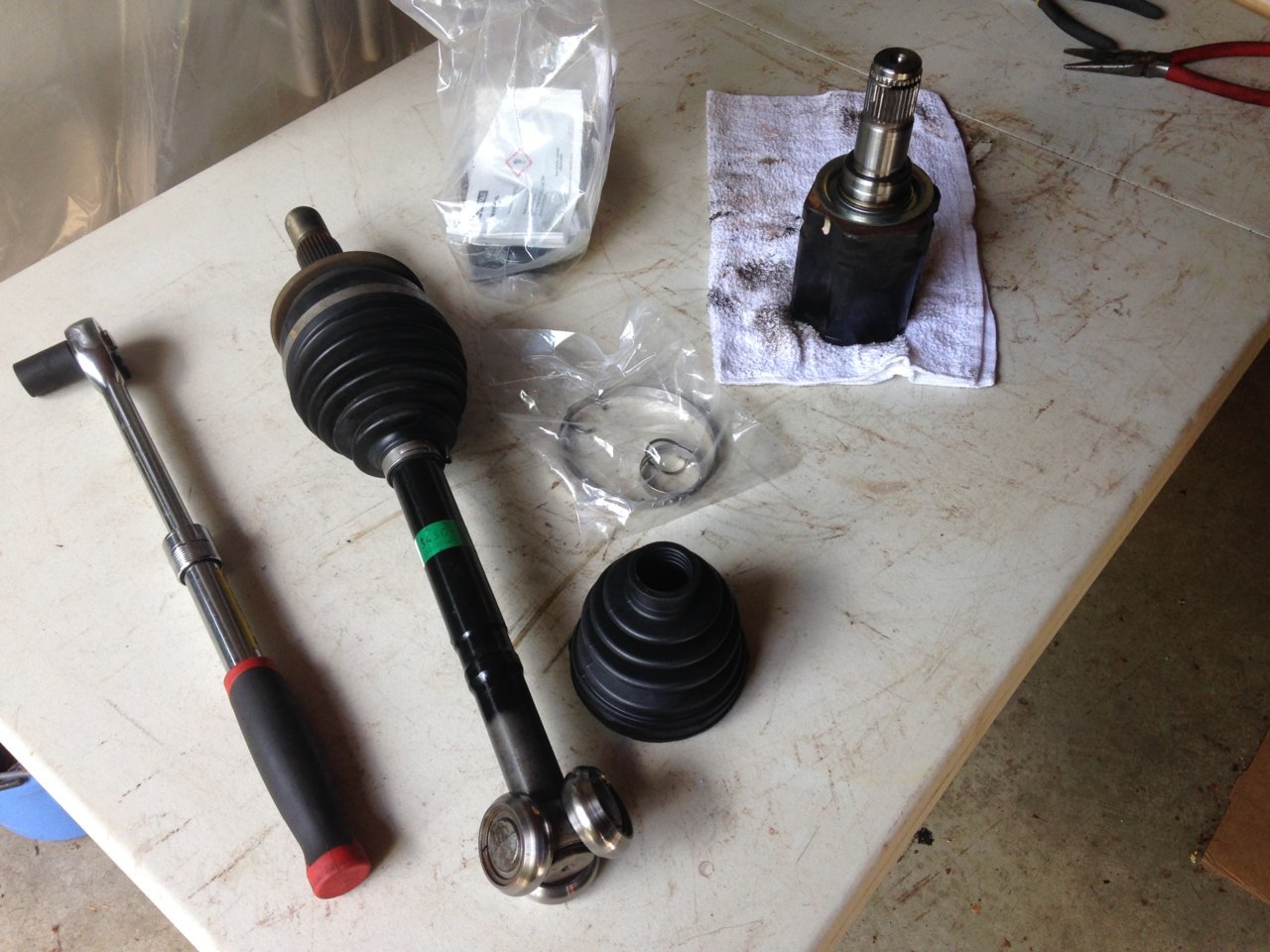

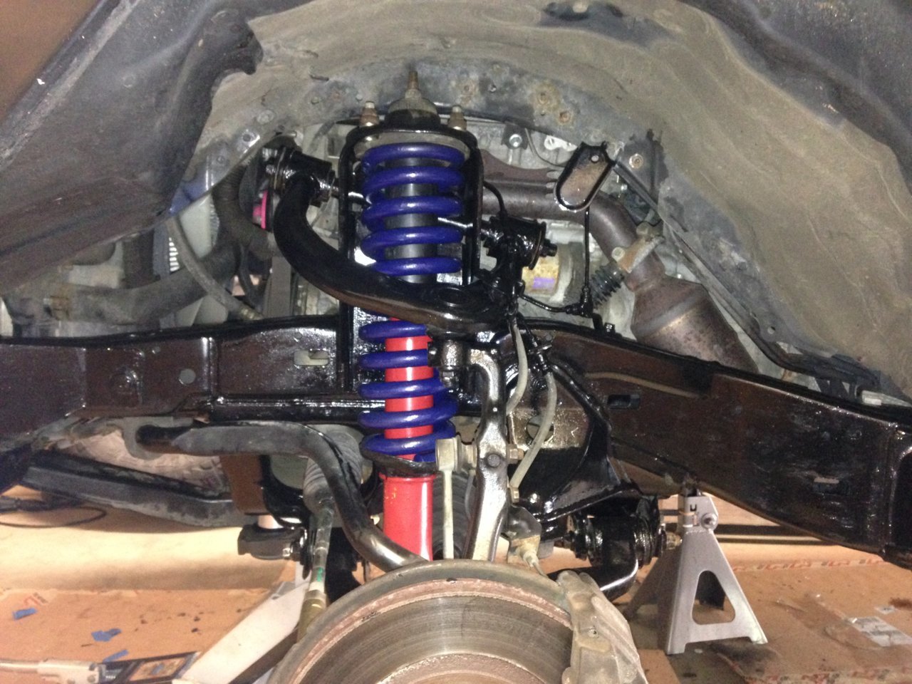

    I want to start by thanking the OP. :bowdown:I would not have thought this was something I could do myself. That being said it was a lot of work. Because I had already purchased my next truck I could take my time, about 2 weeks. Front coil overs and a CV boot also needed repairing. Disassembled rear bumper fully to get everything clean.
    I took on this frame restoration project to clean up the truck to sell. The rusty frame was really the only thing that looked bad. Guess I have more time than money.
    Funny story, I had my Dad visit and give me a hand. At the end with the whole frame glistening brand new, he said "maybe I should buy your truck"
    So now this lucky truck gets to stay in the family:)
    Can't find before photos. I estimate the rust was about half as bad as OP truck.
    IMG_4113.jpg IMG_4117.jpg IMG_4118.jpg IMG_4124.jpg IMG_4127.jpg IMG_4128.jpg IMG_4138.jpg IMG_4139.jpg IMG_4154.jpg
    Work Notes:
    Air needler worked great. Need a good air compressor. I noticed lack of performance after air tank emptied.
    Ospho metal treatment went on ok. Should refresh the container used for dipping foam brush frequently. Some drips got past my cardboard around the jack stands and burned garage floor:(
    Por-15 went on ok. Whatever Amazon foam brushes I got turned floppy real fast. I did use a chemical grade respirator but surprisingly the Por-15 Didn't smell too bad. Two coats was applied as the Por-15 is pretty thin.
    Working upside down was a bit challenging. No acid or Por-15 on the face:muscleflexing:
    Eastwood Internal Frame Coating was very rewarding. The fastest part of the project! The spray nozzle worked perfectly.

    Correct. Dropped spare tire and removed the four rubber wheel well covers in the front. I also had the coilovers out for service and removed the sway bar.
