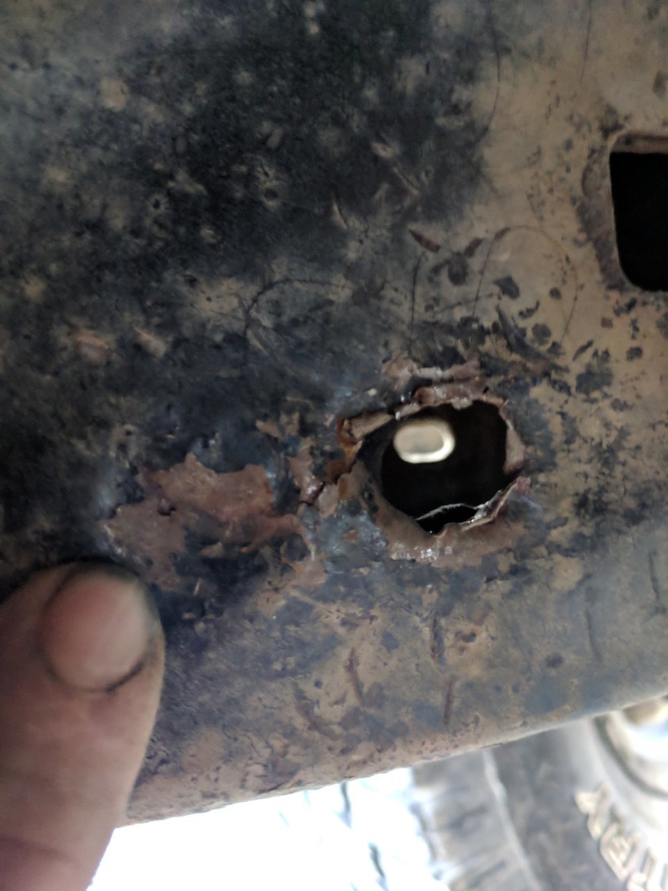

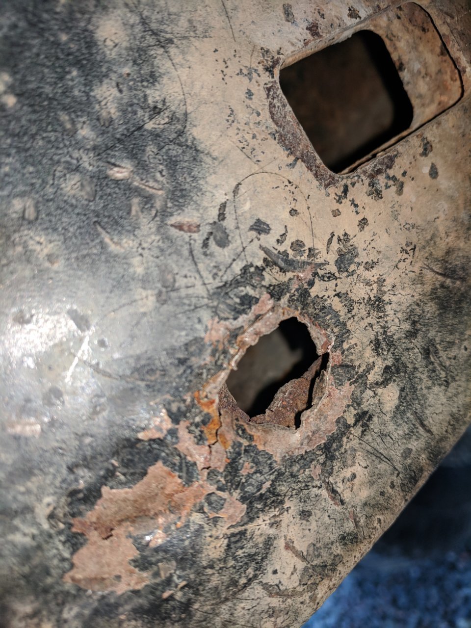

    Here's a few different views. First pic shows another compromised soft spot next to my fingee where the inside is rotten and a crack leading to it from the exposed hole to the right. Looks fine outside but it is paper thin and I could take a SAK can opener to it and fillet my frame. Just pushing it with your finger causes deformation/flex.
    Whats odd is the manufacturing hole in the top right is still thick, over 2x thicker, and shows no signs of deterioration.

    I think what happens to these frames and why you see so many holes in that area is the salt/brine/debris getting kicked up by the front tires, with it being stuck between the 2 metal layers. The heat of the catalytic converters just accelerates the corrosion.
    I wonder what the thinking was of Toyota when they made the frame of 2 metal layers instead of just one? :confused:

    I agree. Combine with off-road use dirt and gavel fines build up inside the boxed section plugging the drain holes right below that spot and it just eats away where you can't see the damage till it's a big problem.

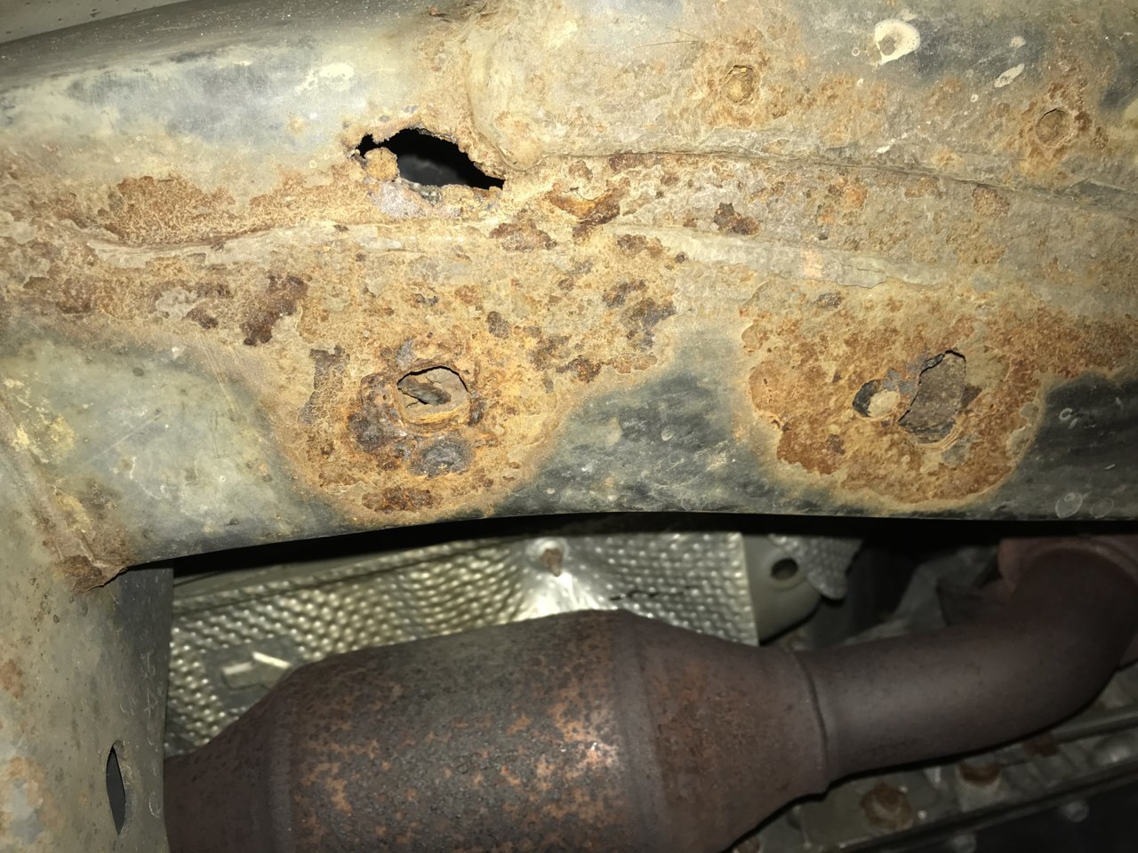

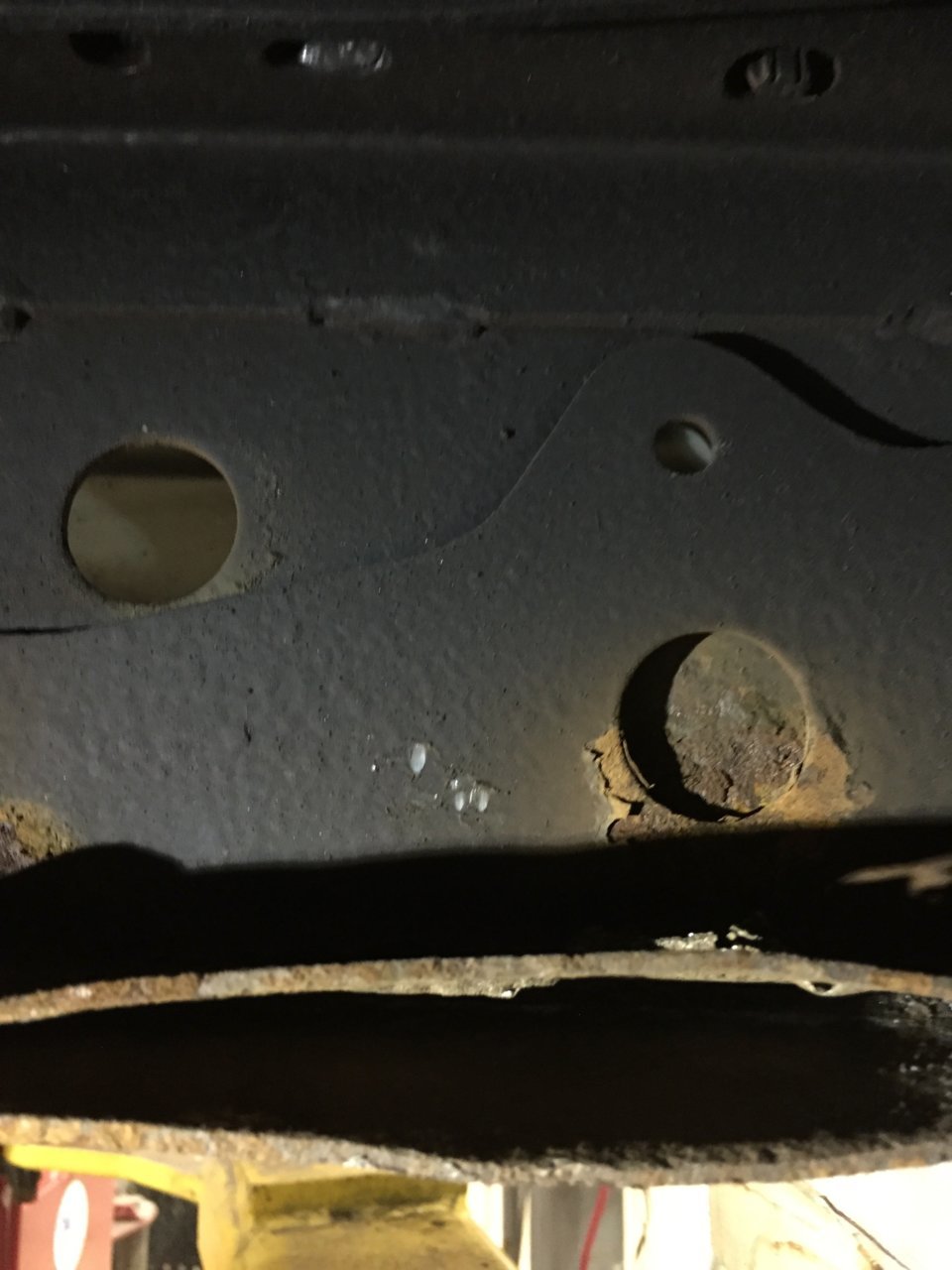

    Since then I have been inspecting my frame and exposed two holes. One is where there are two factory holes in the frame on the bottom side near the catalytic converter on the passenger side. I discovered the soft spots and was able to push through them with my finger. It measures 12mm without me trying to open it any further. The next was a place along a weld joint in the Same general area. This one was VERY soft and I was able to push through with my fingers and my little six inch square blade. This measures 20mm x 30mm. It is very scary how easily I found these places that I was certain were just surface rust. 49CD3609-465E-4CFD-8B67-0D1CA33836A4.jpg

    I can understand their hesitation with your claim. That hole doesn't look like natural corrosion. I am not saying that it isn't. Just looks "weird".
