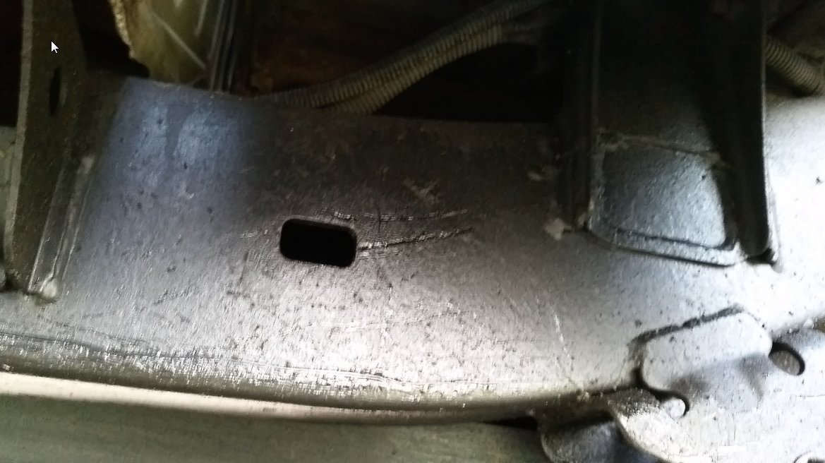

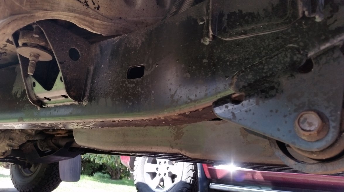

    Fluid Film does not "coat" as a paint, but creates a layer that is a little bit sticky (like a wet rust oleum paint) then the dust will cover the sticky surface without soaking it (like oil would do). Here is the picture of the frame (the sensitive part) 11 months after applying fluid film last year:
    The same area after fluid film was washed out (pressure washer with hot water and soap) before applying again for the next season.
    GQ7227 likes this.
