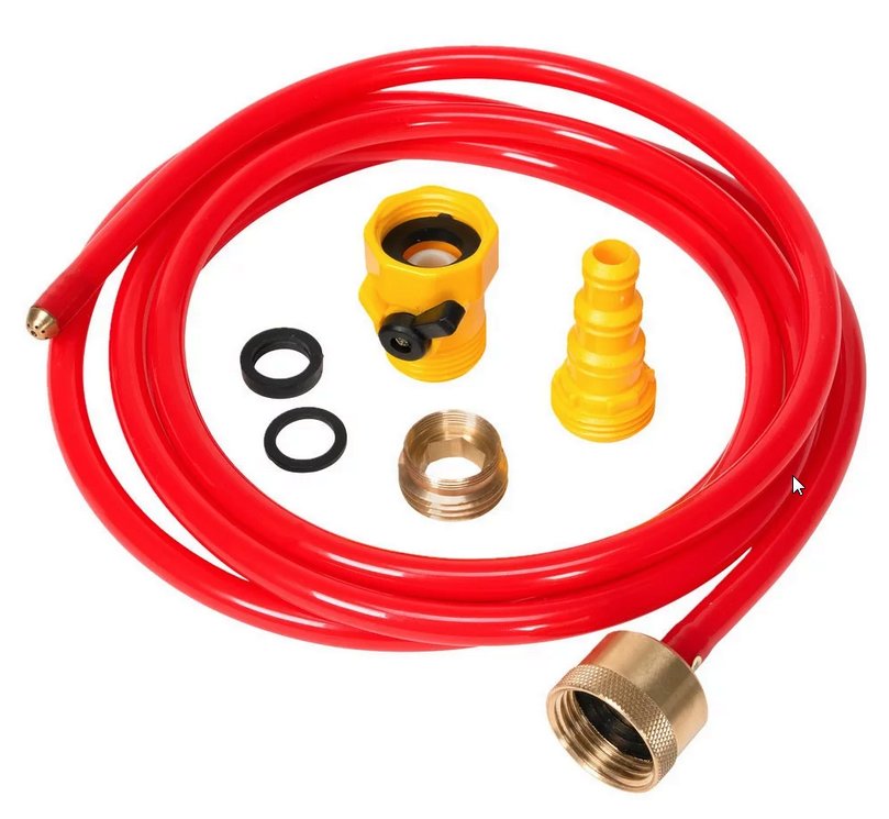

    I'm sure applying fluid film annually will not void the warranty (it is washable). I think the third gen frame is a little better designed for drain holes so the cleaning inside the boxed frame is not as critical as in 1st gen where if any brine goes in, it will stay forever unless it is forced out by deep cleaning.
    In my local Jula store (sorry, not available in US) I bought a simple drain cleaning kit (13 dollars) that basically is a 9-directions spraying head on flexible hose that can be connected to garden hose or even hot water tap.
    It is indented to clean drains, but will be good for cleaning boxed frames too
