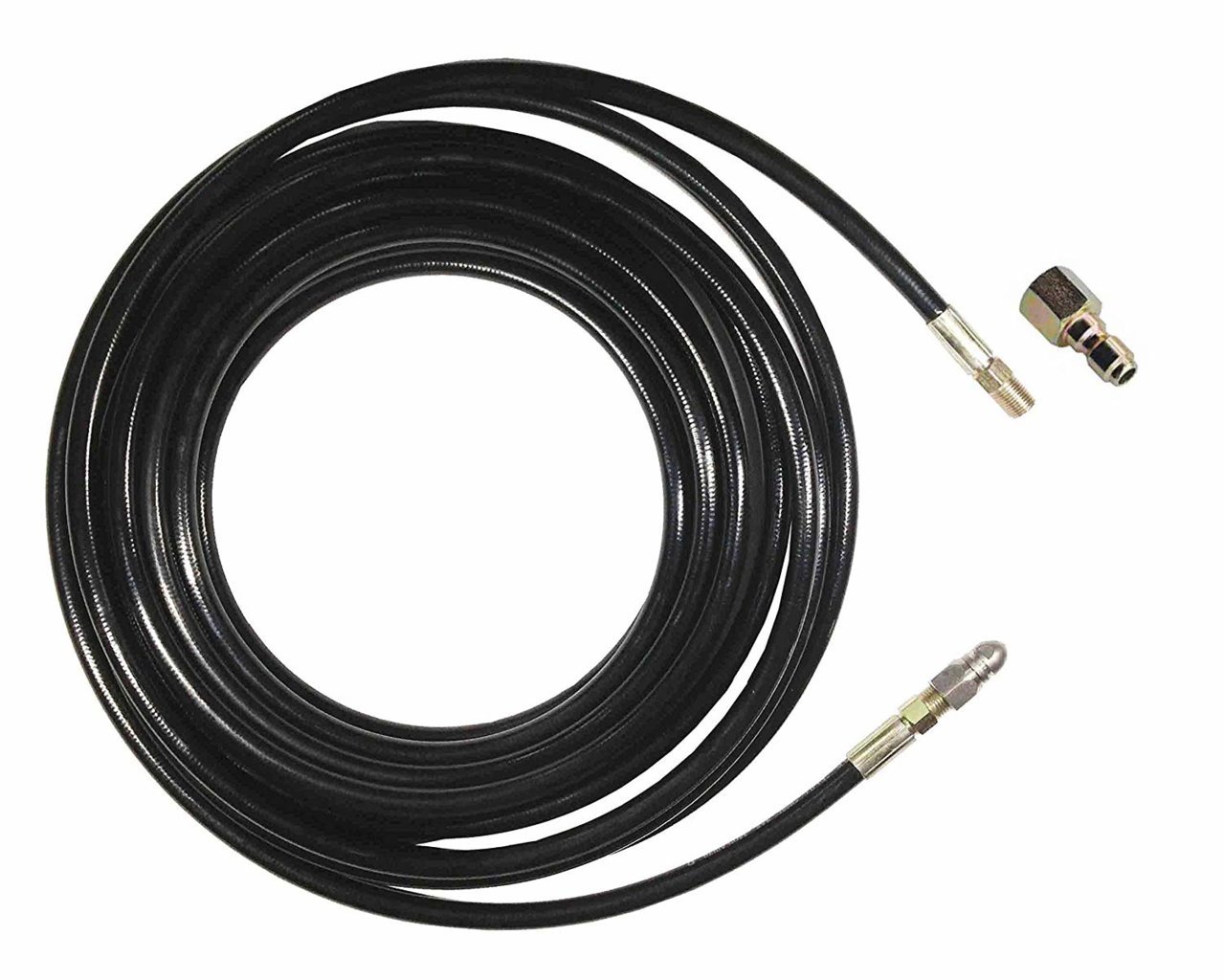

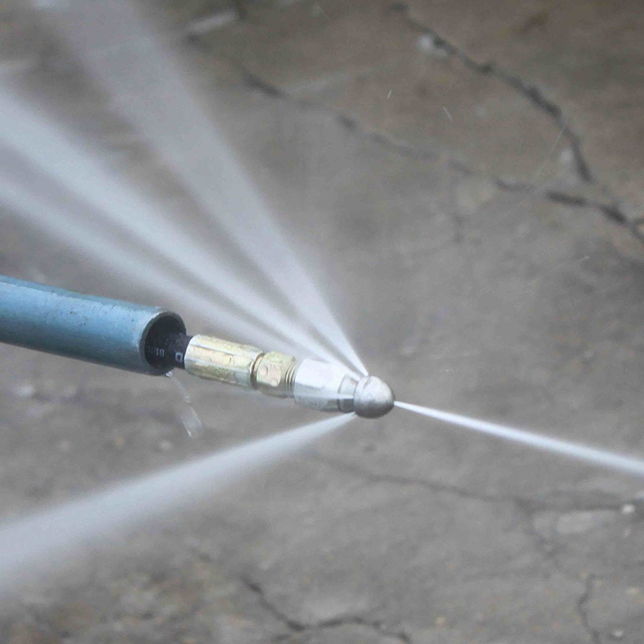

    Here is what I bought on Amazon: https://www.amazon.com/gp/product/B0070WTGZG/ref=ppx_yo_dt_b_asin_title_o05_s00?ie=UTF8&psc=1
    It has a 360 degree spray nozzle on the end of about a 3 foot flexible hose. It does a good job getting into the inside of the frame, IMO.

    That’s actually for cleaning sewer lines which you “back pull” so that is why the nozzles are facing backward, I actually ordered that same kit I’m gonna use also. But it should work just fine back pulling a frame to bust loose any debris because it’s the same theory as sewer line cleaning, just cleaning junk from a pipe essentially.
