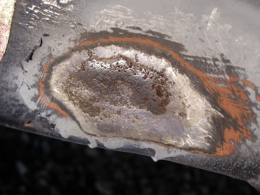

    This is the weld we're talking about
    Also I don't believe the whole frame was repainted. I can see primer overspray on the surrounding areas. This means the particular area was touched up. Primer is porous, it will NOT stop rust.

    OP , did you have and then remove weld on sliders mounted in this location ?

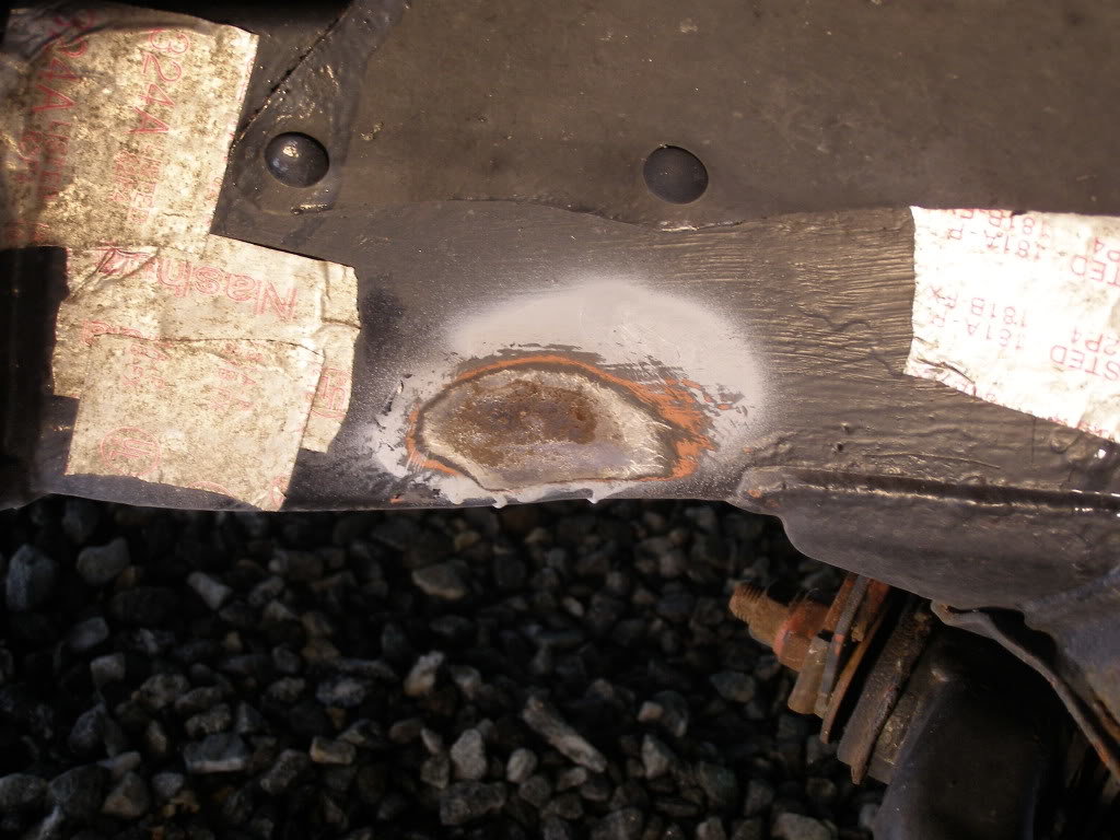

    But seriously I dotn even know how you can see weld there. its not a weld..
    I repainted whole frame there are even pictures on that forum of me doing it. The grey stuff on pic is a coat of paint I sprayed before I started sanding area. To make sure I dont damage main paint surrounding the rust.
    For those that ask iof there where sliders the answer is no. This is right behind the front wheel so nothing can be welded there. Its also on the side of the frame which means it could not get any damage. Still waiting for Toyota to chime in and say something interesting.
    There is no repair to that area, I dont know what gives you that idea. I am original owner and spent almost every year painting something on that truck. This area looked np when I did put the coat of paint on the frame around less then 3 years ago, there was no bubble visible last year, this year it was tiny bubble so I wanted to fix it, and discovered surprise. Truck never been in accident either. So no damage and no fixes.
    bigger pic to show where is that on he frame

    That without a doubt looks like welds ground flush but lack of penetration in that one spot.

    With the shadowing of that gap def looks alot deeper than paint, u modified ur truck and now have a problem... Suck it up and fix it urself

    What is going on with that cut in your frame?
    Also there is some shiny rough textured metal right above that in the second picture but in the first it's black.
    What's the deal?

    Naaaa... it could be a run in the goopy paint stuff he's slathered all over it, partially sanded away. Look how thick it is in the pulled- back shot.
    It looks to me like he covered a small spot of rust with his thick paint coats and it continued to rust underneath, so now he has pitting. Really common and the reason the Ziebart process never worked as advertised Unless there is rust-through (which he's not demonstrated) Toyota will do nothing..
    Just treat the area with phosphoric acid rust remover and prime/paint again. Then keep a close eye for more hidden bubbles with rust underneath.
