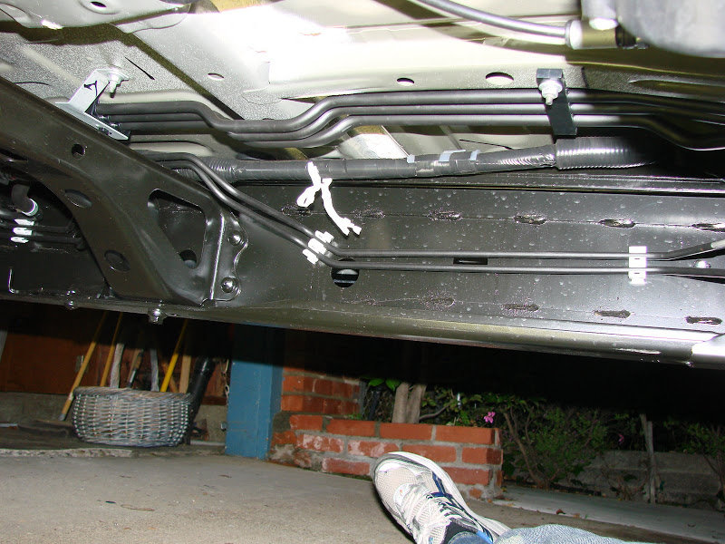

    I don't have any good pictures right now... I am going to take pictures soon because I am going to completely paint my frame and axle housing. But to give you a general idea of what is going on is some surface rust developing in specific locations like a rash. It's worst in the following locations:
    1. Rear spring perches
    2. U-Bolt plates
    3. Rear spring hangers where riveted to frame
    4. End of axle housings
    I agree with Oswego in that the weld points are a source of concern. See the stitch welds on the inside of the frame rail? This picture was when the truck was brand new. My stitch welds have some rust on them now. I think this is a defect in the manufacturing process. If the frame was coated properly, then rust should not develop. The axle housing paint is on par with the rest of the Toyota frame paint. There is plenty of surface rust forming there as well.
