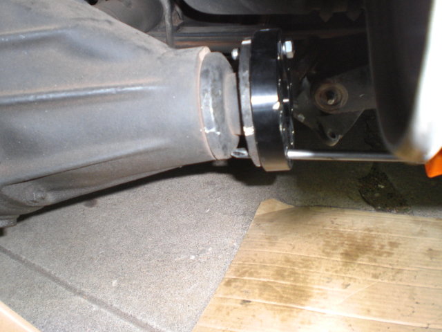

    Thats reason they have those spacers.....to push whole drive train forward 3/4....up to 1 1/2 in..........

    That's interesting it's on the rear end that wouldn't help mine because the center support bearing . I plan on installing mine on the transmission end ???

    You have to have a yoke design to bolt it in......
    so yes on non slip joints should be able to use anywhere.....
    Same on the carriers.....there are some fancy poly carriers made for f150's I think....
    and because its a large inverted bracket that has to be modified to fit by cutting...drilling...so spacers/adapters...
    these are used for the big lifts....because they are so adjustable.....
