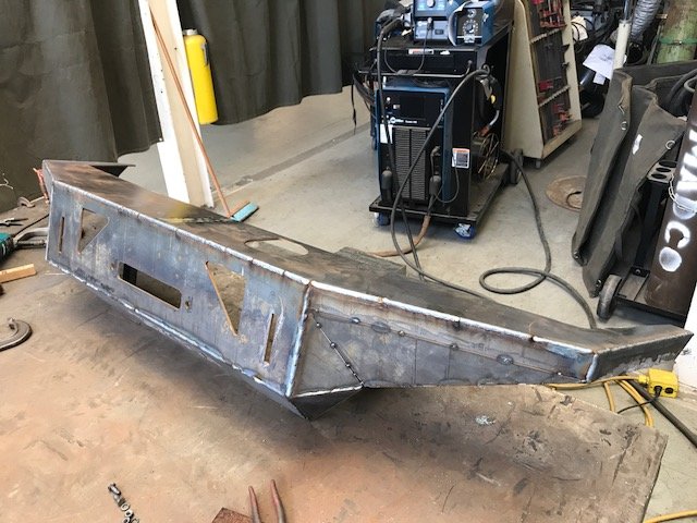

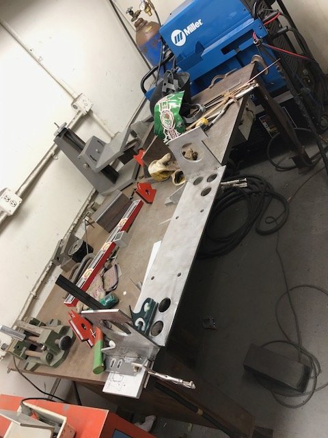

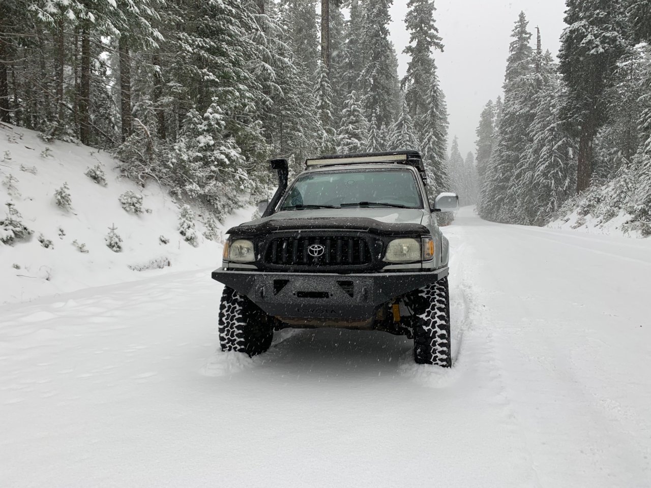

    I've been working on a front bumper for the Taco. I used a lot of dimensions that were given to me from a TTORA member.
    I inspired myself from a 2nd gen bumper I really like.
    I'm sure someone will figure what bumper I'm talking about.
    I'm terrible at updating threads but I got a good picture of the truck the other day with the bumper.
    Updated 12/3/19
    Took me a long time on solidworks to get to this design.
    71A77F45-842F-46A8-9DF4-355C40022BC2_zps_c29cbe4fa5e6f654e24c59f60376abe1873d23de.jpg
    Finished the bumper long ago.
    I'm modifying a couple things so the winch fit. Will add more pics.
    Wish I documen ted everything on TW but I'm lazy.

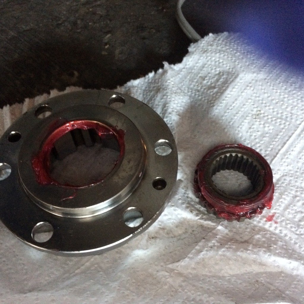

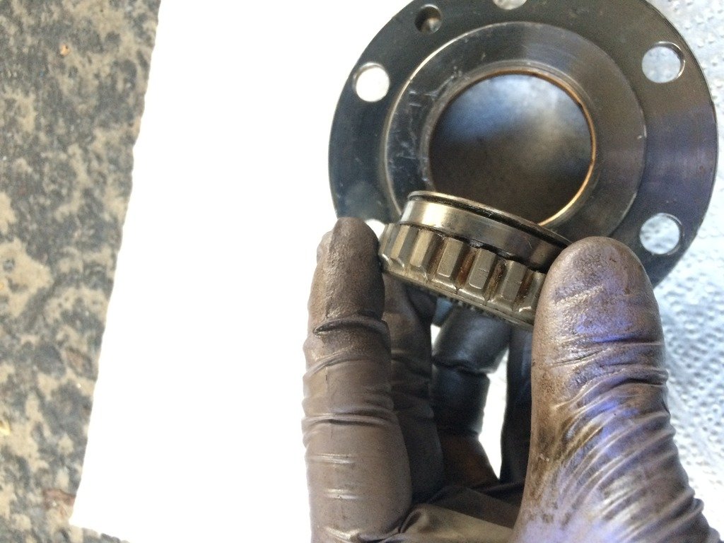

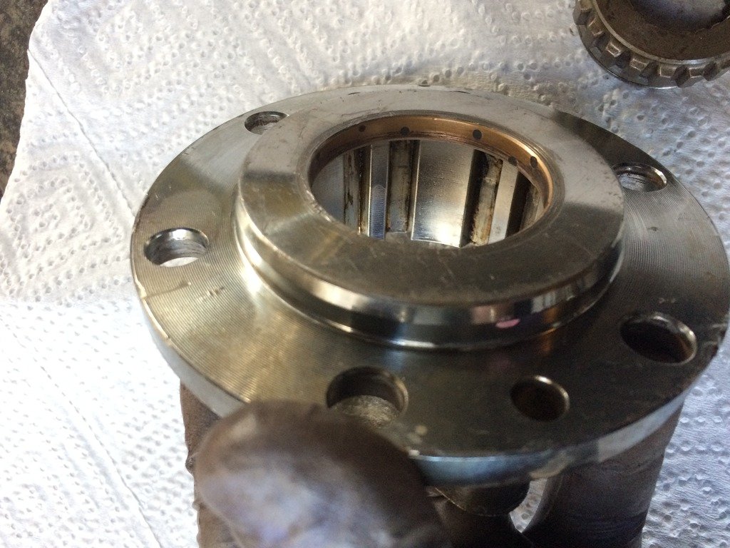

    Here is just a little something on manual hubs that might help someone out searching the forum some day.
    If you are experiencing a squeak, squeaky or screech noise it could very well be your manual hubs. I was experiencing this specific noise here in the video.
    I did process of elimination. Took caliper off. Was still making noise. There are 2 things that spin. The wheel bearing or the manual hub. I figure it couldn't be the bearing so I took the hub apart.
    th_2C91EADA-EB7D-453A-92B7-A96FFD54FDD9__7c7bdc3e508650a8222ab1bd48e9324cdea57714.jpg
    I didn't grease this part when I converted the truck. I didn't want to take the snap ring off.
    Although not a ball bearing, these two surfaces are considered a bearing. When the hubs are unlocked, the shaft spins and this is where it spins at in the hub.
    9A636B87-4B88-48E3-9831-A7853EFDFB87_zps_1064718a78c18bc945202761aab7c8ae2f48cb42.jpg
    Close up of the copper or brass ring that needed to be lubed.
    83931B6E-DAFA-493C-879B-97242D18931F_zps_5ff3001c7f5dd481d9eb511c8b620672ac7fc2df.jpg
    A lot of people say "Don't use so much grease". I really don't care. I applied a good amount and hopefully wont have to get back into it for a while.
    Cleaned out and lubed up.
    3A6D9103-2670-40CA-8E86-91CCF38DBFC1_zps_82ff81c2b50d0d997b78be2af621159ad2a75821.jpg

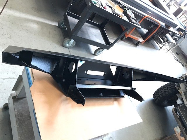

    Been slacking on updates.
    Will right detailed update on truck soon.
    Here are bumper pics. Been done since august.
