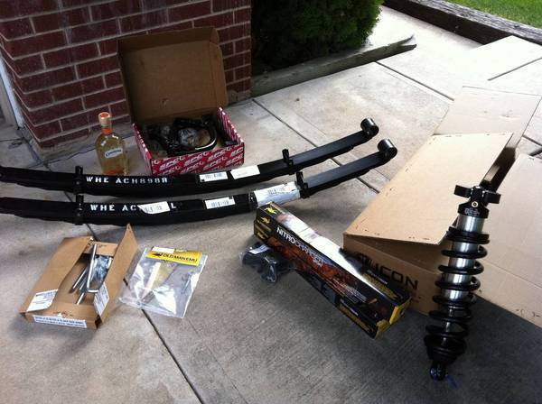

    The old suspension was quite tired. Time to find it a new home. Here's what's going in:
    • IVD front coil overs
    • Light racing UCAs
    • Alcan 8 leaf spring packs
    • Timbren bump stops
    • OME Nitrochargers
    • ProComp stainless brake lines
    • EBC slotted and drilled rotors, EBC pads
    • .5 pints of blood
    • 1 bottle of tequila, level of which will be inversely proportional to my frustration level

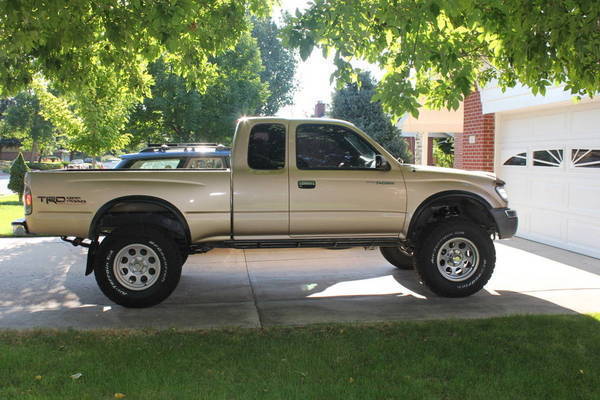

    she's rolling again! after a long week of late nights and cancelled weekend plans, it's mostly done. Took it out for a quick spin around the block after getting it all put back together late last night, what a difference!!
    I will get a write up and pics posted later but I wanted to give the popcorn eating gallery an update. Need to book an alignment today and see if the shop has a spanner wrench to up the coils in the front about another .5 inches to level it off just a bit more. Hopefully won't lose too much ride quality, but should be ok from what I've read about the IVDs.

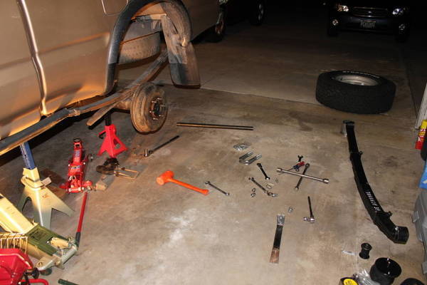

    Starting in on the rear springs/shocks:
    The spare tire was the first hurdle. Previous owner had spare tire lock but the lock key was not with the jack handle. Out of some kind of divine luck, a buddy had the right one. Only set me back 1 day...

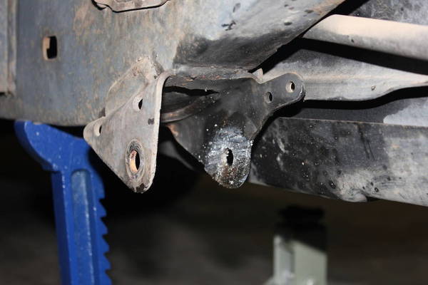

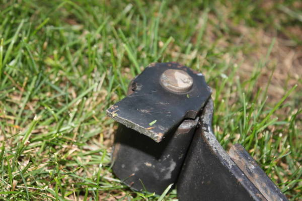

    Springs were a bit rusty and lodged. No amount of PBR was going to free them up. Bring out the sawzall/hacksaw/sledge/prybar:

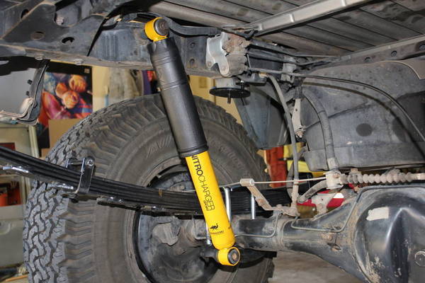

    Rear springs/shocks are in! The Timbren bump stops didn't have the washers included and one of the studs was a bit short. Not a huge deal to rectify.

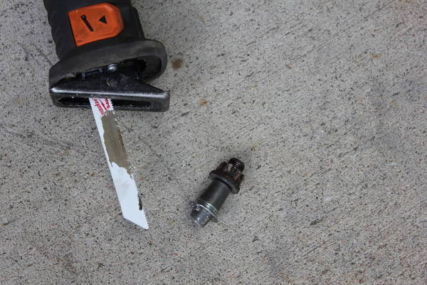

    Had to cut off the ball joint stud to get my shorter 2-jaw puller over a socket to press out the joint from the steering knuckle. Props to the missus for holding the ball joint stud still with some channel locks while I sawzalled away!

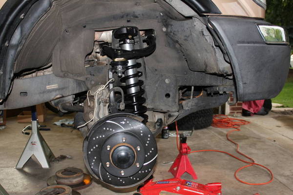

    Light at the end of the tunnel - new drilled/slotted EBC rotors (GreenStuff pads not shown)
