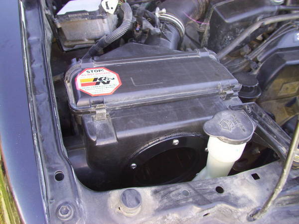

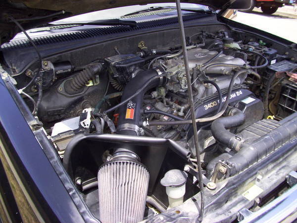

    So about 3 months ago, I bought a K&N CAI off a buddy of mine for really cheap and intalled it my self.

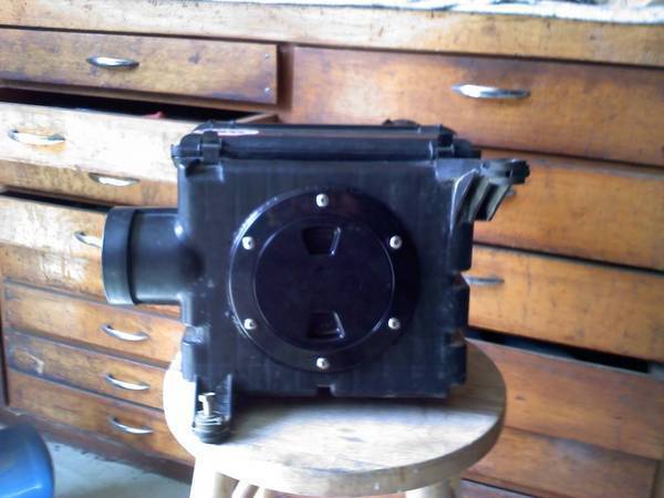

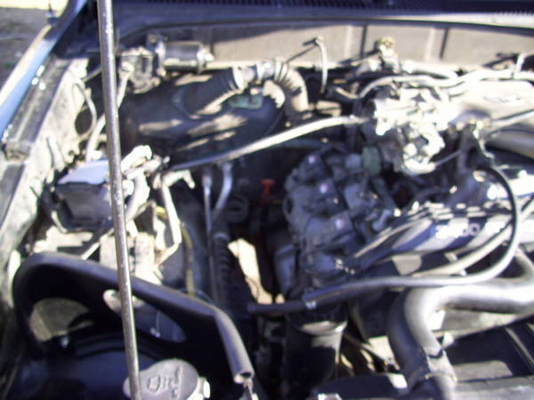

    and for a while I was pretty happy with it. It sounded really agressive and deep but I never really noticed any power gains at all but I am also no expert. As far as fuel economy goes there was no change what so ever. I know the majority on tacomaworld are against cold air intakes and I had actually bought the materials to do the deckplate mod about two weeks before getting the CAI but never got around to doing it. So with my deckplate and old air box just sitting on the floor, I decided to put it together.
    Since I had read multiple good reviews and at least one dyno sheet praising the results of the deckplate mod, I decieded to give it a try. Also I had kinda gotten tired of the constant sound of the K&N intake even while cruising.

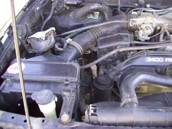

    Putting the stock intake back on
    Overall I am leaning towards the deckplate mod over the K&N intake. Its quieter but still noticable once you give it some throttle. Its the same if not better throttle response then the CAI. And its $200 cheaper. As far as fuel economy goes I havent had it in long enough to see yet but ill post it later. So if your on the fence between a CAI and the deckplate mod, I would sugest definatly trying the Deckplate first and saving your money, but thats just MHO.

    what size deck plate is that..???

    Looks like a 4"

    thankx peeps.. i ordered a 4" and i'm gunna try this mod out... i have been searching on the forums but i cannot find a picture of the elbow or the silencers that people are removing..... is there a thread on it.. ???

    deck plate mod is pretty easy.. believe it or not.. the truck is more responsive. thankx peeps. i removed the elbow and the silencers too.. nice...
