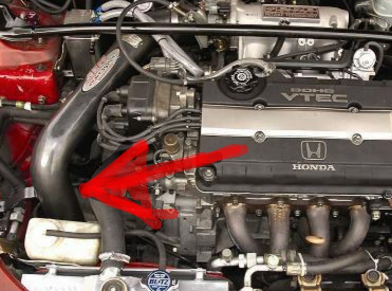

    These tacoma cold air intakes just look like regular intakes...I used to have a 97 civic with a Aem cold air intake and it routed out of the engine bay and in front of the front wheel well. The tacoma cai looks like a non cold air intake. sketch-1492480397674.jpg

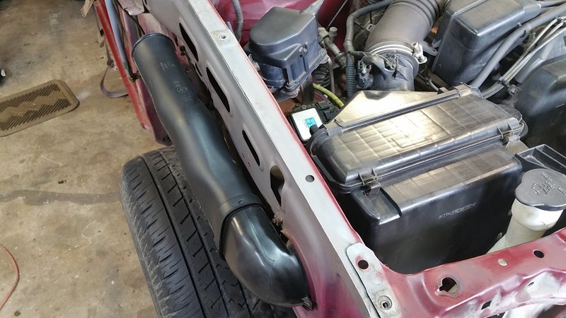

    huh???.......They do route out of the engine bay and get air from the front fender wheel well.

    and this is exactly why I personally chose to do an "elbow mod" over that deckplate thing. With the elbow mod you get all fresh air from outside the engine bay sans that restrictive reverse snorkel, whereas the deckplate mod you may get a mix of fresh air plus hot engine heat depending upon propagation in there. I say elbow mod FTMFW.

    That's not a "cold air intake". I'm talking about the non modified air boxes. The ones people are paying $200plus for.
    That civic also has/had that extra part connecting to the stock airbox. You would remove all of that and the filter would take up that spot. The airflow would be much better than that plastic elbowing. Dynos numbers would see 5-6hp gain which was a lot for those motors.

    Pretty much every factory intake/filter setup in the last couple decades (or longer) is a cold air intake. The stock taco pulls air from inside the fender, no mods required. And the taco setup flows more air than the engine can actually use, more so with removing any restrictor. I'm a big fan of throwing money at stupid parts but you need to have a realistic expectation of returns. 5hp added to a lawnmower is a big difference. 5hp peak for 1/10th of a second on a 150+hp car truck, totally negligible. Have fun, mod as you want, but the engine is what it is.
