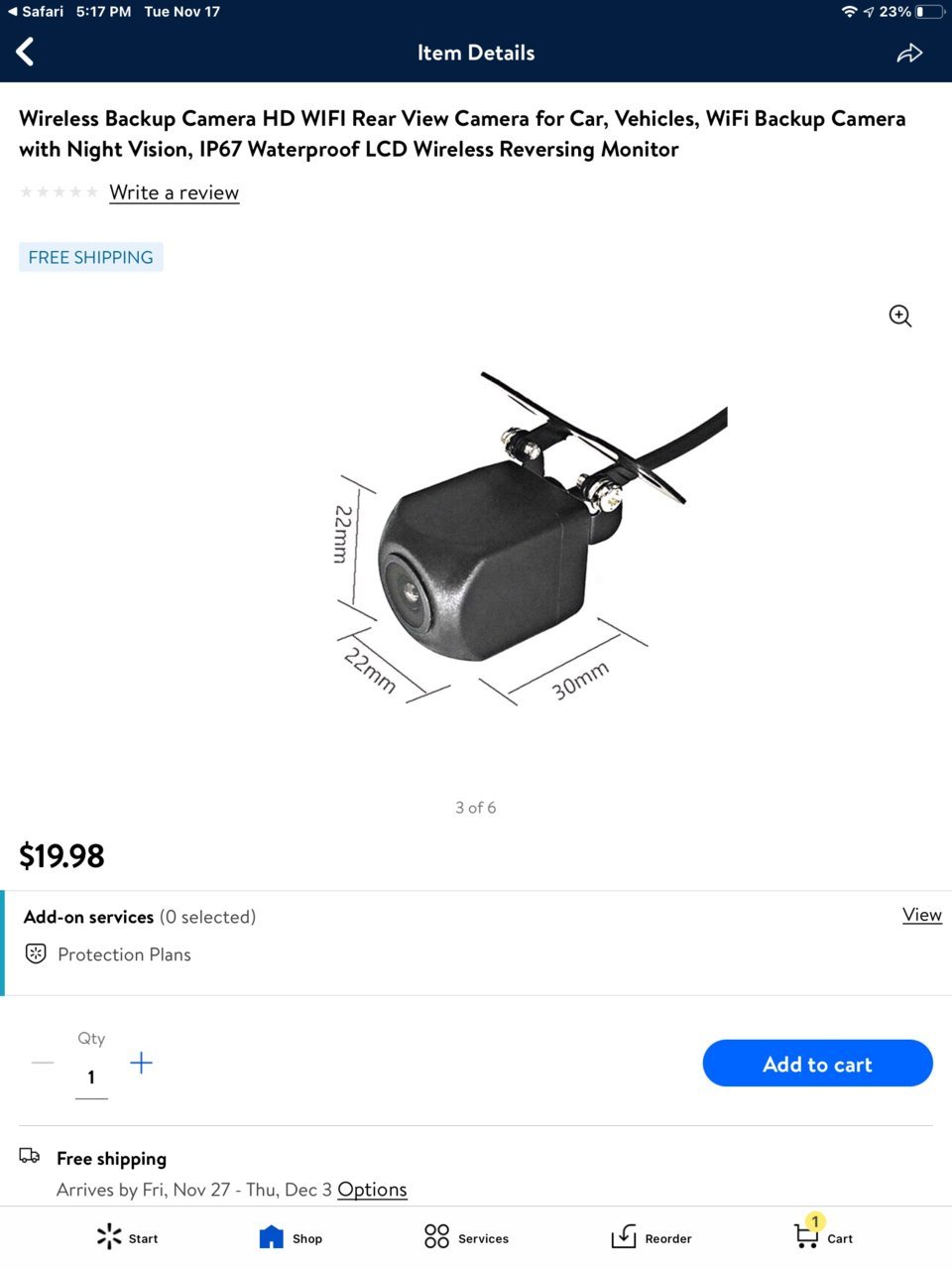

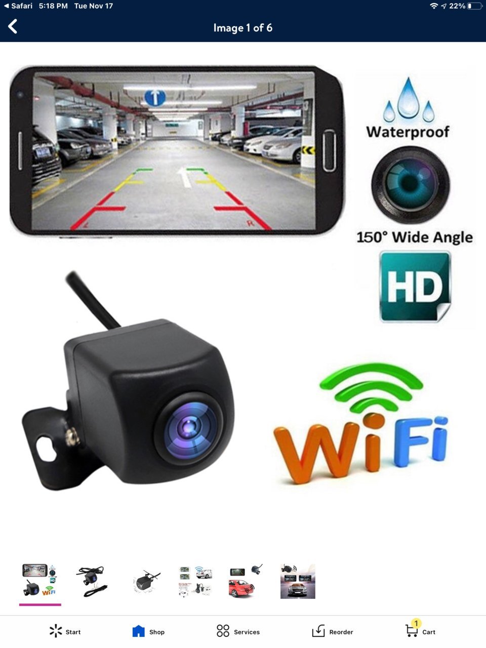

    I think this may be something that I can use, I got this off your first link, it looks adjustable so if I mount it on top of my grill I can actually aim it downwards, like I said that way I can see what’s over the hill instead of having to get out and look, plus it’s waterproof, I appreciate the link and if you happen to find anything else in the way of what I’m looking for please let me know, thanks a lot!

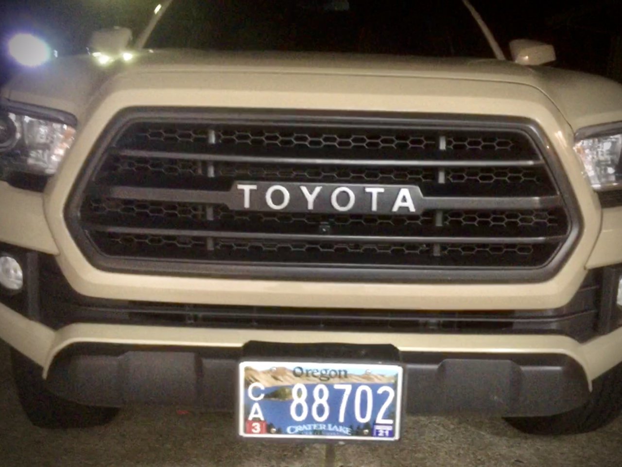

    I went with wireless for the front camera.

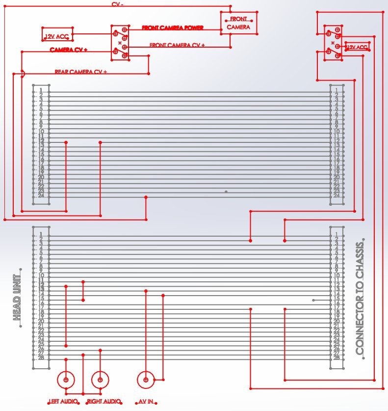

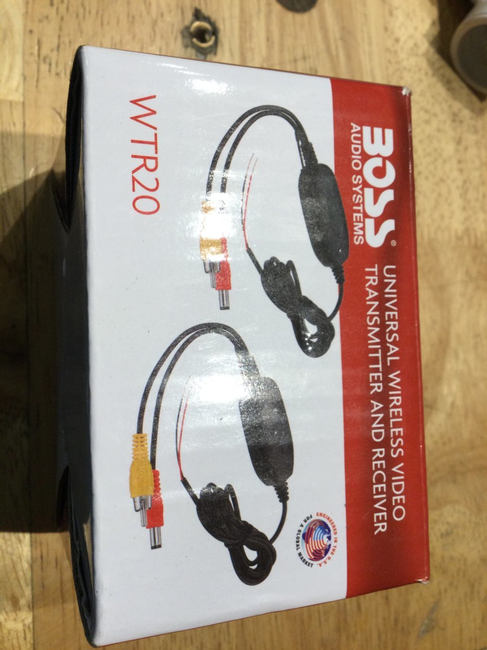

    I bought the wireless transmitter at Frys Electonic. Got the camera off eBay and I used this diagram to hook it up.
