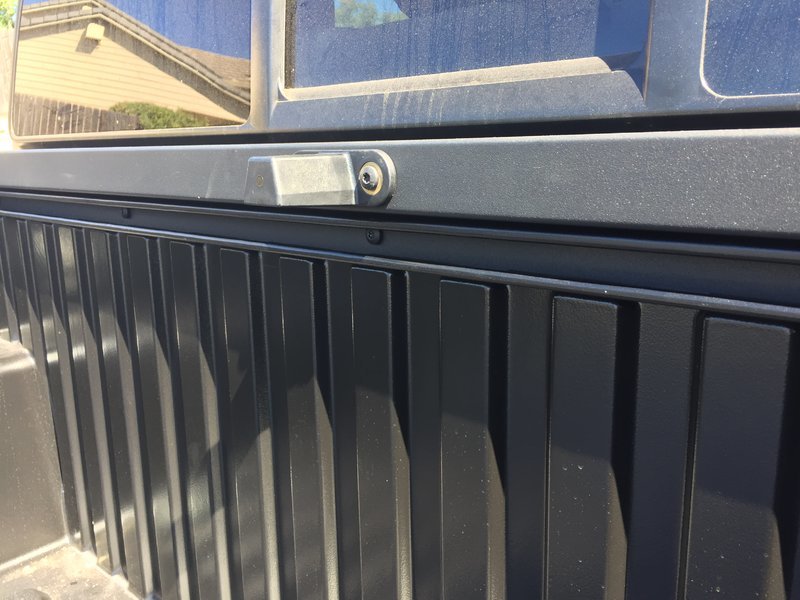

    I ordered mine off of Amazon, Prime shipping no less. Just unscrew the 4 bolts already installed in the bed and install the front rail (I added some Loctite 242 on the bolt threads for good measure). The holes are a perfect match. The only issue I've seen so far is that the top lip of the bed somewhat interferes with installing the rail cleats. Not a show stopper, you just have to be patient with them and they'll go in.

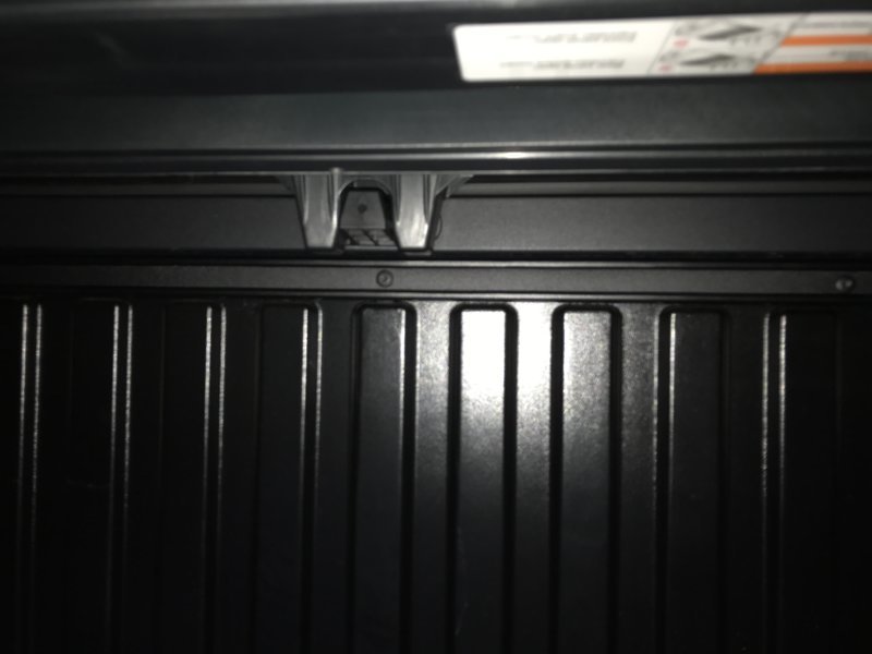

    I'm unsure where you heard that, but I'm glad I'd already bought mine before reading your post since the header rail works just fine with my factory bed cover.
    I just installed part # PT278-35100-BH on my 2017 DCSB TRD OR with OEM Tonneau. Fits perfectly.
