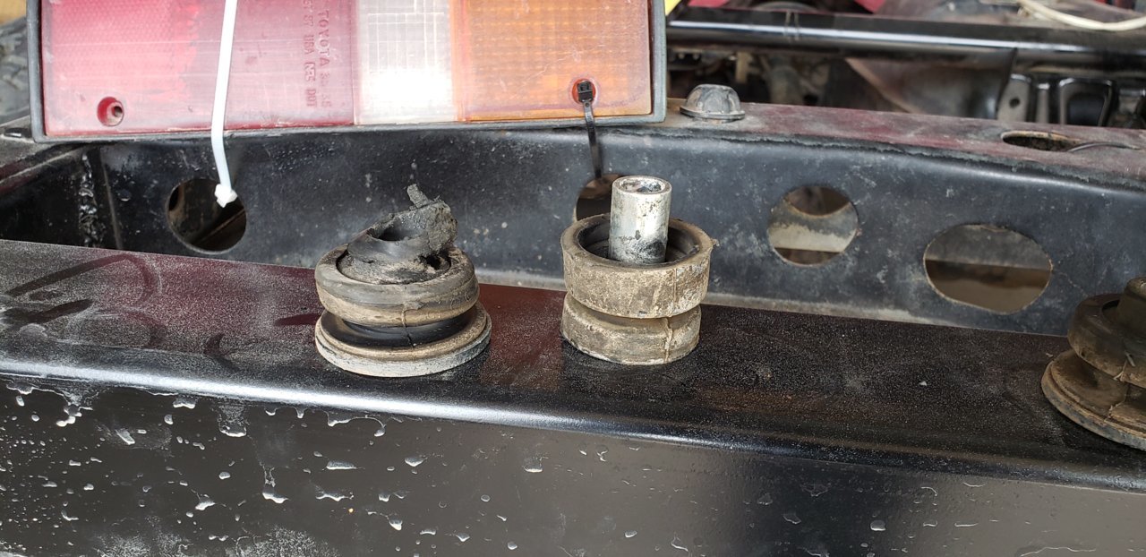

    Just to add something here. My driver's side mountwas destroyed. Replaced both sides, and still have the same popping. Also the driver's side mounting holes were so far off I had to pry the mount against the body "not easy" to get everything to line up.

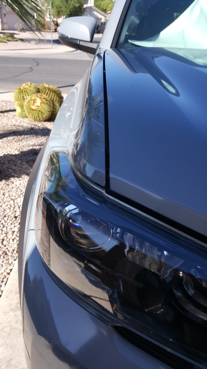

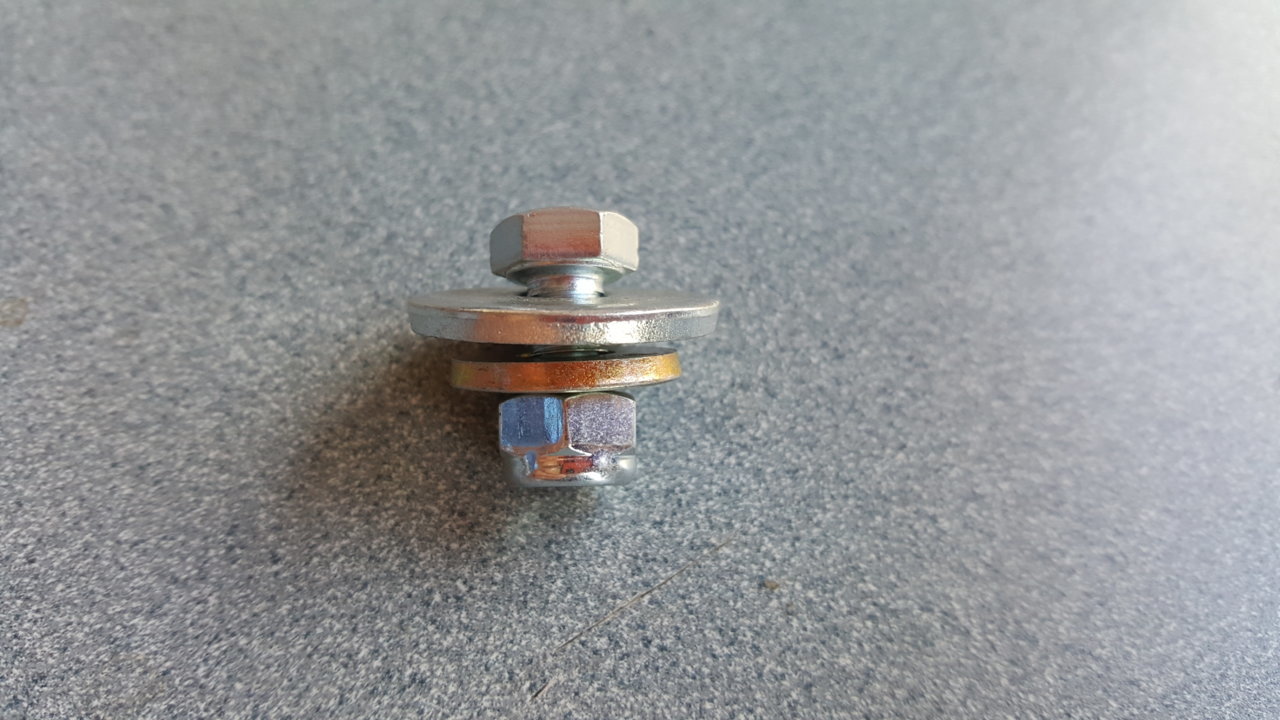

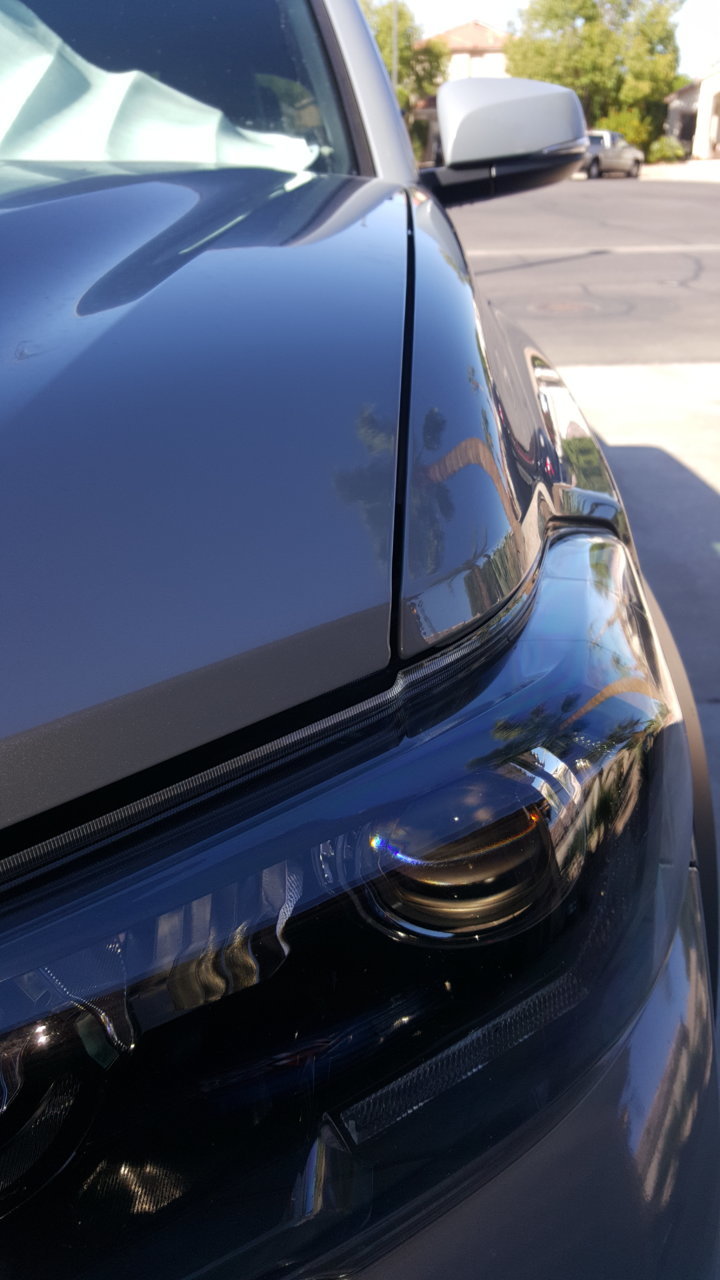

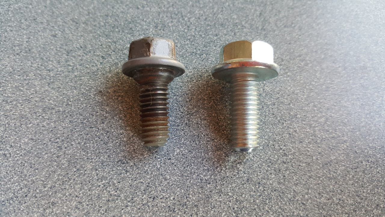

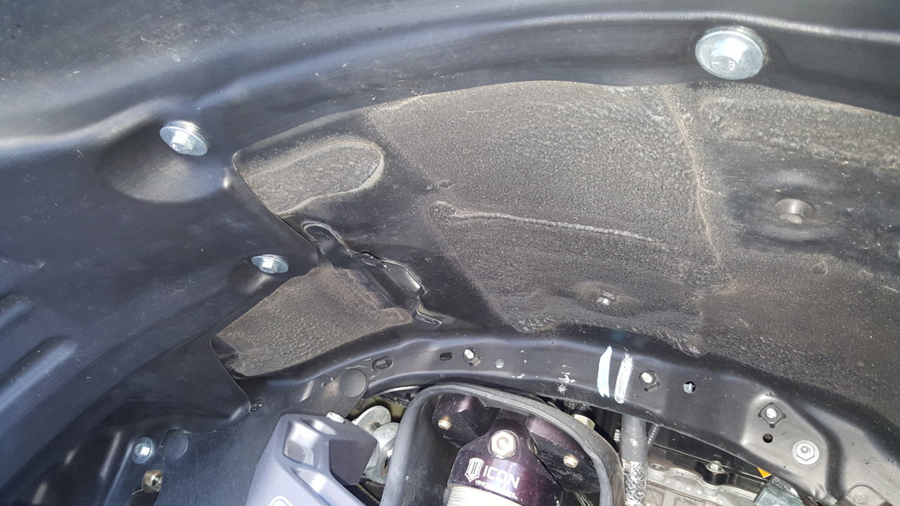

    Yesterday decided to replace the front body mounts. Did not take any pictures since my mounts looked pretty much like the ones posted before. Have followed the procedure listed at the beginning of the thread and all went OK. Besides the mounts I have fixed the "buzz" coming from the front wheels, both sides. I knew for a while that the fender liner was rattling since is held in place by 5 (per side) plastic push-in retainers that are NOT holding the liner tight in place. I have tried to put a screw in the retainer hole but is cheap plastic and was spinning without tightening the liner. So, went to ACE and got 10 bolts, washers and nuts and went the old way to secure the liner. Solid in place now.
    Before I replace the mounts, I checked the spacing between the cabin and frame. On the passenger side I could put the thumb in but in the driver side the pinky barely went to half nail. With the wait on the driver side, the mounts are more prone to squash and the cab is tilted. After the change I gained about 1/2 in in height in the front.
    REMEMBER! when you replace the mounts, the geometry of the cab to the frame will change and you need to readjust the hood.
    The truck feels a bit more "tight" when driving and is not leaning when I step on the nerf bar to get it.
    Let me know if you have any questions.
    Now Pictures:
    Here is the bolt setup I used to secure the fender liner.
    After the mounts install, the hood is not lined up to the fenders anymore.
    I have tried to adjust the hood but the OEM screws that hold the hood to the hinge have a collar close to the head that fits in the hinge hole and adjustment is not possible. Back to ACE for normal screws.
    With the normal screws the hood can be adjust a lot. Took some time to make it flush to the fenders and equal on both sides.

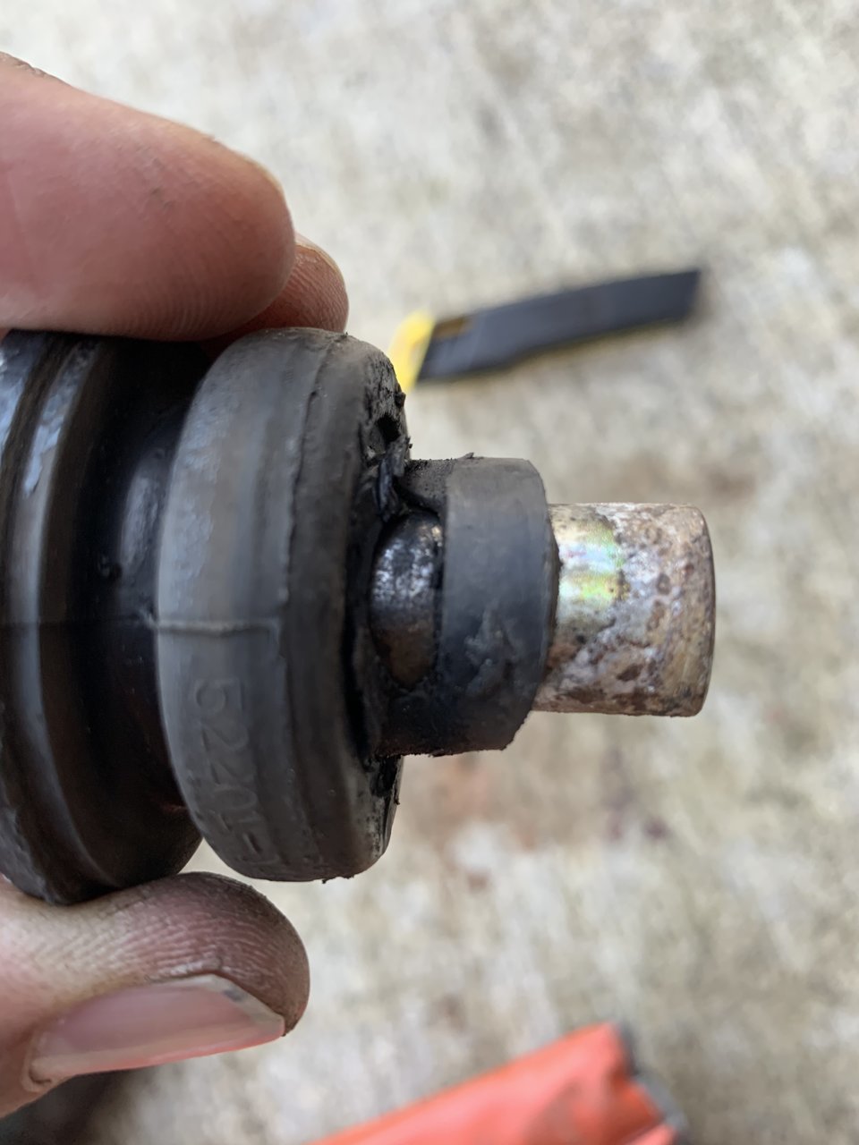

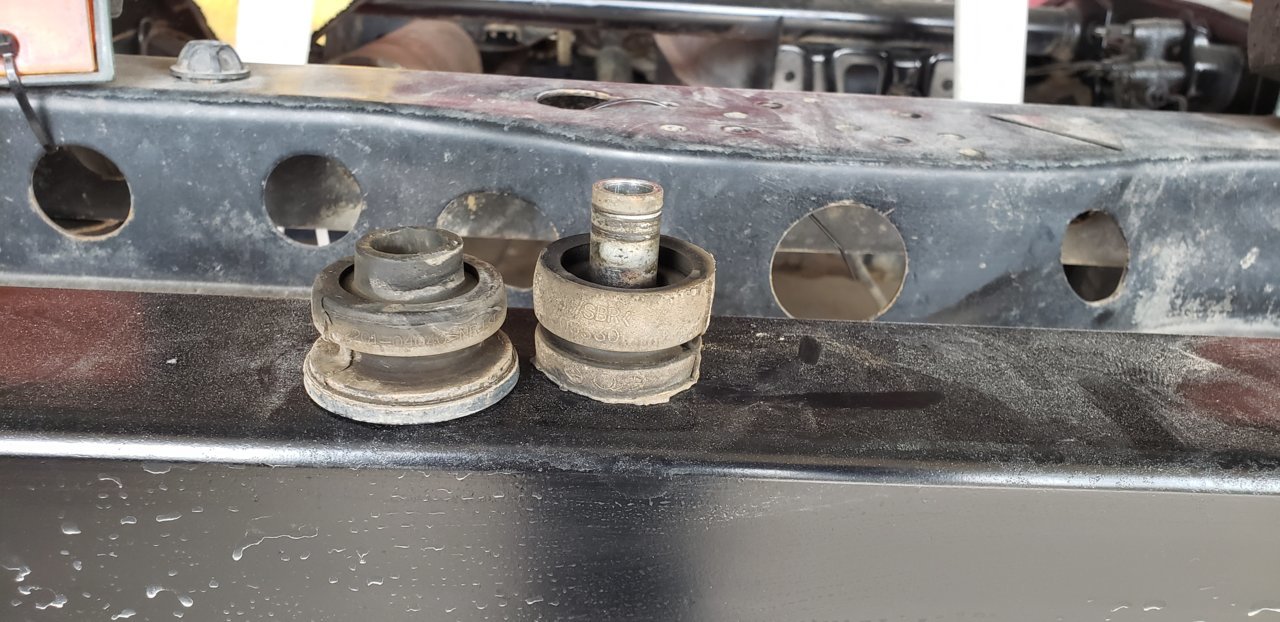

    @Victory thank you thank you thank you.

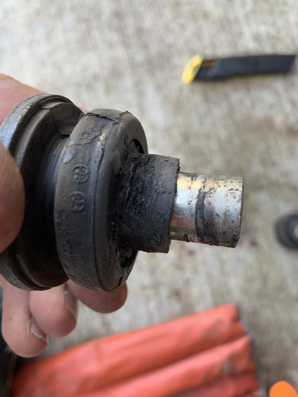

    I’ve had the energy suspension mounts in my possession since oh last June:notsure:. Finally pryed open the fender liners today to stop the rubbing and saw the mounts that have evaded me up until today. Figured it was time and swapped them out. 2017 Pro with 28k miles. Passenger side metal exposed, driver side not far behind.
