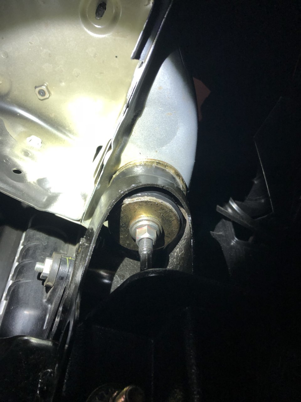

    Mine looked the same at 26XXX miles. Paved roads only. Soft POS rubber. How tight did you install them? I tightened mines till the lower rubber pad was about 1/64-1/16 passed the metal washer. I tried to install them loose but the nut was finger spinning. Had to tighten till the nut was securely tight.

    I just tightened it felt snug. I used a wrench on the top and a socket on nut and secured it without getting crazy. I’m amazed at how well the front of the truck feels after doing this swap. No slop and such a better feel.

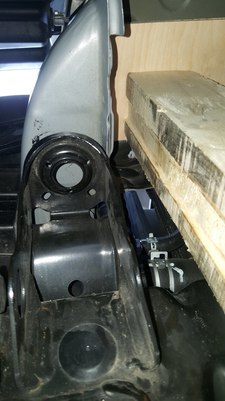

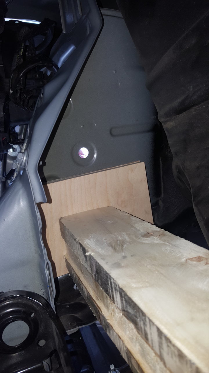

    I just did this in about 40 mins, mainly took longer finding a piece of wood to jack the body up. My passenger side was squeaking and after a drive around the block I can already tell a big difference. My truck has 23k on it and one side was already toast, bad Toyota, bad.

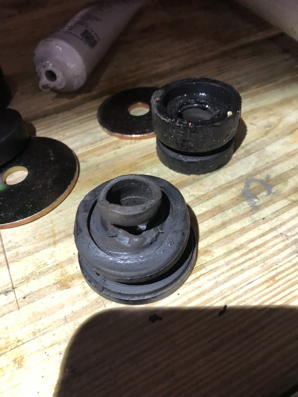

    Just replaced mine, not that easy. Took over an hour on the first side and a half on the other. Jacking the front of the truck up I heard snap crackle pop on both sides, but I don’t think I broke anything.
    Whichever the case, the second side was a bitch to line up, had to use a crow bar and was worried it would slip off the jack and support. Finally got it done and the old mounts (only 7000 miles) were pretty worn.
