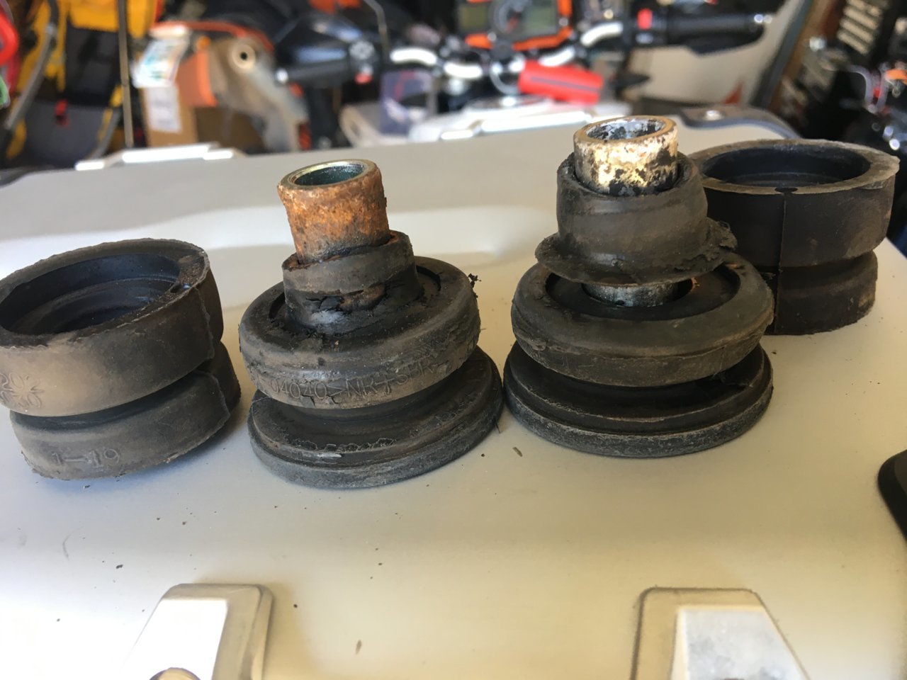

    I put those radiator body mounts on today, the $30 energy set. Boy were mine f’d! The passenger side was all rusty (live in southern AZ) and the driver’s side was completely separated (metal from rubber). I had (thinking positive here) the clunk up front somewhere. We’ll see tomorrow if this worked.

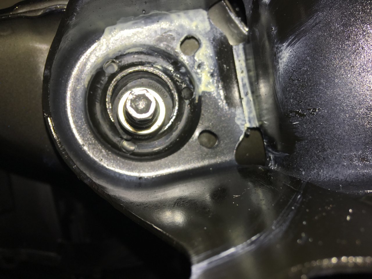

    I have cracks forming on the Radiator core support that attaches to the upper portion of this mount. That creaks like a bitch.
