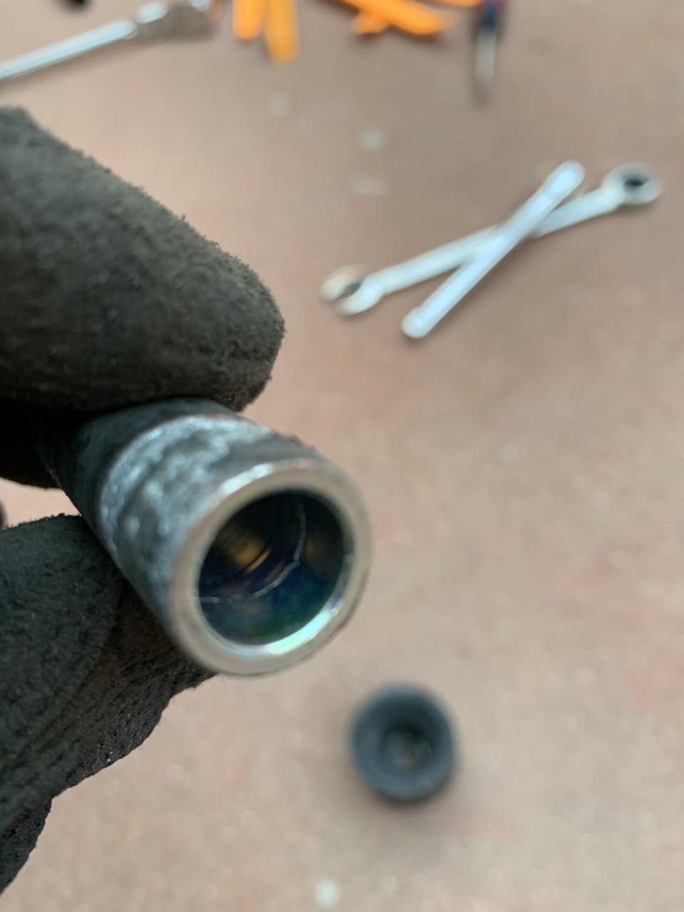

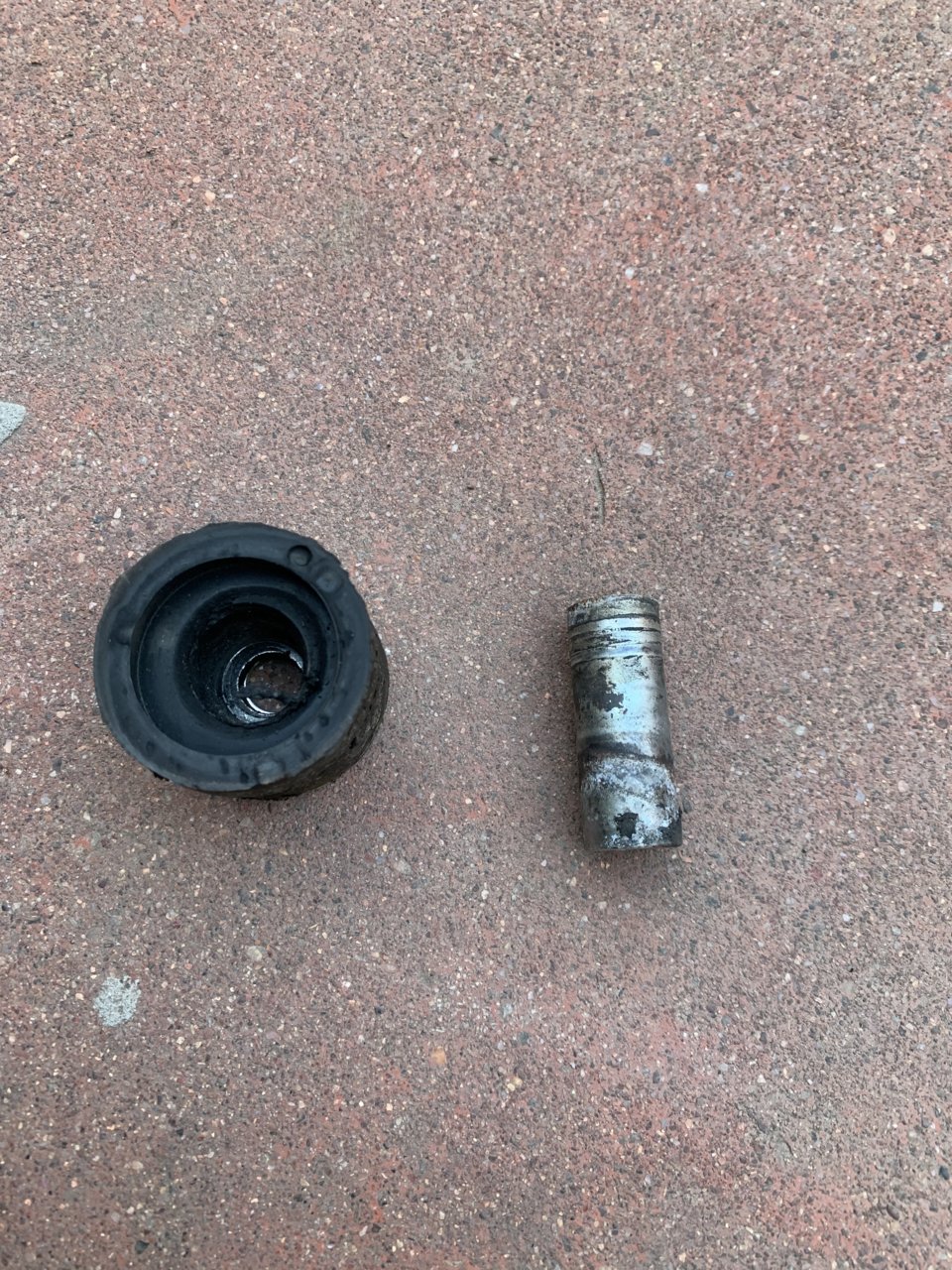

    OP, thanks for the write up and clear instructions. Made changing out the bushings pretty easy.
    I have ~20,000 miles on my OR and my bushings were shot. The metal sleeves were trashed and appeared to be scored/scratched on the inside.
    I'm hoping the Energy bushings fix the intermittent clunking I sometimes hear/feel from the RF.
