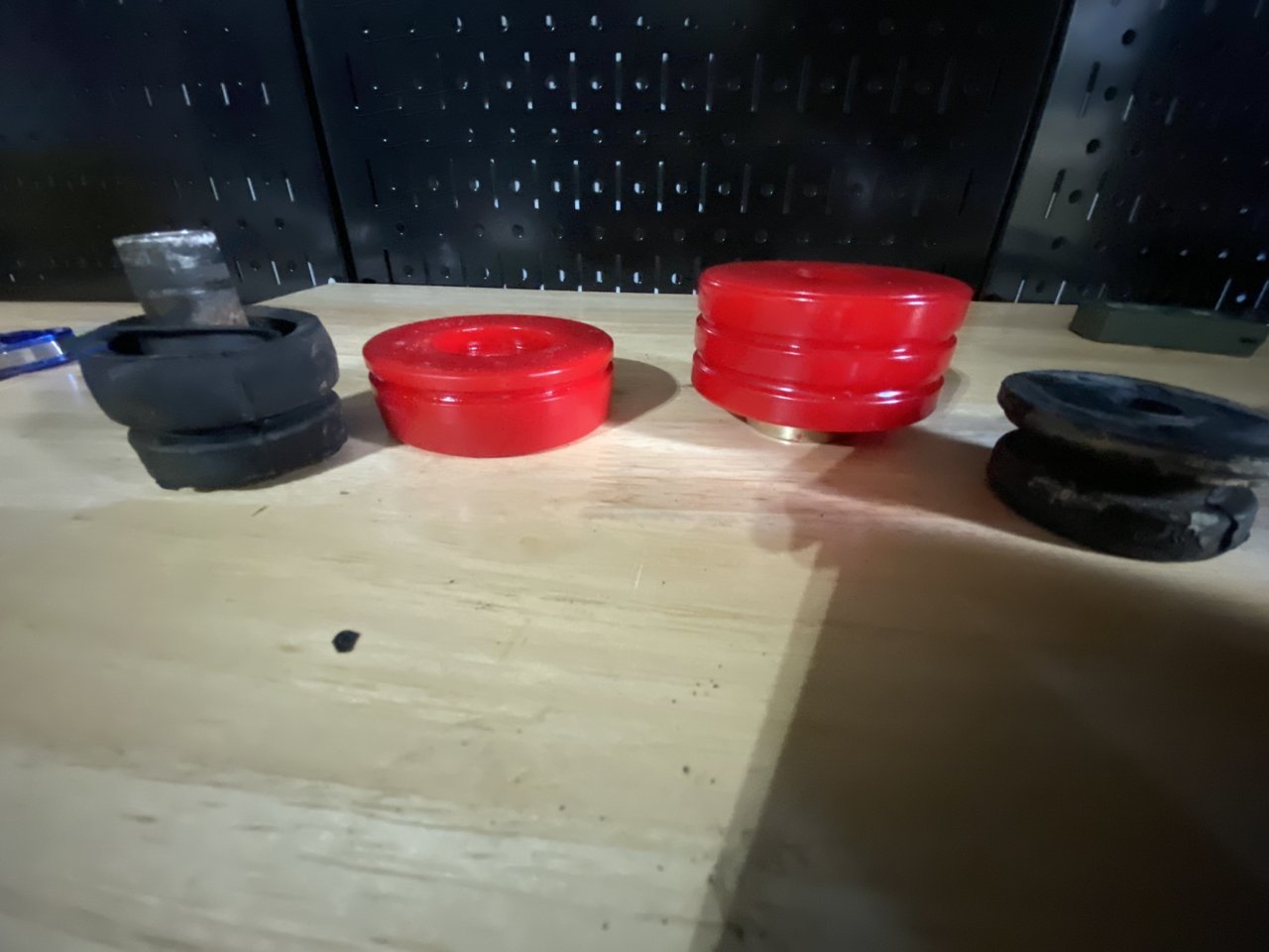

    @dmurph1996
    Unfortunately, I can confirm the beefier ones Energy Suspension 9.4102R Universal Mount https://cutt.ly/mgPqGSv
    Will not fit without a ton of work to the poly bushing. This turned into an ordeal to make them work, I was in too far and couldn't stop. No install video as it would have tuned into me just looking into the camera cursing for a couple of minutes. And, it takes away any amount of extra front end leveling.

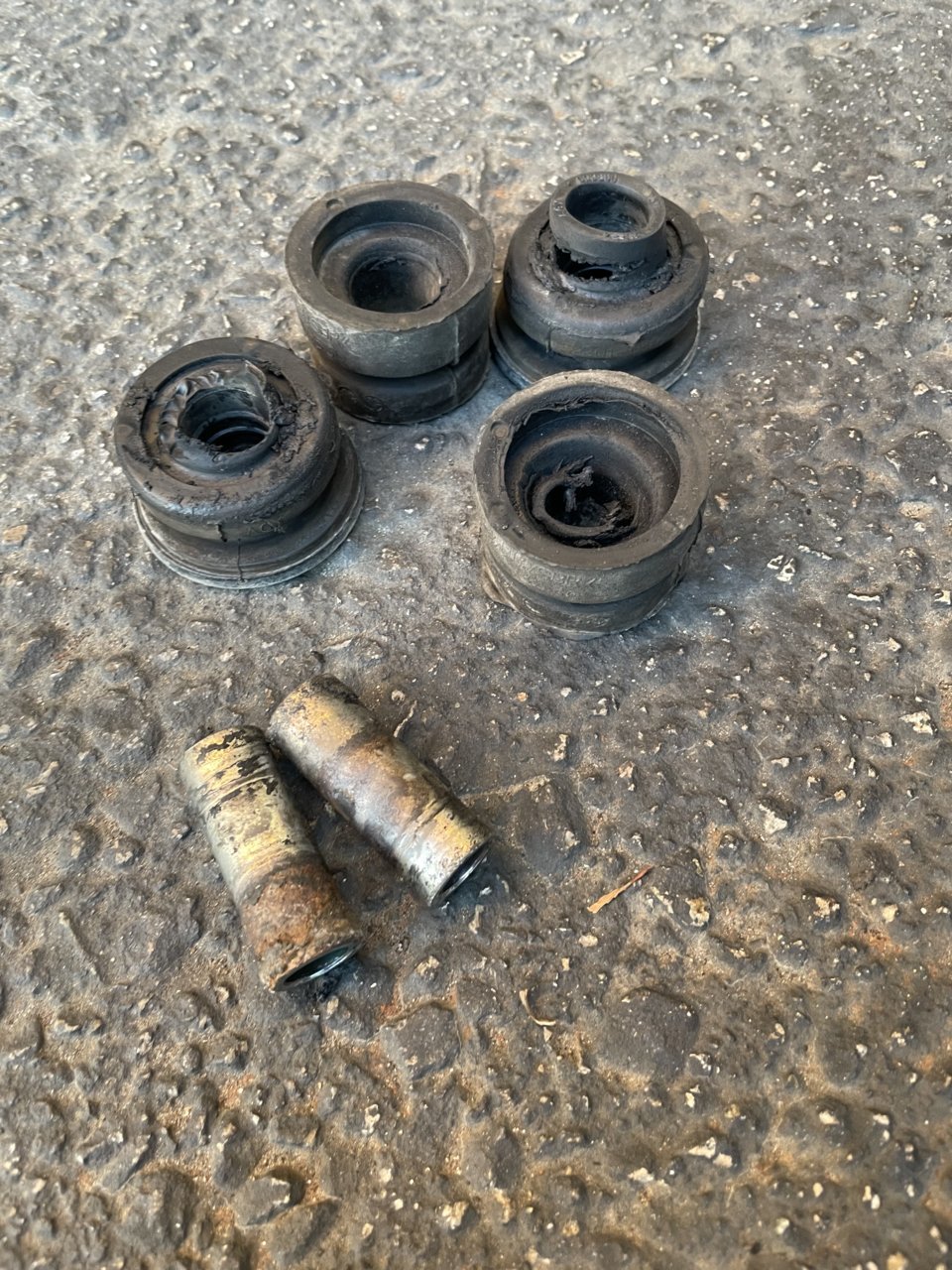

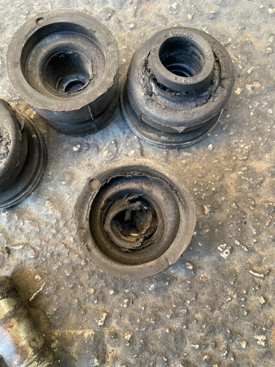

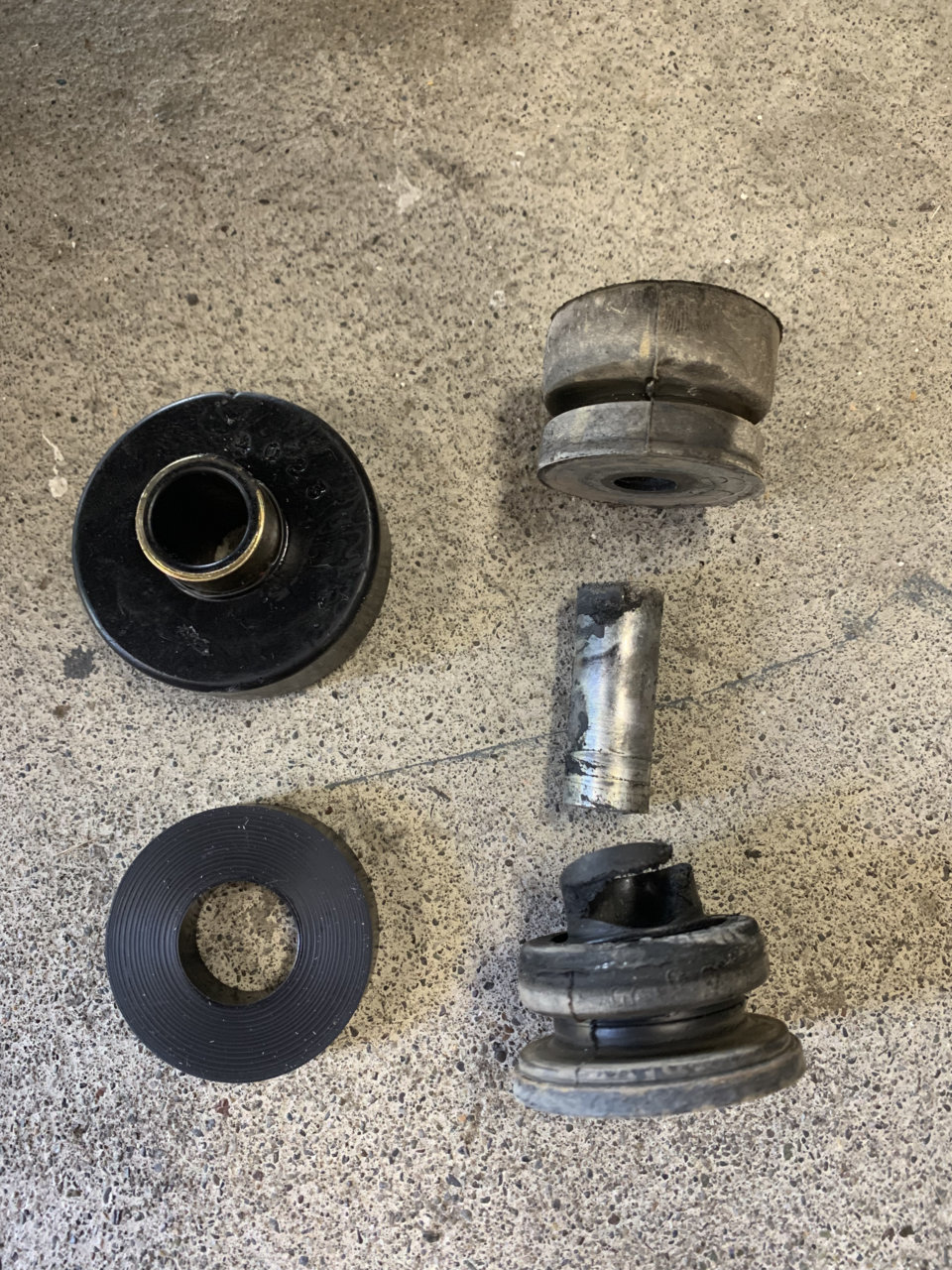

    Did mine over the weekend. Like many others took 1.5-2 hours. Hardest part was taking the damn flats and guards out of the way. The driver side looked to be ok but had signs of wearing, the passenger side was shot so I'm glad I replaced them.
    The annoying this is the dealer couldn't care any less when I asked about the noise I was hearing. They wanted to charge me $200 just to take a look at the truck. Then, since I have larger wheels, they said anything they find might probably wont be covered by the warranty because I have significantly modded my truck.
    Anyway, here's what my passenger side looked like with 13,000 miles on it.

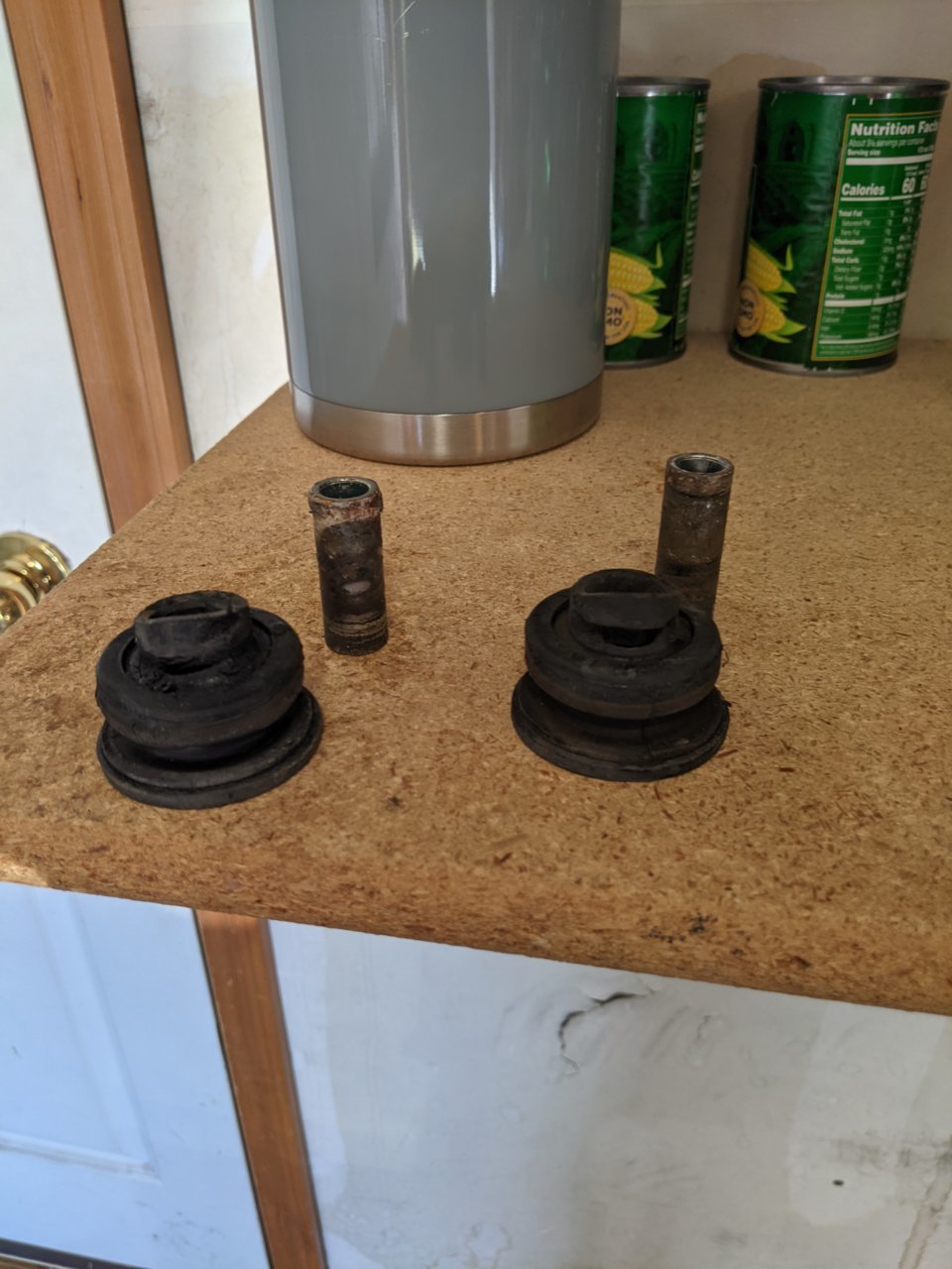

    Just wanted to add to this thread. Finally got the dealer to replace these under warranty after three visits. First time they said it was my leaf springs, second it was my skidplate hitting my front diff (?) and finally, the third time around they confirmed it was the front body mounts.
    Just picked it up after they swapped the part and I asked my advisor to see the old one, which you can see in the picture below was beginning to tear. Thank you OP for this thread!

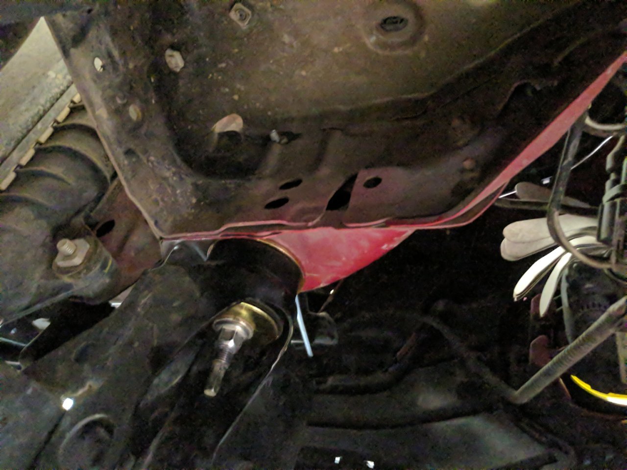

    No. You just need to jack it locally to slip in the new parts. I used a 4x4.

    Sorry. I forgot that I snapped a pic.
    I jacked in the read area shown:
