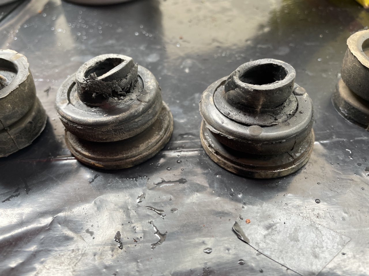

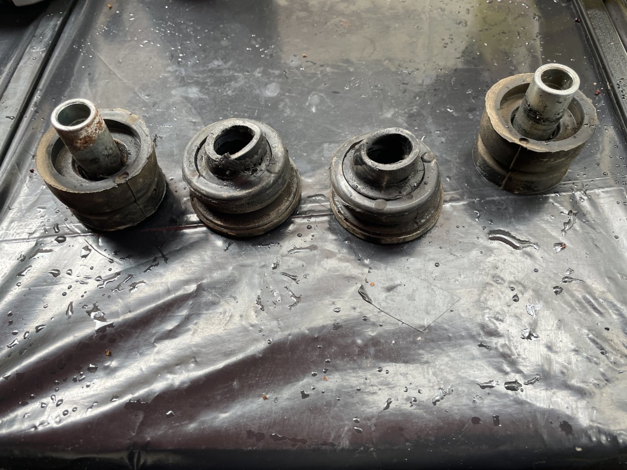

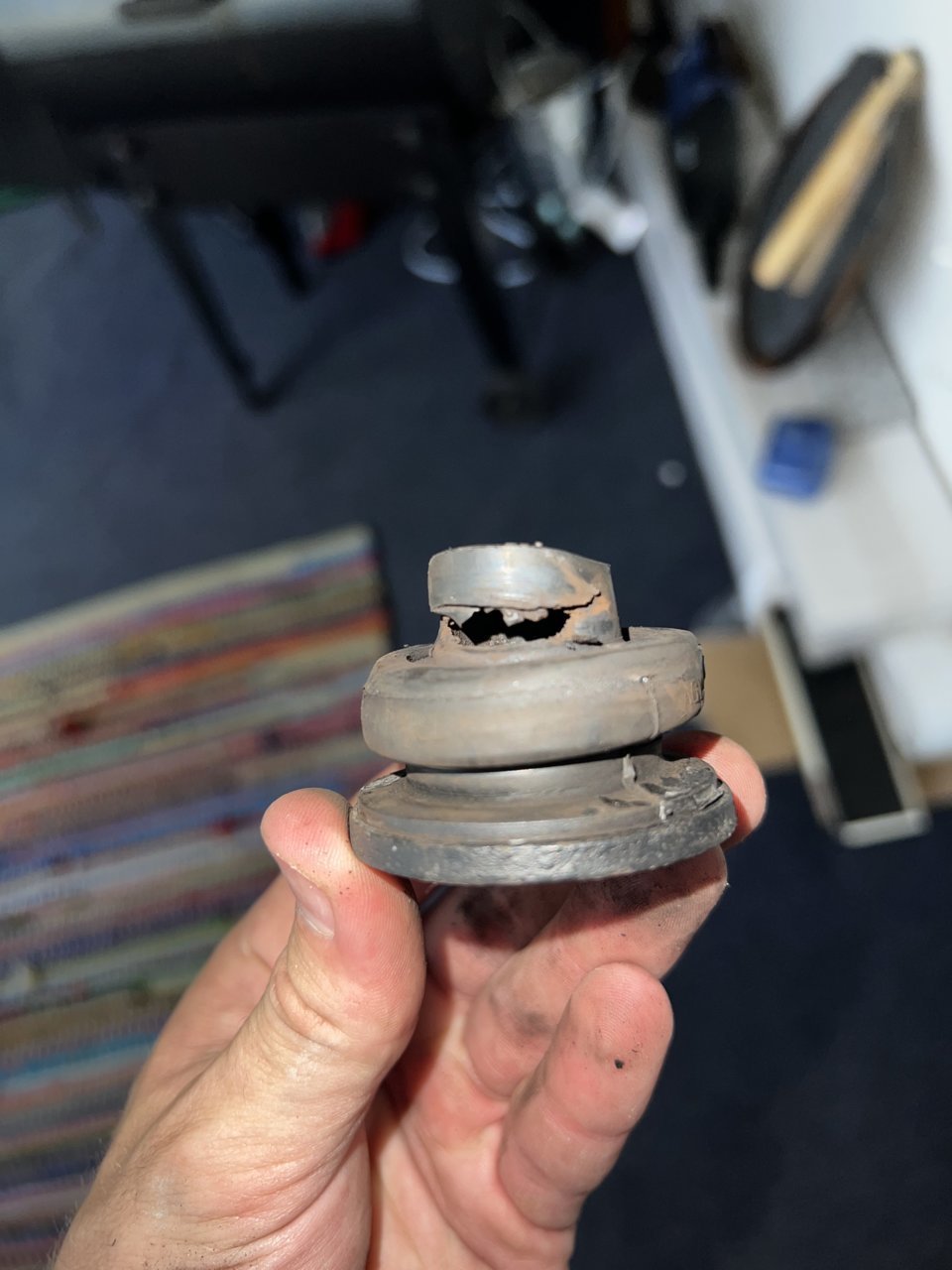

    Just replaced mine at 87,000 miles. Left side is passenger side. Definitely torn up.
    250E40EC-642A-4EF5-A894-4FC4968F1692.jpg A7E68A8F-5E56-4899-B119-AC9D9C20E901.jpg

    Seen this one? Makes sense...offset bushing deformation, bad cab/bed alignment, replacement bushings not aligning properly, etc.
