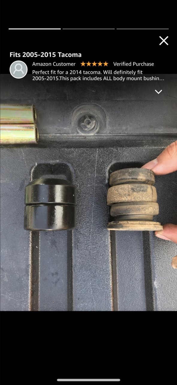

    I had the universal kit for a while but still kept getting pops. I think it’s because they didn’t seem to fit snug in the holes of the frame. So I got the 8.4109G kit which is for older Tacomas and just used the 2 rad support ones. The center rubber piece fit snug in the hole when I lowered the body back down. It’s the bushings circled in red. The diameter isn’t as big as the universal but they seem to be working good so far. Kits like $95 on Amazon but I sold the other bushings I don’t need.
