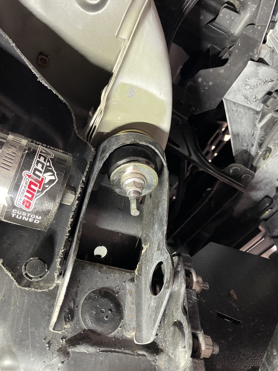

    I installed the bushings earlier today and like most of you guys, I had to use a prybar in order to get the bolt to drop into the driver's side mount.
    I'm a bit worried about the bolt. In order for me to remove the bolt after the install, I needed to use the prybar to move the body ever so slightly. When you guys used the prybar for installation, did you noticed that the bolt doesn't move from the tension caused by the body alignment? I'm worried about the bolt failing from the load caused by the body. I even tried applying pressure using the prybar when lowering the woodblock off the body hoping that the frame would remain aligned, but unfortunately only the bolt is keeping it aligned.

    Trust me when I say that the body will fail way before the bolt does...

    Thanks for the reply. I really wasn't expecting that kind of response lol. After thinking about it, the side load placed the bolt really isn't that much.

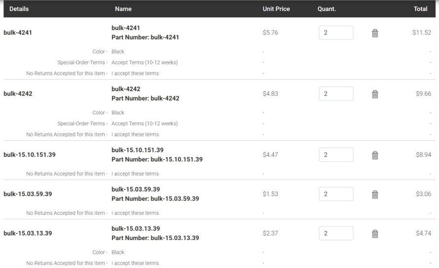

    Just replaced my front body mounts at 38,000 miles, its been squeaking for the last year. Always thought it was the coil overs after replacing the stock TRD Pro springs with the Eibach TRD Pro lift springs. Passenger was toast, driver had little life left. I purchased the 2nd Gen body mount kit from Energy Suspension, part # 8.4109G. A little expensive but, anything worth doing...;). The front body mount bushings are a direct replacement; same size upper bushing and no metal collar on the outside of the upper bushing. It was the inside metal sleeve on the factory bushing rubbing on the frame perch that caused the squeaking. Reasonable to believe the metal collar on the outside of the universal bushing will cause similar squeaking over time.
    I looked up the part numbers for the front bushing on Energy Suspensions web site. For $48 shipped, you can purchase both body mount bushings (upper and lower) with washers and sleeves. It will take 10-12 weeks because the bushings are special order, but the rest of the hardware is on hand. A little more expensive then the universal bushings from Energy Suspension :notsure:, but anything worth doing...
    15.03.59.39: Washer (2" O.D. x .406" I.D)
    15.10.151.39: Sleeve (5/8" O.D. x 7/16" I.D. x 1.640")
    4241: Upper Body Mount
    4242: Lower Body Mount
    15.03.13.39: Washer (1-3/4" O.D. x 7/16" I.D)
    If you reuse the stock sleeve and source the washers locally, just the bushings comes to a total of $30 shipped.
    Anyway, thanks OP for your efforts and highlighting the problem for me. :thumbsup:

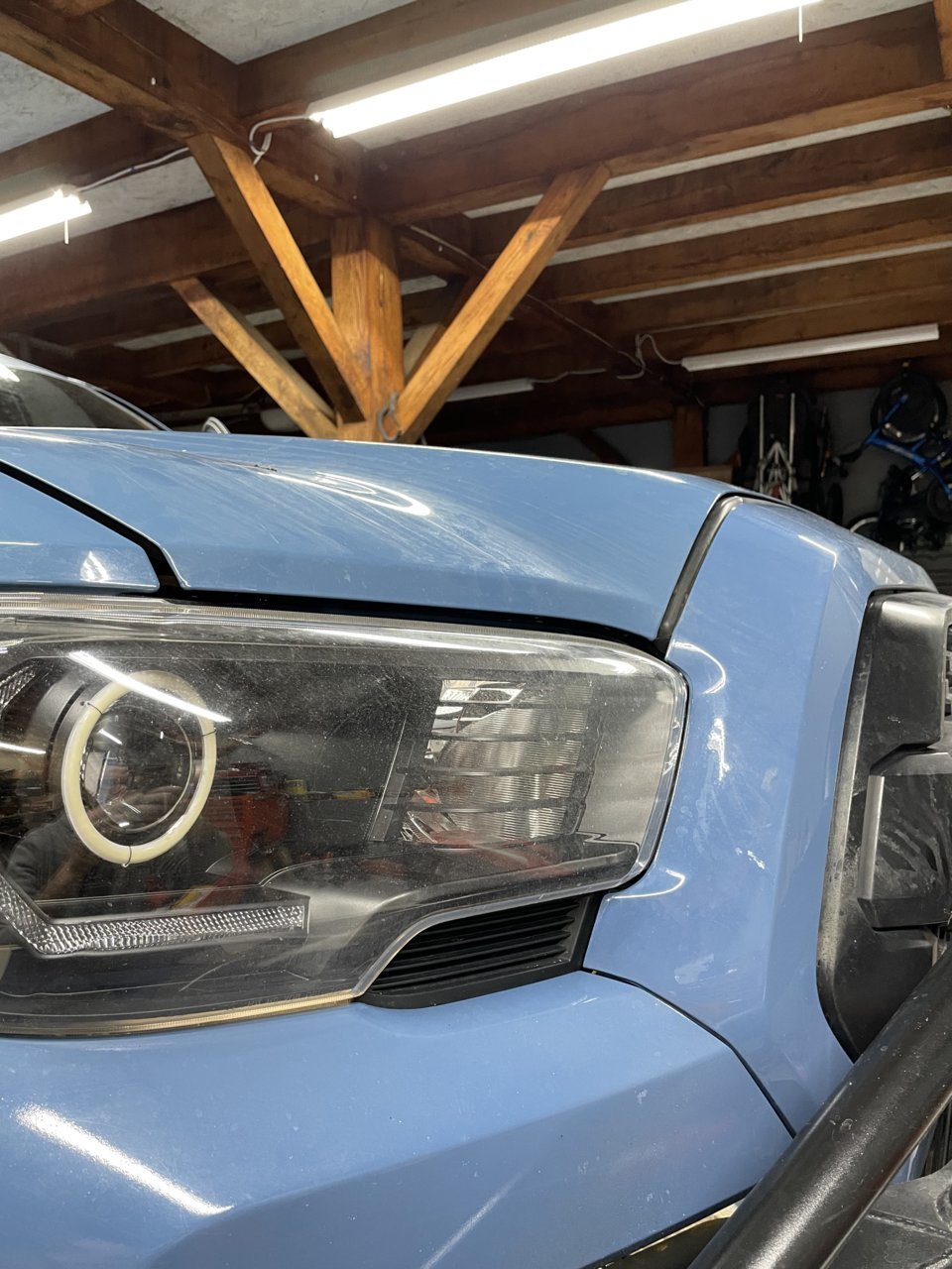

    I did the replacement today with the universal kit from energy. Having a high clearance bumper made the job very easy.
    Did anyone else have an issue with the hood being out of alignment after the new bushings?
    TacoPandaTRD likes this.

    I did notice that a while back, but couldn't figure out why. Dang!
    Nice sleuthing. It is bad. Just barely noticeable to me.

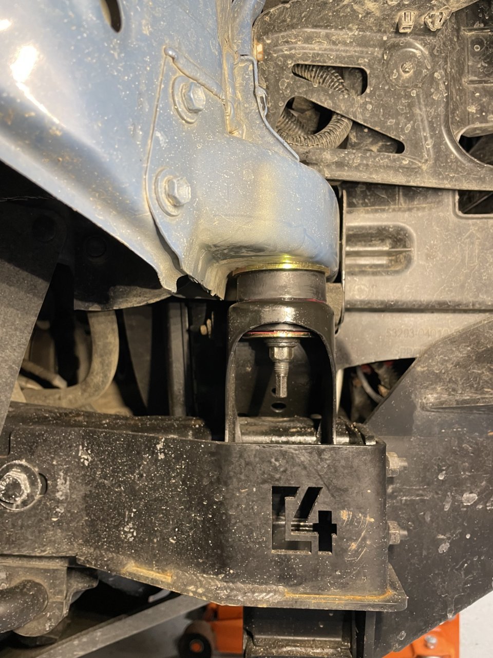

    Chasing a weird "bushing" sound. It is not metal on metal, but upon entering my driveway fast (3" lip) I can hear some rubber on rubber sound from the front drivers side in the area of these bushings. Occassionally on a nasty pothole/bump I can hear the noise on the road.
    Did 20+ miles of rough gravel roads this weekend and the sound was almost constant. Somewhat alarming really. Was also occassionally evident on the passenger side as well. After a bit hit they would "rattle" 2-3 times.

    Hey there, do you have the correct washer on the bottom side of the cab mount? Also using anything other than the bushings we designed the kit to use may not work as they are probably a different thickness.

    I'll email you directly to confirm orientation (shop did the install).
    Just using the energy bushings supplied with your kit for the CMR.

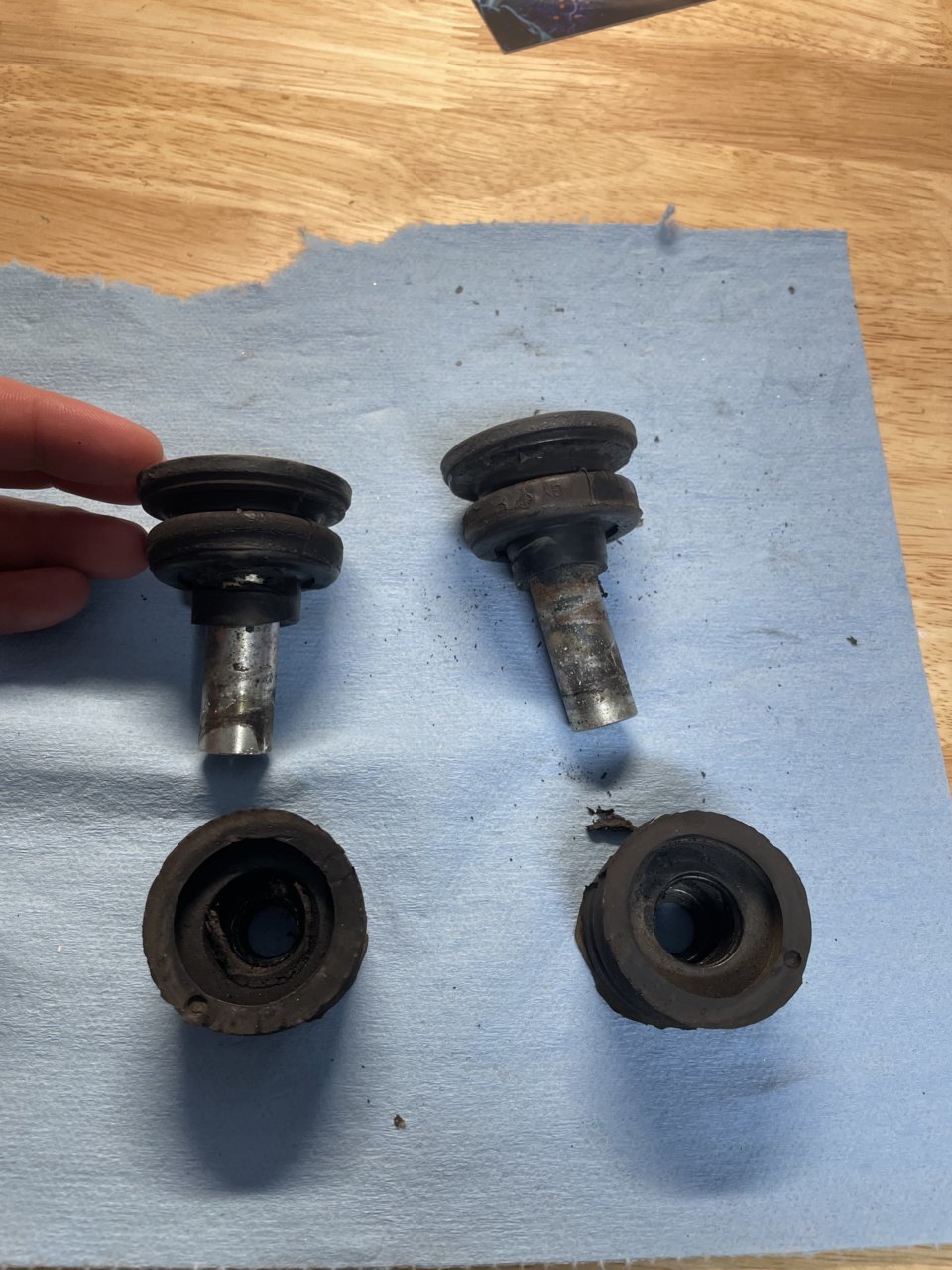

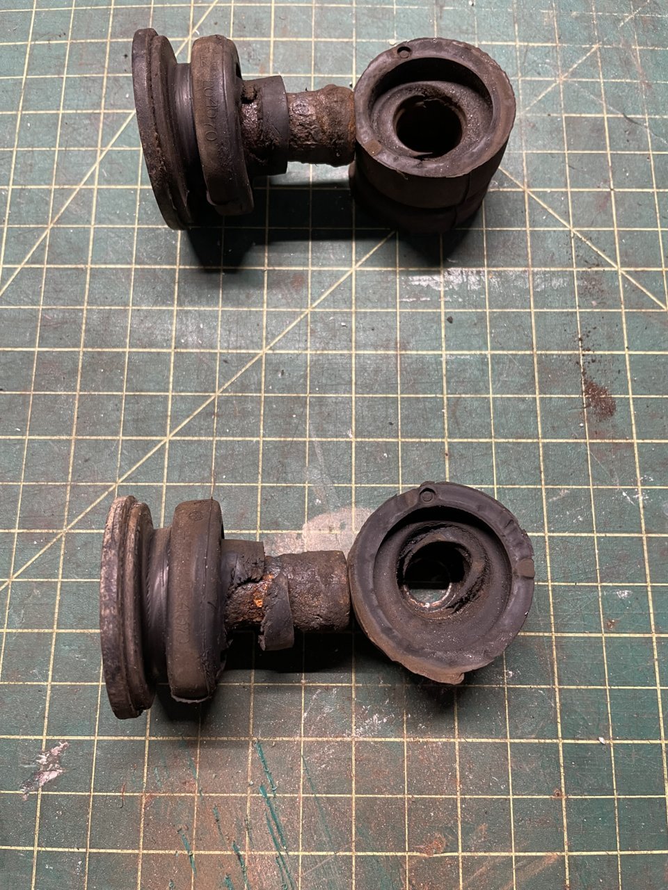

    For you 3g owners here are some pics from using the correct bushings out of the energy suspension 2g kit, as well as my roached factory bushings.
