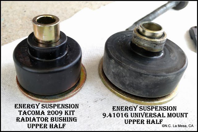

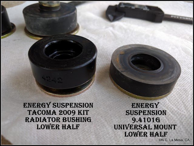

    So on the factory mount, the lower bushing is larger than the upper one, but on the ES bushing the larger one is the upper. The larger Energy Suspension Bushing and the upper factory bushing are about the same thickness, the larger top bushing also has the nipple like the factory one that the metal hardware goes into. The lower ES bushing is much smaller than the factory one, but it doesn't really matter because it is on the bottom and not supporting anything, even though it is smaller though, it is a heavier duty material, so I believe still stronger.
    If you went with the smaller Energy Suspension bushing on top, you would be lowering the body.

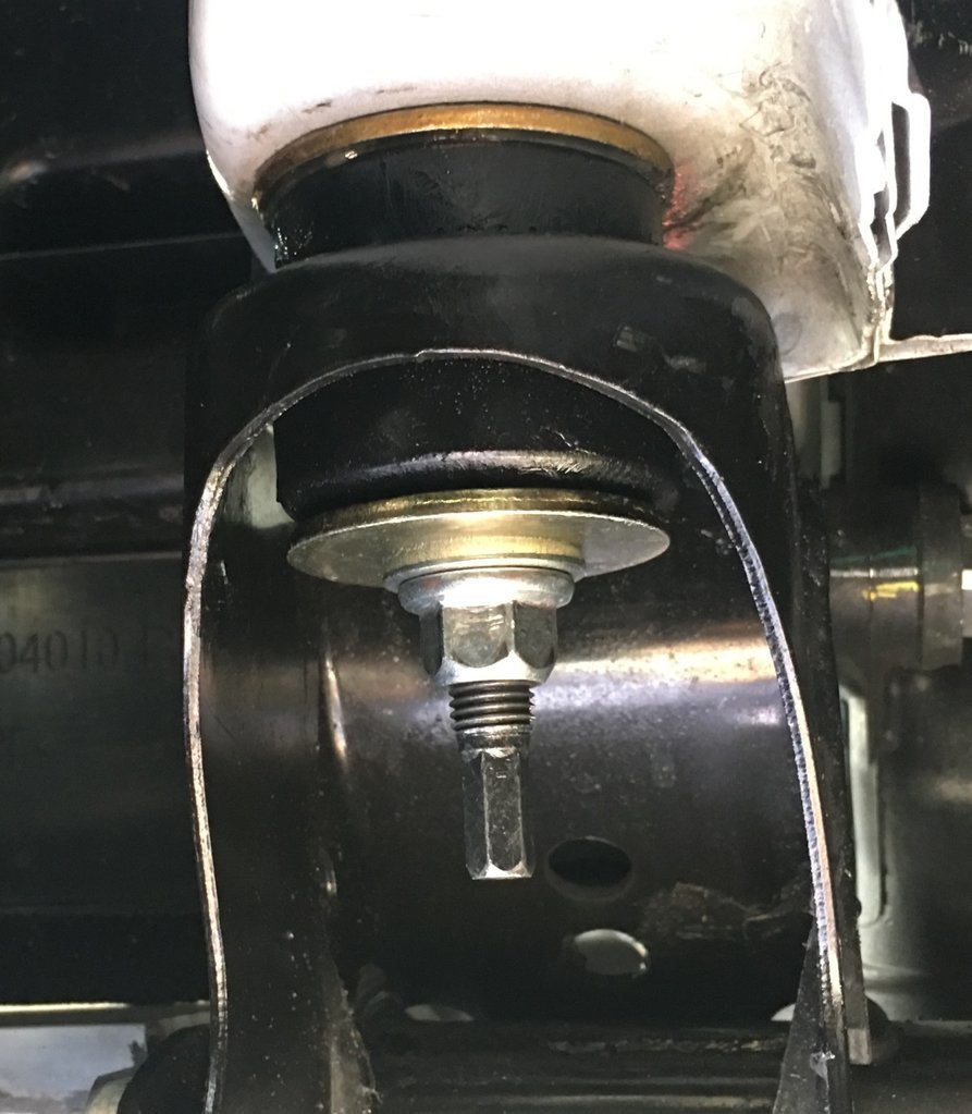

    There is only one way to install the Tacoma specific 8.4109G kit. They are exactly like the stock ones except polyurethane and can only be installed exactly as the stock mounts are. See the two pics below. I copied them from the 2nd gen thread about this issue.
    Below is a photo of the 8.4109G mounts installed onto my truck.

    You're welcome! The only other thing I can add is there are two different size washers. The large one (2" OD) goes on the upper mount between the body and the mount, and the smaller one (1 3/4" OD) goes between the bottom mount and the original washer and nut holding it all together. At a quick glance they look the same but they are not. See the instructions included with the 8.4109G kit below for full details.
