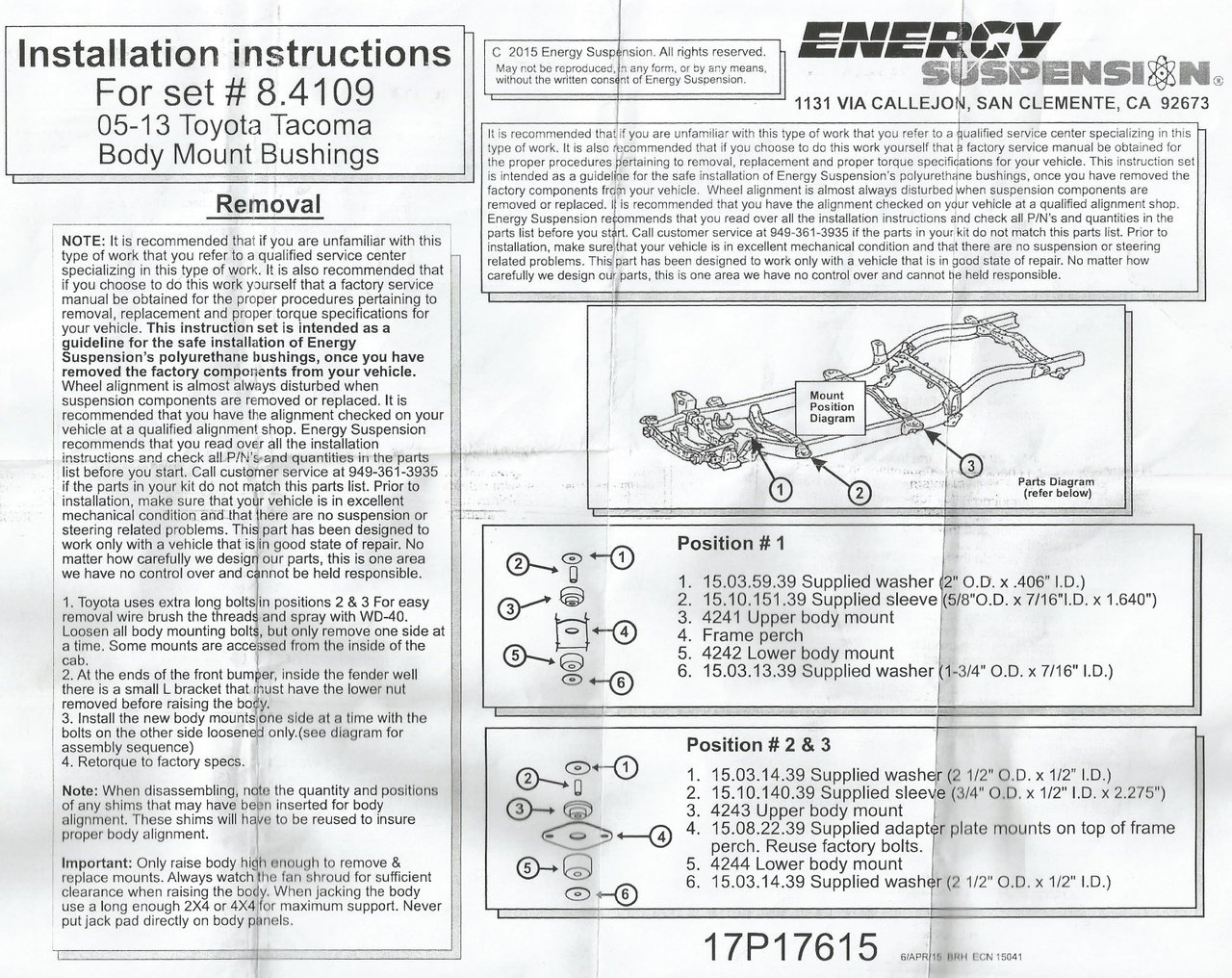

    The instructions say:
    At the ends of the front bumper, inside the fender well there is a small L bracket that must have the lower nut removed before raising the body
    Did you have to remove any bracket? Doesn't look like it from the op's writeup. Also, did you lube the inside of the bushings before installing? Thanks again!

    Those instructions are for the 2nd gen Tacoma, so the text I wouldn't worry about. Follow the OP's write up. The important part of the instructions is the diagram showing the orientation of everything to be installed. And yes, I did lube the bushings before I installed them. I've read some arguments for lubing them and for not lubing them. I've always lubed poly bushings in the past, so this time was no different for me. Cheap insurance just to keep them quite is how I think if it.

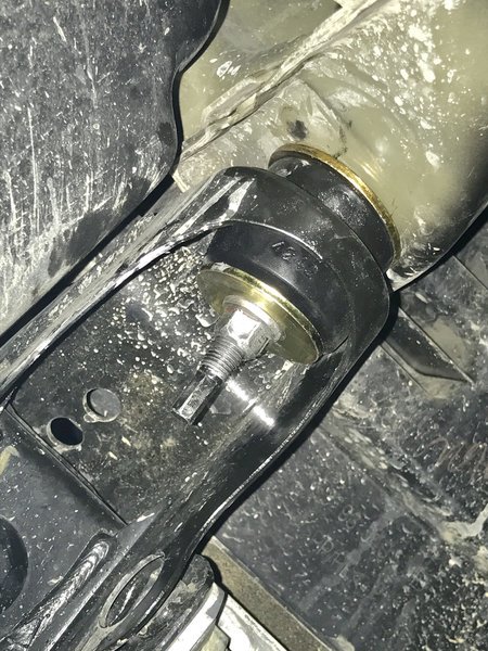

    Here is my driver side front cab / radiator mount. Replacing today with the ES bushings. Does this look bad, worn, or misaligned?

    From the outside like that it will probably look fine, and it does in your photo. The trouble area is inside where the two bushings meet. Look at the OP's photos for a bad set of OEM bushings. You will only know when you get the bushings off of the truck.

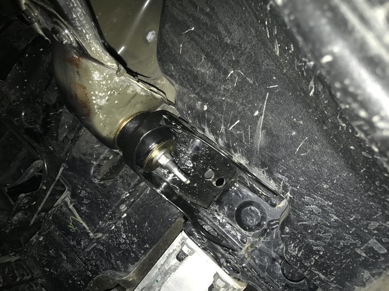

    I replaced my bushings last night. Drivers side was a huge pain in the ass. The bolts came out fine when taking it apart but putting it back together was a nightmare and it took me forever to get the bolt through everything. I think the core support has shifted towards the front of the truck making bolt have to go in angled so its not totally straight. The passanger side bolt was straight and came off and went back together smoothly, but after driving it around and rechecking it is not even more angled than the drivers side. Not sure if something shifted or what. Arg. Im going to take it apart again to see if i can somehow straighten it back up. Any tips? Do i just try to use a pry bar on the core support somehow to get it all straight like it was when i put it back together. And, is it just going to shift around again after driving? Not sure if its ok to be angled like it is or how to prevent it from becoming angled in the future. This fix did fix most of all of noises i was hearing and for some reason the truck now seems to be driving much better and smoother.
    Driver side
    Passenger

    How was the alignment on that bolt originally when it still had the factory bushing in it, was it angled like that or did something shift when you had it apart.
  12. Apr 26, 2017 at 2:53 PM
    #52
    peppinoss
    peppinoss Well-Known Member
    Sep 3, 2015
    #163380
    565
    Los Angeles
    2016 TRD OR 4x4
    ToyTec Boss 2.0 lift TRD Pro Wheels 265/70/R17 KO2s Mobtown Offroad Sliders
    driver side was angled, passenger side was straight before the install. When i put it back together passenger side looked straight. I think it shifted after driving it maybe 20 miles or so and going over a few speedbumps.

    drivers side was slightly angled before and after the swap, passenger side was straight before swap, straight after swap, angled after driving and rechecking

    Got back in there and got it straightened out. As soon as i loosened the nut a little everything went straight. Maybe it was just too tight? I torqued to 34. I also test drove it for a bit afterwards and it looks like it has not moved so thats good. I'll check on it in a couple days and see if it stays put.
