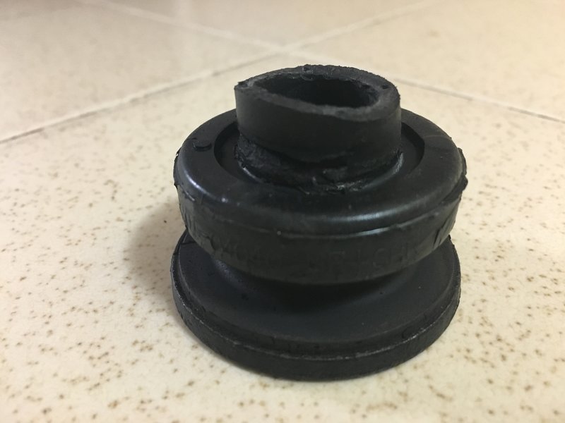

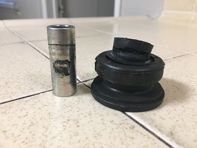

    My 17 with 800 miles. The first pic is the passenger side and it was rubbing a groove in the metal sleeve. Second pic is driver side was almost there. After looking at these I believe there is an assembly line issue that's causing somehow the body to slide forward and pinch that rubber on assembly because it's not rubbing through the rubber, it's pinched through it and then it rubs. Took a little mirror and looked up in the mount and I'm fairly certain that if you just reassemble with new stock mount it would probably be ok. Having said that I'm gonna try to not go with the energy suspension urethane and make a little bushing/sleeve using my stock mounts. I'll keep everyone posted take a few pics when I'm ready

    I'm not a huge fan of polyurethane body mount bushings, they have issues being so hard they transmit more noise and they can also squeak in time. However I may end up going that route but at this time I want to try something else , I really believe it's an assembly issue.

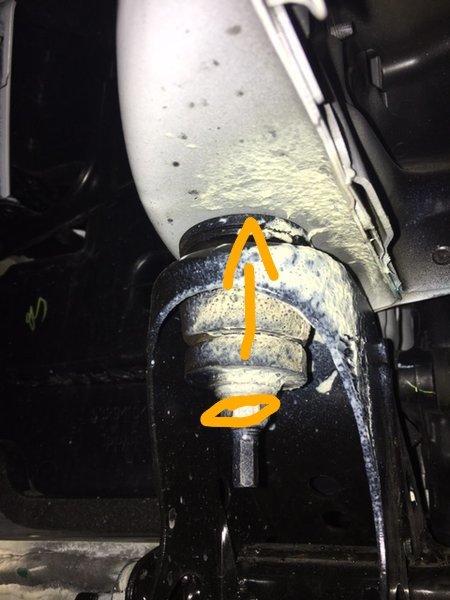

    @Victory can you tell me if the bolt comes up from the top when removing? I have an ARB bumper so it's super easy to get to the bushing however the bumper mount is in the way. I was working on my TC UCAs thinking they were to blame for the squeak when I noticed the squeak was actually coming from somewhere else. I got out my mechanic's stethoscope and was able to clearly hear the squeak from the bushing. After visually examining the bushing, it's clearly failing. I used your photo to draw where I am thinking of using a wrench to hold onto the nut and then use either another wrench or a socket to actually loosen the bolt from the top and pull it out the top. Is that similar to the way you did it?

    Took your advice on the wrench and it worked like a charm. Driver's side was a royal PITA for sure and I'm wondering if I'm going to have to do this again a year down the road because of the misalignment of the frame and body.

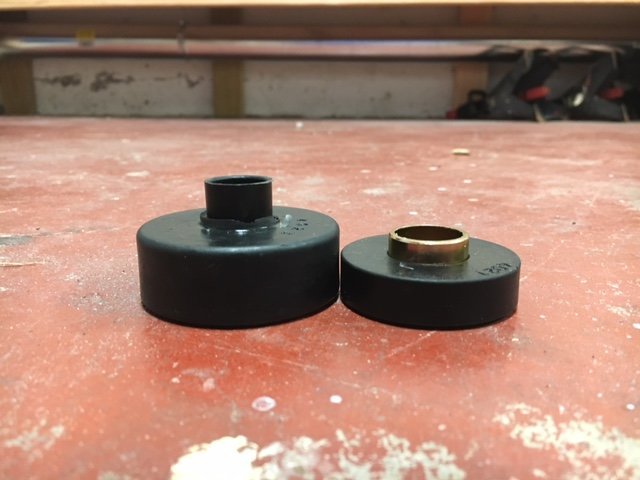

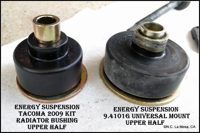

    This is probably a silly question to ask, but i ordered the energy suspension 9.4101g suggested in these forums and it seems like my top upper half is different than the ones OP posted.
    OP posted the picture above. His upper half shows a mount that doesn’t have any metal on it.
    The mount on the right in the picture above is the mount that i got in my 9.4101 kit.
    My question is do I install the ones i got the same way OP and everyone else installed theirs? Top mount is mounted with the metal thing going through the hole in the body frame?
